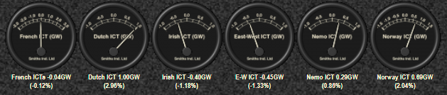

Exactly, and importing extra from the countries around us to help with the energy shortfall.
Not much, though. This (current) is reasonably typical, although it's more normal for us to be importing 1%-2% of our demand from France, rather than exporting to France, which we are currently doing ...

From the meter displays it's evident that the 'constant' is the nuclear supply at 5GW. The data table suggests a nominal system demand (supply) of >20GW. It would therefore make sense if the system supply base demand was met by an increase in capacity of the nuclear system to somewhere around 15GW.
I should perhaps have added that I have to assume that there is some 'commercial' and/or 'political' (rather than sensible/common-sense) reason why we are nearly always importing at least some electricity from France, Holland, Norway, Belgium etc. (particularly France) even at times of relatively low UK demand.
Possibly, but I don't know the reason, unless it might be cheaper to import than generate at home.
As I said, I presume it must be commercial/political/whatever - because we know, from our current ability to service high demand periods (with little import) that we could, if we wished, service lower demand periods without the need for any import.
Edit: "cheaper to import than generate at home" would, of course, be a 'commercial' reason for importing. Does anyone know what is the (electrical) 'efficiency' of the international movement of electricity (i.e. how much is 'lost', in heating the English Channel or inverters/transformers etc.)?.

  • Most imported energy over the interconnector is French nuclear so low carbon.
Are you saying that that is the reason why we import French electricity even when we have the capacity (hence always take as much electricity from France as thjey are able to provide)? Do you know the answer to the question I recently posed about the efficiency (or otherwise!) of these international transfers of electricity?
That's a "disingenuous" description of the sort usually used by various factions of the green lobby.
Just like over here if taken in isolation, if we import power from France, then that nuclear generated power can't be supplying someone else. So somewhere on the continent there will be another power station opening the taps. That could well be in somewhere like Poland where I believe they still burn a lot of coal. The ONLY time that's not the case, and the power can truly be described as low or zero carbon, is when there is no fossil fuel plant running anywhere on the connected grid and renewables or nuclear would be getting an instruction to reduce output. The European grid is a loooooooong way from that, so it's disingenuous at best to be saying that we import "French nuclear" and it's low/zero CO2.
