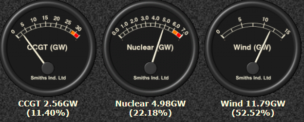

We recently had a discussion about the sources of UK electricity, mainly in relation to gas, and I suggested that (I meant during 'high demand' times of day), gas currently often accounts for around a half, or more, of the electricity being generated.
Turning to the lowest demand period of the day, and accepting that there is probably appreciably above-average wind today, I was quite impressed to see this recently (about 3.30 am) ...
Kind Regards, John

whilst it looks very impressive we need to know how much lower the demand is because off companies shutting down or supressing demand because high energy costs ??
I'm not sure whether you are talking about changes in demand over recent years or the last few weeks. As flameport has shown the long-term downward trend has been pretty modest. From flameport's figures, the average daily demand (for 26th October) for the three years 2009-2011 was 28.7 GW and for years 2019-2021 was 24.7 GW - a reduction of about 14% over 10 years, equating to a de-compounded reduction of just over 1% per year. I cannot tell you what has happened in recent weeks.
Anyway, apart from the matter of total demand, I remain impressed by the proportion of electricity that we are managing to generate from wind on a fairly windy day. The figures I posted last night (with 52.5% coming from wind) related to a time when total demand was about 22.5 GW. A few minutes ago (i.e. a bit after 1pm) the total demand was, at 33.5 GW about 50% higher than that, but the proportion of electricity being generated from wind was still about 25% greater than the proportion being generated from gas. It's obviously often not as windy as it is today, but I'm nevertheless fairly impressed.
Kind Regards, John
Little gas generation being needed because it was unseasonably warm outside. What do we do when the weather is cold and the wind is not blowing?
I'm not sure that 'unseasonably' is very relevant - it is at least as warm outside for a very appreciable proportion of every year as it is today. It goes without saying that demand will rise when weather is very cold, and that will always e an (unpredictable) problem.
However, as I've acknowledged, generation from wind requires appreciable amounts of wind, and that won't always be the case - but I'm still impressed by the figures I'm seeing when winds are not exceptionally high.
Kind Regards, John
