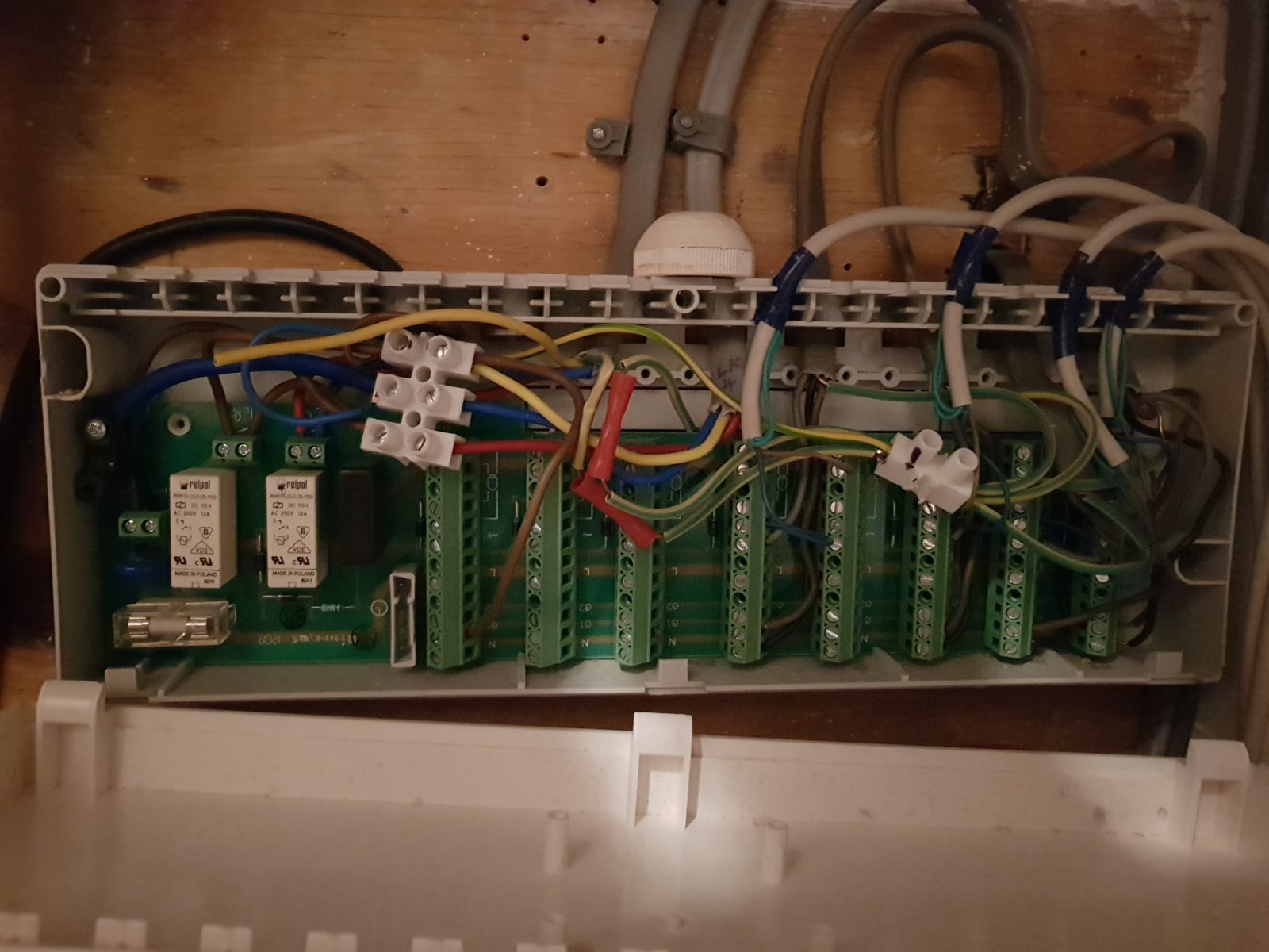

The meachancal side is fairly under control (!) now nut the control side - electrically, is still having some issues.
Heating is UFH throughout property, on both floors.
There are two manifolds, one on ground floor, one on first floor.
Two wiring centers, and one controller.

wiring centre image:
4 white wires are actuators, two go to one block as they are driven from one stat in living room.
black cable is pump.
three grey cables furthest right are stats as far as I can tell.
Nothing seems loose or no signs of blown components, at least on this side....

I think you're going to have to do a bit of detective work here, and work out how it's actually wired.
From the photo, I can't see how the right hand grey cable is wired, but the third from right looks about right. The second from right is not right for a room stat - one core is linked through to the 4th from right grey cable.
On the upside, I think the "electronics" are exceedingly simple - my guess is that those diodes (the small black cylinders with silver end band located next to each zone connection) simply "adds" the zones together to drive the relays. I suspect that on the back of the board, all there would be to see are some tracks running up-down to link the switched live from each stat to the corresponding actuator output terminals.
If you can manage to work out how it's wired, then the fault is likely to be obvious.
Now I've had another look, the pump live has a connection to the yellow of the left hand grey cable. I don't think this should be needed if this is the only wiring centre for the zones run from this pump. From reading your description, this is the downstairs wiring centre - downstairs zones and a separate pump from the upstairs zones ? If that is the case, and assuming it's connected to the pump circuit in the other wiring centre, then this connection should not be there - it's basically meaning that if ANY zone is one then both pumps will run.
So one quick test would be to disconnect that yellow wire from the chock block (get hold of some more chock block and park the yellow cable in that). I suspect that this might fix the "upstairs-downstairs" linkage problem.
Critiquing those wiring centres, the design has (IMO) a number of significant design faults - or in the vernacular, they're cr*p !
The first is that there just isn't enough room to run the wires about. I guess that's in response to customers saying "I don't want big ugly boxes all over" - so they make them smaller and the installers just have to cope.
Then there's no provision for connecting the earths. That IMO is unforgivable - there really ought to be at least 2 earths per zone terminal strip plus others at the relay end.
Then niggles like having a pair of terminals for the pump - but no spare connections for the live feed to one of them, and no spare neutral for the pump. Hence the installer having to use chock block to make some of the connections.
All in all, it really needs a separate junction box to provide all the connections missing from the wiring centre :whistle:

Simon,
Thanks for taking the time to try and assist. I follow you logic on the pump wire, and I think this is a good line of enquiry, I will certainly try and do this.
With regard to the first and second wires from the right, they are the wires going to the actuators - so where two wires are in one connection, is where one room stat is driving two circuits - the lounge uses one circuit, plus half the circuit which covers the hallway. I think, now I look at the wiring diagram again, they should have used connections 1 and 4 for one actuator and connections 2 and 3 for the additional actuator, when driving two from one room stat...
I would agree, there simply isn't enough room in these boxes to make it EASY to make it neat, the main wiring, being stiff single conductor, doesnt lend itself to neat routing, if you cant spread it out and have the room to manipulate it.
It does need a few extra neutral and terminals to make it a whole lot neater!

I have attached below the wiring center from upstairs in case this helps.
In my previous message, I was only counting the grey wires (the flat twin+earth and 3core+earth ones).
Now we can see the other wiring centre, it gets even more "interesting" :eek:
It looks very much like that link cable powers the upstairs system - so upstairs is only powered on when downstairs is running o_O And it's held on (hard to see, but it looks like the upstairs pump relay also powers it) as long as any upstairs zone is on - hence why the downstairs pump is running when it doesn't need to.
So, nothing on downstairs - nothing works upstairs.
Downstairs on - pumps run, upstairs zones work normally.
Any upstairs zone on - pumps won't turn off, hence why you're hearing the downstairs pump running when you wouldn't expect it to.
Given the generally "untidy" installation and wiring faults, I'd be just pulling them out and redoing them - hopefully there's some spare length in the cables and/or the boxes can be moved a bit to make some spare. And as Flameport says, put them the right way up !
The correct way to wire it would be :
  • Power to power terminals of the downstairs WC (wiring centre, not toilet :whistle:), using that link cable (red & blue cores) to take it to upstairs WC.
  • Use a spare zone connection for the programmer/timer. Take it's supply from the L&N terminals, and it's output to the "timer 1" terminal. Connect the yellow core of the link cable to a timer 1 terminal to take this signal upstairs.
  • Boiler connections as they are (I think) - use two cores of the cables across the boiler control relay of each WC, so the relays are simply in parallel.
  • Connect each pump only to it's own WC - live supply to one terminal of pump relay, other terminal to brown wire of pump, blue wire of pump to neutral.
  • Connect each room stat to "timer 1" (L), N, and the "arrow" symbol for the switched live from the stat. Electrically I think you'll find that this is commoned to the next two terminals down (actuator connections), and the bottom two are commoned to neutral (so a source of spare neutral connections :sneaky:
The timer 2 terminals won't be used in your setup, but it's just there as a second switched live so you could (for example) have some zones on one timer and others on another - so where upstairs and downstairs are on one wiring centre, upstairs could have a different schedule using a two channel timer.

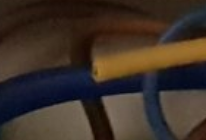

I need to go back and take a photo from another angle - as when i looked at my photo again - it look like one of the yellow wires is not connected - is it possible they connected the wrong wires to the wrong locations and left some disconnected by accident?
Given the general f-ups and poor workmanship in that installation - who knows what they could have done wrong :rolleyes:
Yes, that is the wire end i thought looked disconnected!
