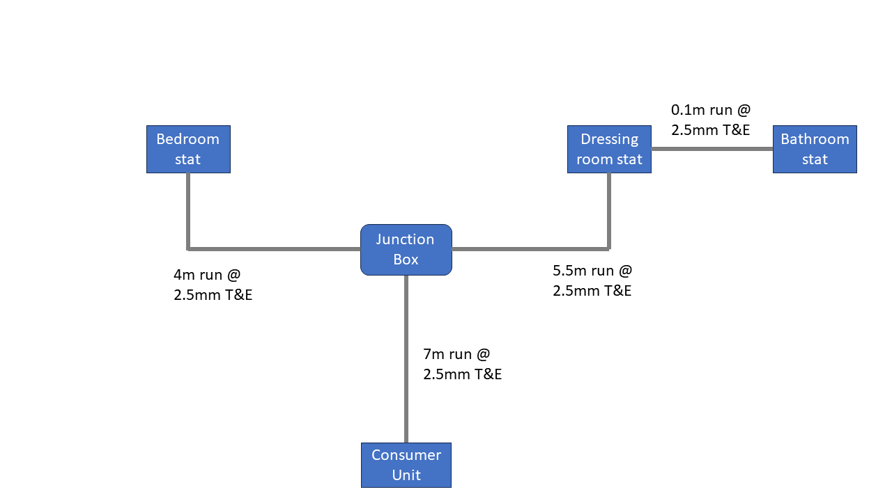

Hi everyone, we're thinking of getting some works done in our loft and have a chance to get underfloor heating installed. I have been reading around on this forum and the web and would like some advice before deciding on next steps.
We want to get 3 x underfloor heating mats (UFH) across 3 different areas on the same floor: bedroom, dressing room, and bathroom.
There used to be a jaccuzzi bathtub in the loft which had a dedicated MCB in the consumer unit (CU) and was fed by a 2.5mm cable. Could this be repurposed to power all 3 UFH in a radial-type circuit (from consumer unit to an accessible junction box and then split to each UFH from there)? Would the power draw from each in isolation and all together be sufficient for this circuit type and cabling?
Would this configuration require DP switches for each UFH?
The path to the Consumer unit would be open so we would have a chance to upgrade anything there and inbetween. There is a spare slot in the CU, but I am earmarking that for an additional RCD that would support the loft. However, if the advice is to upgrade and make use of the spare slot in the CU, then we can think about changing the loft MCBs to RCBOs.
Pretty sure I've missed important information, so please let me know if there's any additional information required.

Hi John,
Thank you for the helpful reply. Thanks for the reminder about the RCD size. The space I have is actually 2 slots rather than 1, but hopefully I can still keep that free for a RCD based on your reply.
Apologies that I didn't mention the power requirements of the UFH. If it helps, I've listed these below along with an attachment which resembles the routing and approximate lengths of the cabling:
Bedroom: 3080W
Dressing room: 490W
Bathroom: 1000W
Would you also be able to advise if each stat should have a dedicated DP isolator switch?

Apologies that I didn't mention the power requirements of the UFH. If it helps, I've listed these below along with an attachment which resembles the routing and approximate lengths of the cabling: .... Bedroom: 3080W ... Dressing room: 490W ... Bathroom: 1000W
Well, that total (4,590 W) is just about within the capabilities of a 20A circuit (and well within the capabilities of a 25A one), which could probably be fed with 2.5mm² cable.
Not 'required' by anything, as far as I am aware, but would make very good sense, in case a fault were to develop in one of mats.
More generally,I do agree with those who are questioning the wisdom (both in terms of effectiveness and running cost) of trying to heat a loft (or anything, come to that!) with UFH. How is the rest of the house heated?
Kind Regards, John
