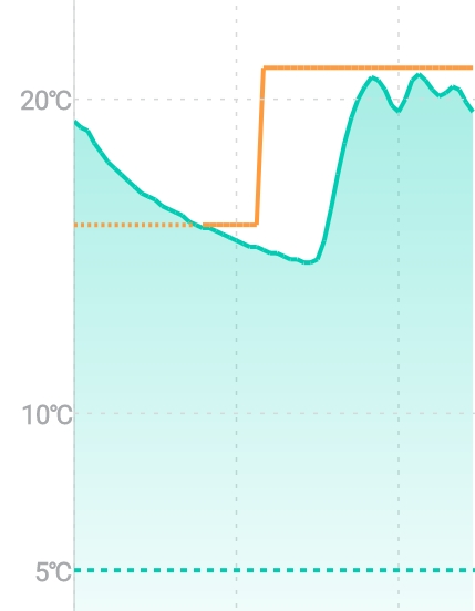

I am lucky, one of my TRV heads actually shows a report 1707836553495.png this is today, it shows how the temperature dropped from midnight until heating turned on, and then how it recovered, the hysteresis is because I use oil for heating so boiler does not modulate, however you can see the cooling curve well, and how important it is to running costs to turn off heating when room not used, and also how important recovery time is.
If you have to turn on the heating earlier to get the room heated in time, it will cost more, ideal is likely fan assisted radiators, but noise of fan, and cost mean in the main we use radiators with TRV controls.
IIf you have to turn on the heating earlier to get the room heated in time, it will cost more, ideal is likely fan assisted radiators, but noise of fan, and cost mean in the main we use radiators with TRV controls.
In thee real world,that will inevitably be true to some extent, but the extent does depend upon how well'insulated;' the room(and house) is.
If the room were 'perfectly insulated' (no heat loss to anywhere else), then the Laws of Physics dictate that it would take the same amount of energy to increase the temperature of the room by a given amount no matter how long it took to achieve that.
Kind Regards, John
