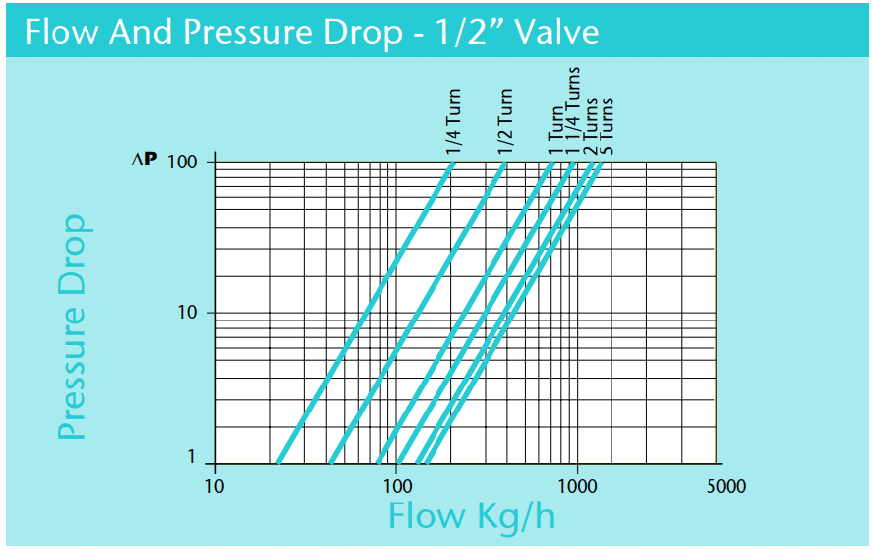

I'm hoping someone can help me get my head around understanding radiator valve pressure drop. As an example, from the attached chart, a lower pressure drop results in a lower achievable flow rate.
To my mind, a lower pressure drop (i.e. less resistance to flow) should give a higher flow rate, and vice versa.
I'm undoubtedly thinking of it wrong - any help appreciated!

Flow is proportional to the sqroot of dP. You can also assume litres = kgs, if you assume a flowrate of 1.0LPM, 60LPH per kW rad output then from the graph you can see that the dP through a lockshield valve, 1/4T open is ~ 1mbar? at 20LPH but ~ 9mbar at 60LPH. The converse is also true, dP is proportional to the sq of the square of flow. For example a pump head of say 3.0M would generally be sufficient to serve 8/10 rads but if you wanted to double the flow through them then a 9.0M pump would be required but most pumps are 6M so the flowrate could only be increased by a factor of sqlroot 2.0= 1.414?.

So why are you worrying about the lockshield valve pressure drop? Assuming the ΔPs are in mbar (seems reasonable) at 5 turns, (effectively fully open) it's only 10 mbar, 100 mm water, at about 450 lph.
To get back to the original question - that would be true for a fixed pressure drop, but varying the orifice area, ie valve opening. The graph shows flow vs pressure drop for a range of fixed valve openings.
