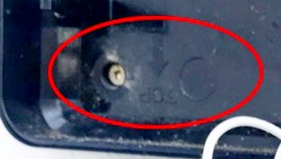

Yes will do but will have to. E later today when I get home. I spotted that its upside down but assume it was to allow the sensor some light and away from a close wall?
BAS,
You have good eyesight (or a better monitor than mine). I kept thinking your issue was with the bolts, not the arrow and "TOP" marker. :>
Maybe secure too?
I must come clean and say that although the lettering is visible in the photo as posted, and you can see it if you look for it, I didn't notice it until I enlarged the photo to look at the cables.

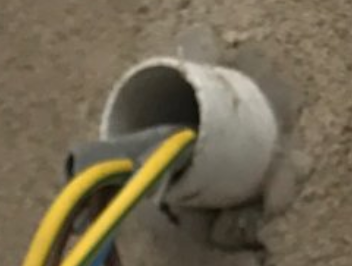

BTW - does anybody else think this looks like waste pipe rather than conduit?
TBF, some enclosures have "TOP" moulded into them, but it appears on opposite sides of the enclosure (in other words, it can be mounted either way up).
Indeed. However, as you will have seen the OP has another theory ....
.... I spotted that its upside down but assume it was to allow the sensor some light and away from a close wall?

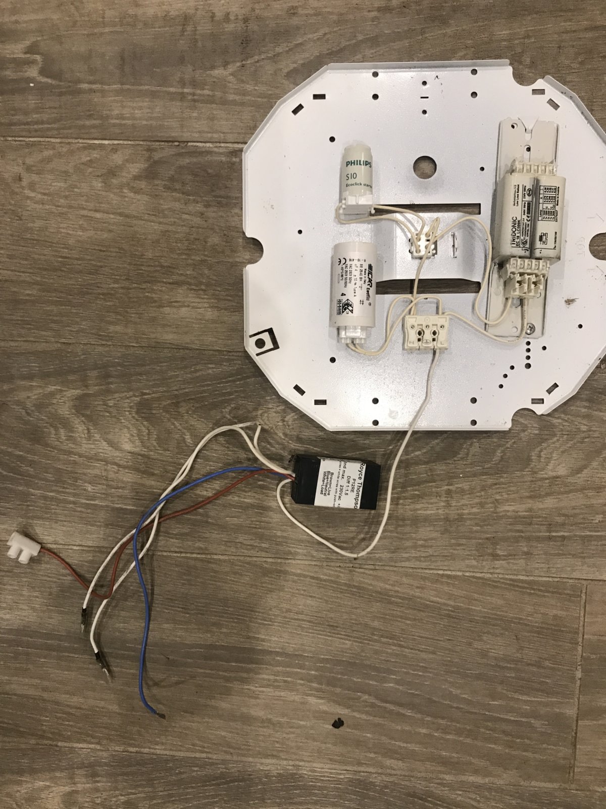

Here is another photo of the original light guys..
I think something is still amiss with the wiring as others have said. Can you take a picture of the label on the black box in the old light? The original wiring doesn't suggest the two brown cores should be connected together.
Not sure how that is relevant. It would be, were the problem reconnecting the old light after removing it for painting the wall, for example, but it's not.
The new light has a PIR, and two connections, L & N. So that would have to be permanent L & N, and it's obvious where they go. Whether or not the two browns should be connected together is of relevance to the house wiring, but not to the operation of the light - it's a simple beast, all it wants is permanent L & N, and it doesn't care what colour, or how many, wires provide those.
Were the problem the light not coming on, then a fault in the wiring of it could be suspected, but it's not. If the light is on all the time it surely can only be a faulty PIR.
Because there is now either another light which is on permanently, or a switch being backfed (which in itself is not an issue - but may as well set it up properly so he can override the PIR)
