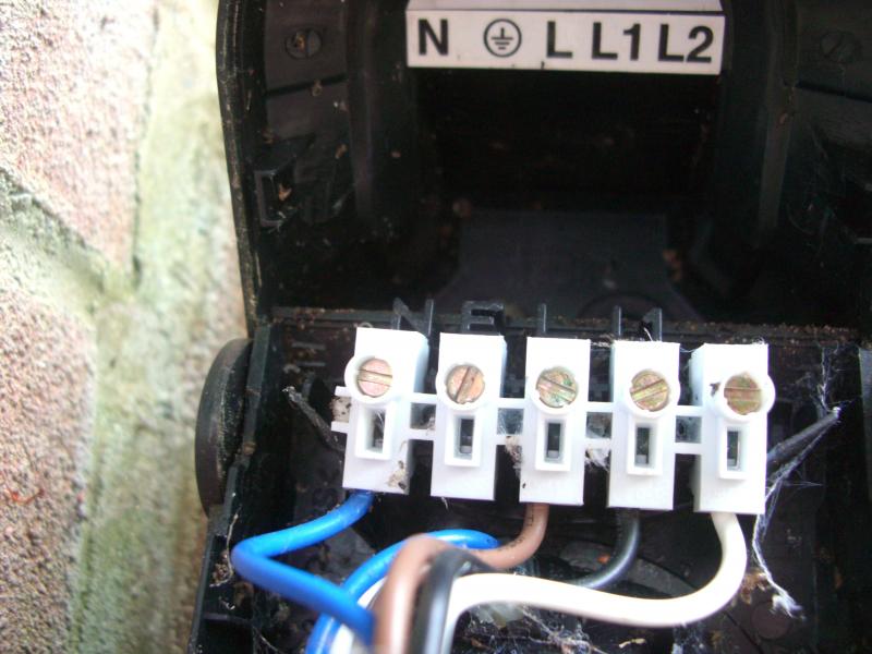

    Hi everyone
    We had an uninvited guest whilst the family were asleep, I was confronted with a big guy and a knife but we are all ok.
    I am having some security bits and pieces fitted and have a question about our existing lighting on the driveway which are operated by a switch in the house. I would like to add a pir so once we go to bed at night the pir takes over and should someone walk on the driveway the lights come on again. We tend to leave the driveway lights on until the last one goes to bed anyway.
    When they were originally fitted some 15 years ago a pir was fitted near to the last light but never connected.
    From what I can see there is a junction box next to the standalone pir and the connections for the switch and lights are in there. It has a live feed in, the cable for the switch goes to there and then there is a feed to the lights. Can someone help and tell me how to wire the pir in please, it has a number of connection inside marked N.E.L. L1. L2.
    Sorry if it sounds confusing, I am not "gifted" in the electrical dept.
    Blue eyez

    a photo of the connections inside the light and inside the PIR would help us out.. we're flying blind otherwise..

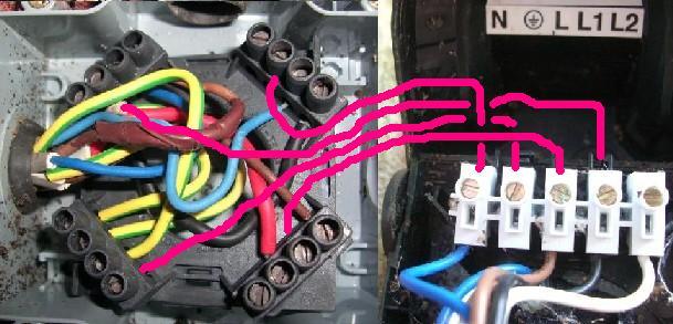

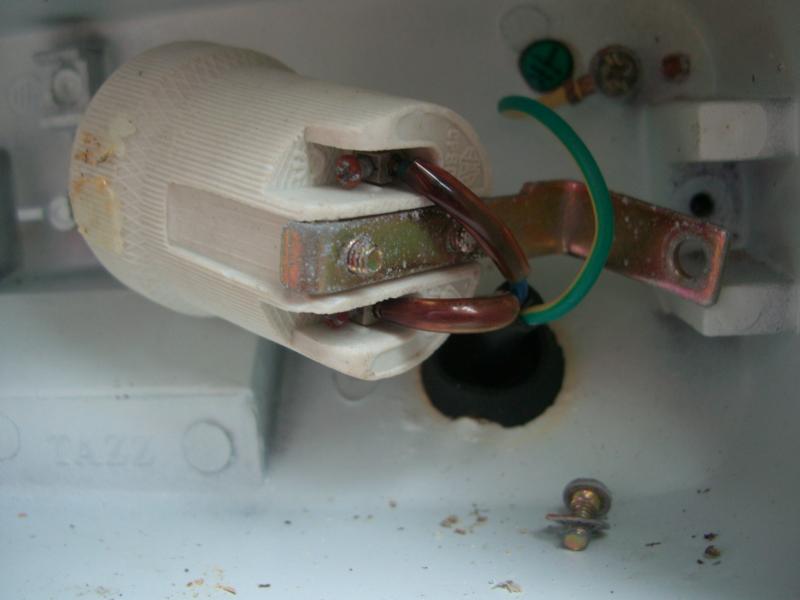

    Thanks ColJack
    Here they are.
    Inside the PIR
    Behind the lamp
    Inside the junction box. On the lamp the top wire is Blue

    On the PIR there are two live outs. I am not sure why? Either different timing or one is perment dawn/dusk. What make and model is it?
    Try as I have wired it, and then try swapping L1 and L2 if it doesn't work as expected.

    It has a label on the top which says.
    IQ group
    TYP NO TNSA140D
    3396 G4
    230V~50Hz
    L1 MAX 1000W
    L2 MAX 120W
    IP44
    Can you just confirm that the wire in L1 is going into the choc block in the top left corner?
    Thank you Lectrician, I will do it now.

    Yes. That looks to be the switched live return from the switch to me.
    I can't find any info on that PIR, I expect it is manufactured to be re-badged for a company.
    Going by the power rating, I would say L1 is the switched live output for the PIR. Not sure what the L2 output is.

    Your a star, all works brilliantly, thank you to everyone.
