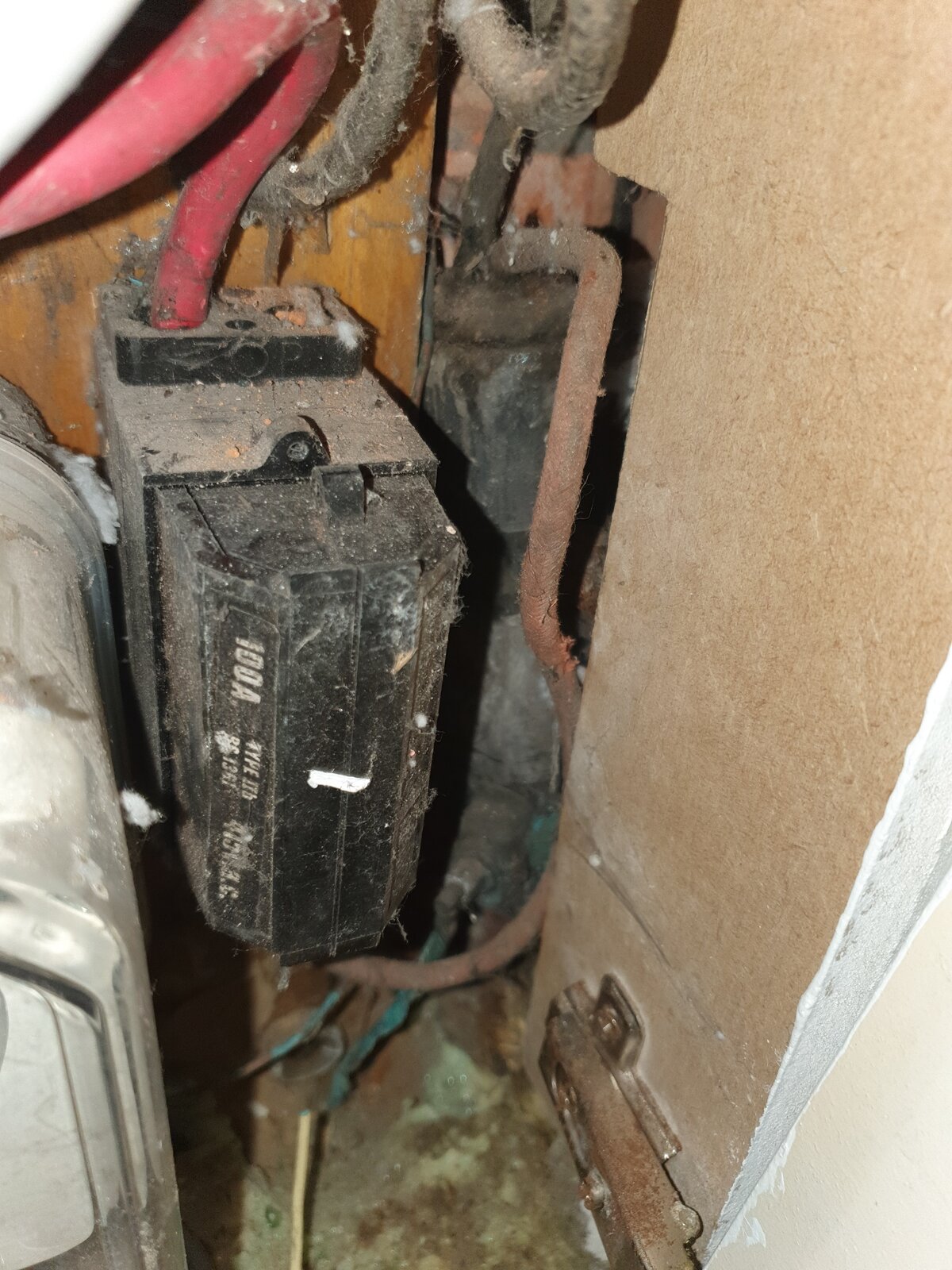

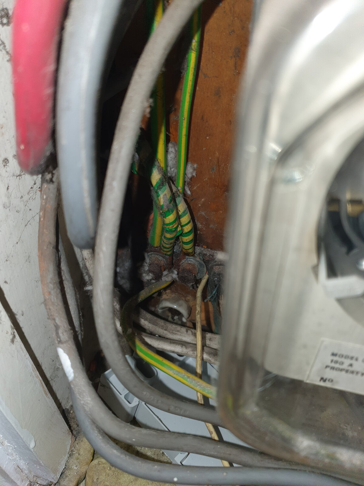

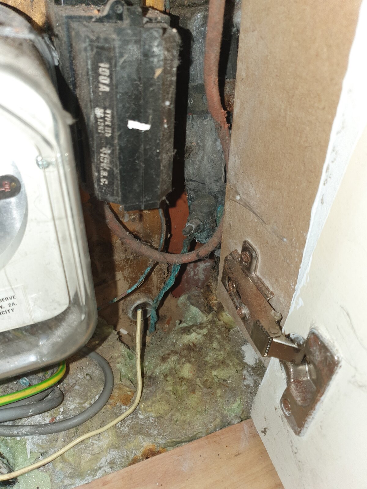

Our house was built in the 1930s. The supply cable coming in has the earth bolted on. It's just strands of metal coming off a bolt. I was planning on bolting a 16mm earth onto this and running it onto a new 8 way earth bar. The cable going to the cutout is cloth which looks like it has very slight insulation damage. Am I better off taping the cloth up and adding the 16mm earth or leaving it. I will add pictures when I get home. The few strands of metal as an earth scares me at times. Or would you leave it alone and report a corroded looking earth cable to the dno?

That mess requires urgent attention and replacement. Call 105 to arrange. Do not do anything to it yourself.
Will the dno actually take me seriously tho? Shall I say my earthing has corrosion to it?
The call handler will likely take you seriously and at least send someone to look at it. what happens then depends on the engineer you get.
I called my DNO a couple of years back to report a similarly poor earth and a damaged porcelain insulator on the top of my original 1930s cast iron rewirable fused cutout. I was expecting/hoping for a new cutout. I got a new earth braid and clip, and he flipped the damaged insulator 180 so the damage faced inside the cutout. I asked him what I was supposed to put on my EIC for supply fuse type and rating, he said "other - 45A"

Hopefully they will upgrade some of that DNO equipment, cloth covered tails look a bit ancient - though no doubt someone will say they are better than the new ones.
