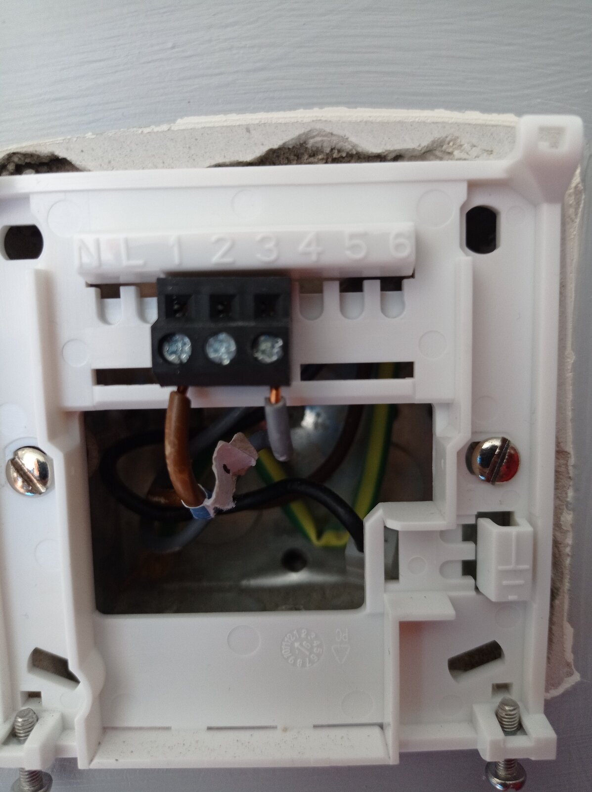

Hi there, I'm upgrading my thermostat from salus rt310 to rt310rf, and want to make sure my wiring is correct. The Thermostat is connected to a 3 channel programmer.
Inside the rt310 are 2 wires brown (live connected to COM), and a grey connected to NO. There is also an unconnected black wire inside - I wonder what that is for?

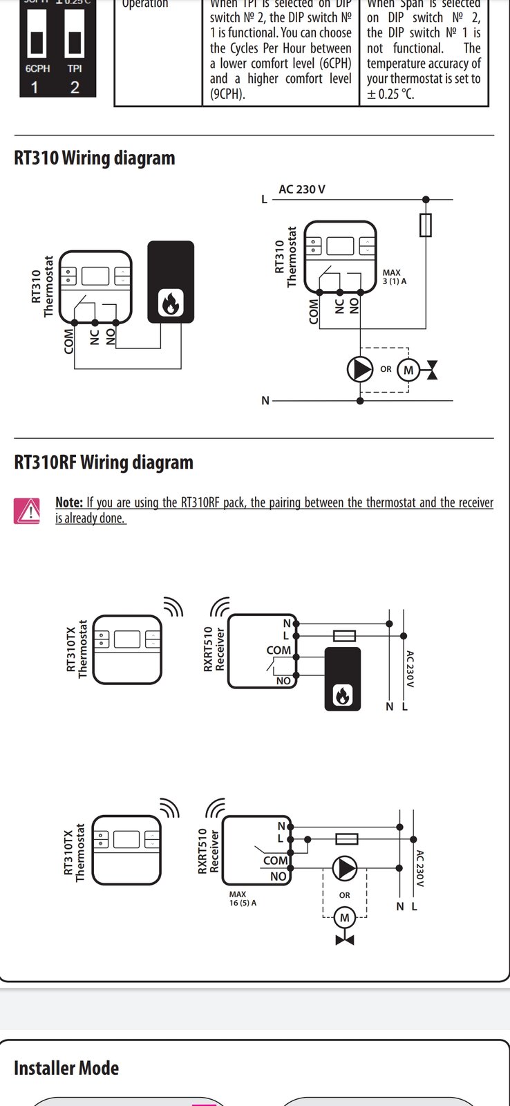

Could someone have a look at schematic and confirm the correct wiring I need to follow.
I think in the receiver I connect brown to L and COM, the grey to NO, would the black wire go to N?
