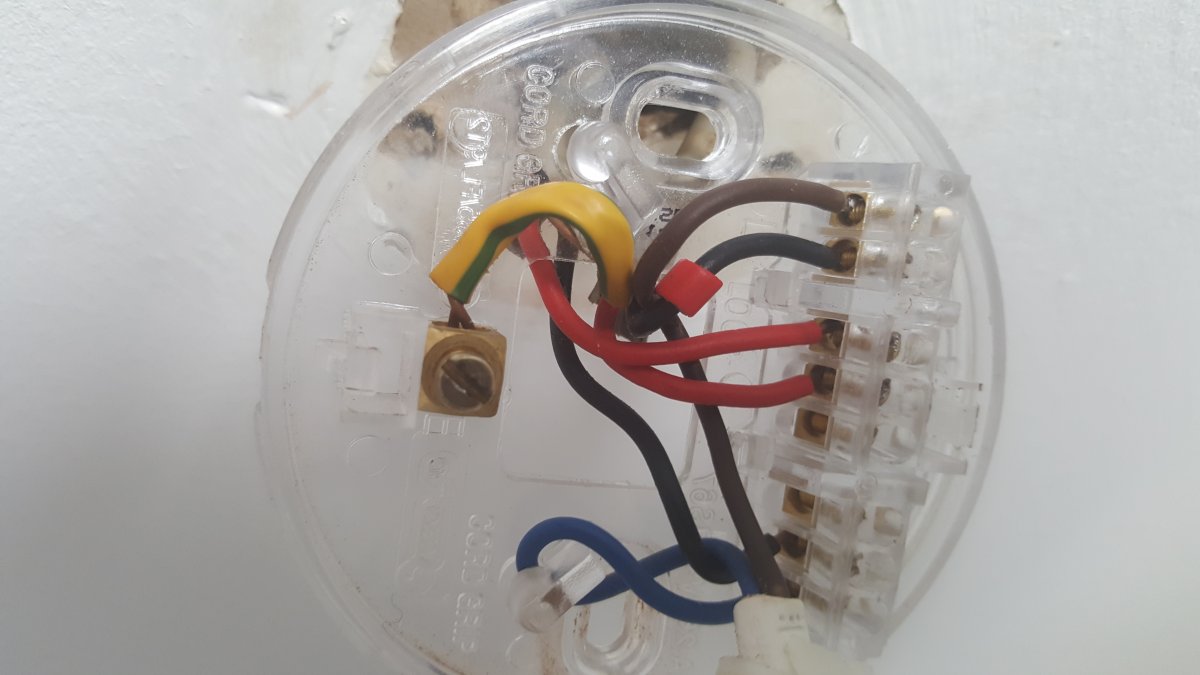

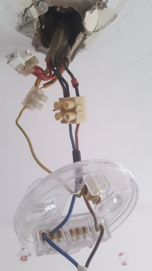

UPDATE - Ok after replacing the rose with choc blocks inside the hallway seem i have messed something up. The bedroom (bedroom3) i originally posted about now works
Well, that's something. The fault seems to have been something to do with the hallway wiring.
but when switch on turns the light on in bedroom1 (dim). This process also vice versa.
Switch on which switch? Sounds like you have wired something in series. Not sure what
means.:(
The Bathroom is working normally but hall doesn't come on unless bedroom is on.
Did you change the ceiling wiring in Bed 3?
Just to confirm I have not changed anything on bedroom 1 or bedroom 2, bedroom 3 is the room that this post is all about and the bathroom and hallway are what I put choc blocks in rather than the rose being inside the decorative fitting.
Luckily I pictured all of them (posted on here). I presumed all fitting in the centre terminals on a ceiling rose can all be put in the same choc, is this not the case?
Yes. The incoming (and outgoing line loop if present) go in the centre terminal of a rose, along with the line to the switch. If replacing a rose with terminal blocks, these all go together in one block.
The switched line from the switch goes to the other side of the lamp holder.
The neutral(s) go together in another block, along with the neutral(s) to the lamp holder(s).
The earths all go together in another block, along with the earth to the fitting.
If I was right thinking that then I may just have got something mixed up. I'll double check it tomorrow but all before and after pics are on this post if somebody can spot something. Wow thought I'd done well tidying up those connections: maybe not o_O
;) Did you mark any of the cables so you know which wire in the new arrangement went to which terminal in the old set-up?
I didnt mark them just took pictures but looking at 'halllway' and 'hallway fix' and 'bathroom' 'bathroom fix' from what I can see it is wired up as was before just in choc blocks rather than ceiling rose, would you agree?

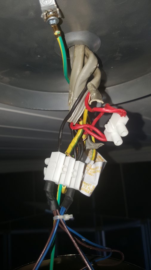

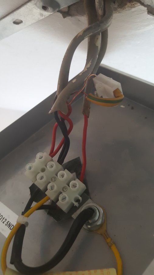

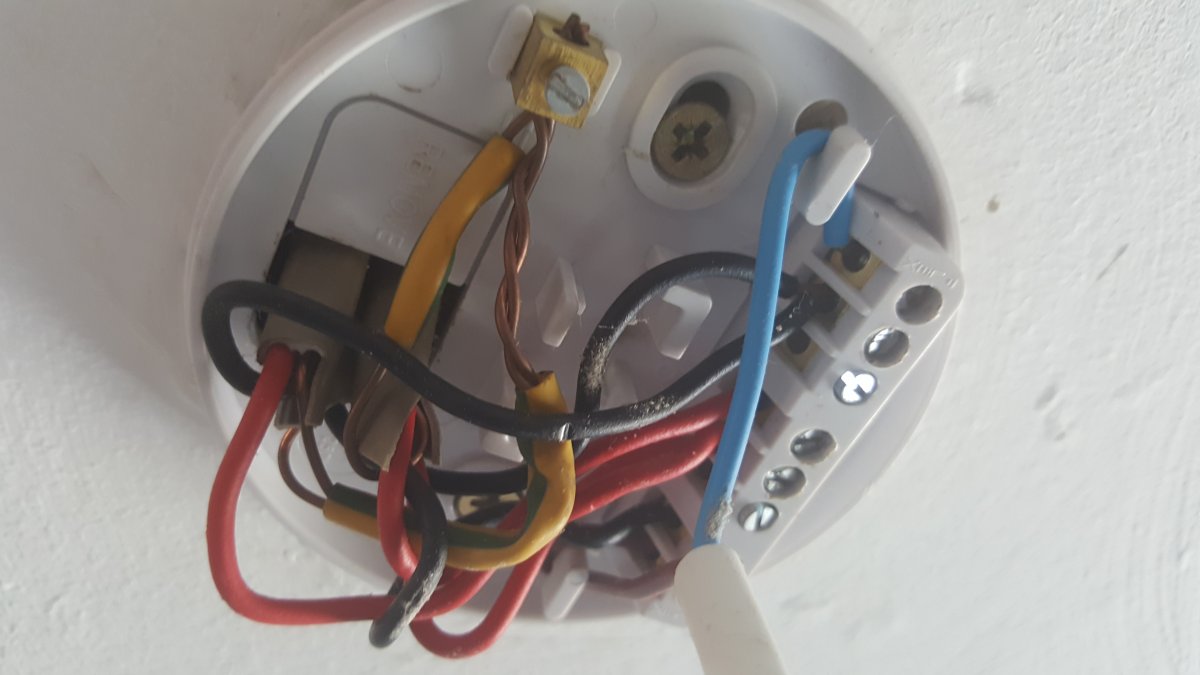

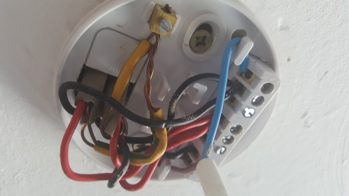

Heres the video, last 2 rooms are the problem. Small gym room is original fault.
OK, thanks. Can you take some good clear close-ups of all the cable joints at the ceiling positions so we can compare them with your previously posted pictures before you altered things?
Is the gym room the one with only 2 cables at the ceiling?
Yes gym room last room with white lamp shade you can see weight bench in video. Before I tidied up cable with choc block in decorative light fittings (bathroom & hallway) the gym room light didn't come on at all.

The last 3 digits of the jpg file numbers of the post pictures...
Can you write the room name against each?
728:
504:
420:
634:
451:
So we can compare with you previously posted "pre" pictures?
728:
504:
420:
634:
451:
Sure..
728 bathroom
504 bedroom2
420 hallway
634 bedroom3
451 bedroom1
