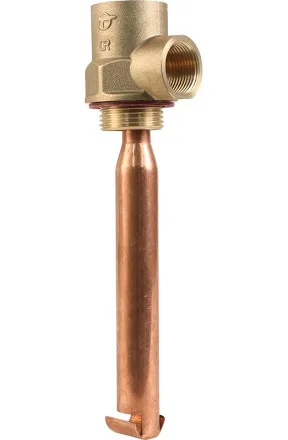

Not good practice to install the pump you have anywhere but next to cylinder feed via a flange.
Putting it under bath good chance of air ingress and constant cavitation.

Done properly, the shower will have a dedicated feed for cold from the CWST, and the hot from the cylinder
I am currently away but will confirm this soon. So are you saying that my hot water cylinder should have 2 pipes coming out of it? One 15mm for the shower and one 22mm for the rest of the house?
Yes.
It can be an Essex flange on the side of the cylinder or a Surrey or Sussex ( TBH, I have always called this is Sussex flange, but searching for an image brings up Surrey - I confess that I do not know the difference, but no doubt someone wil elucidate) flange which replaces the normal outlet at the top of the cylinder
Yes.
Never known it to be called Sussex flange - and I live there. Been in the trade nearly 40 years and always heard it called Surrey flange.
