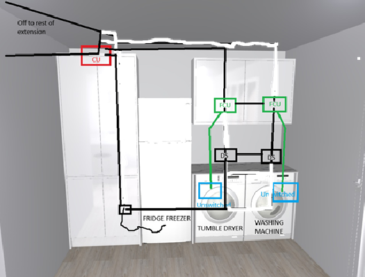

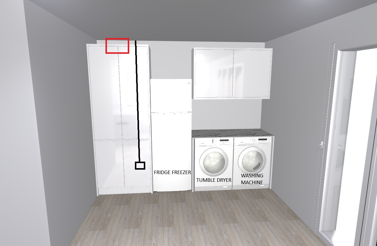

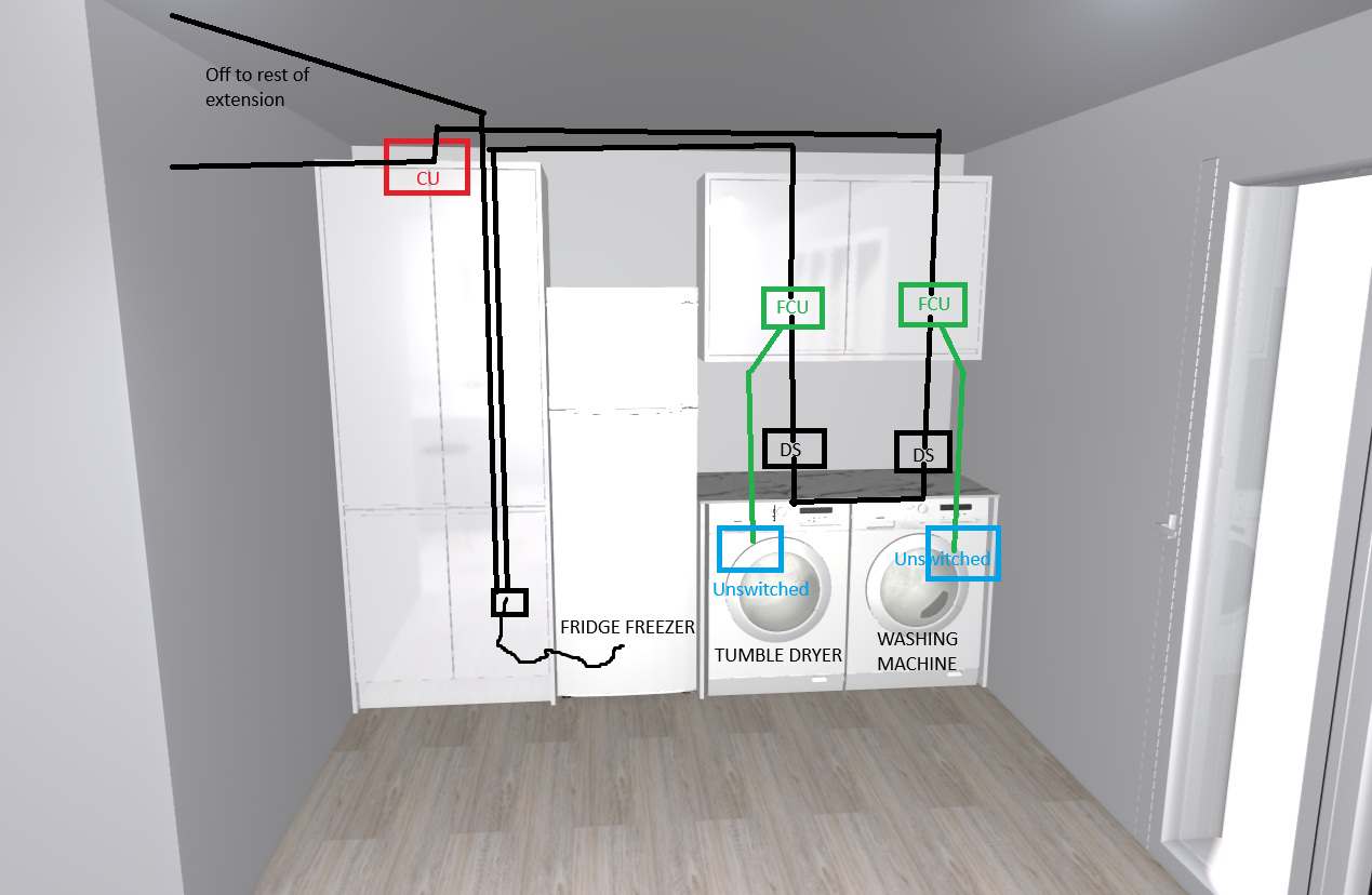

The vast majority of domestic premises are occupied for much more time than they are unoccupied, so I would personally very much favour coming down on the side of maximising 'protection' when the house was occupied (by NOT having a freezer on a 'dedicated' circuit). Not only is that, statistically, much more likely to avoid loss of freezer contents than would an approach which might be preferable when the premises are unoccupied, but the chances of anything 'tripping' say the circuit supplying a TV whilst the occupants were on holiday would presumably be extremely low?
As I have said before, I favour a dedicated circuit for fridge/freezers, but a none RCD/RCBO one, so the risk of loss of power is absolutely minimised, but maximise the chances of knowing there has been a power loss, by adding a temperature alarm, or perhaps even better, a power loss alarm.
There is no certainty that even if someone is home, that the TV, Internet router, or anything else will be used, or even missed, then there is the problem of the owner interpreting the loss - a negative warning. A positive warning is much more reliable, and needs not interpretation.
