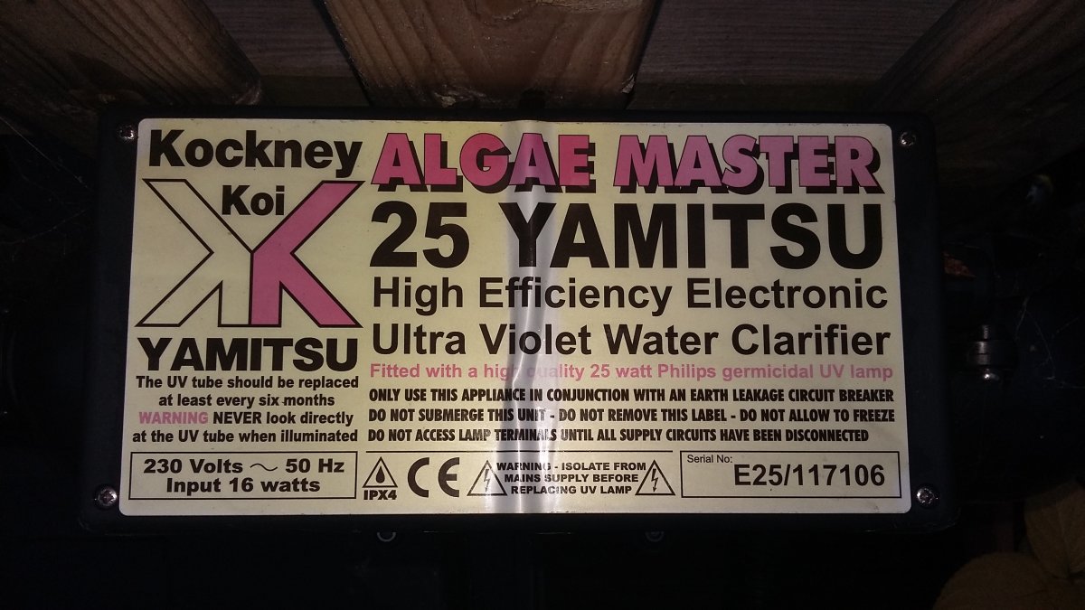

What lamp do I fit in this then? 25w or match the alleged input at 16w? I don't know what's in it at the moment. I just knower it needs a new one. is it possible to run a 25w lamp at 16w as per this label? or has someone screwed up this label?
What size is the old lamp?
Something is telling me 25w. Simply based on what I remember when buying it. I recall it was vastly oversized for the pond. my question I suppose was is it possible that this 25w unit is running at 16w as per the label.
if this Uv lamp data is correct, for your style, then you may only have one option
not only is one longer, one is T5 and the other T8, so the pins are different
•16 Watt lamp - Approx 286mm long x 16mm diameter - G16T5
•25 Watt lamp - Approx 435mm long x 26mm diameter - G25T8
