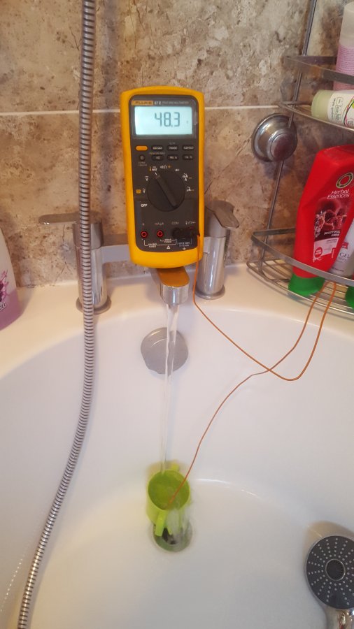

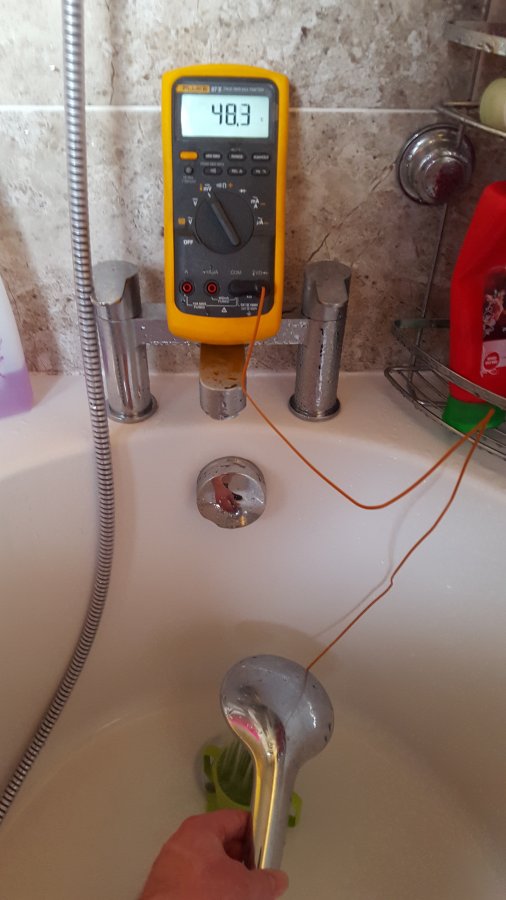

I tested it and my Grohe does not mix any cold water in when set to max temperature. I get 48 degrees from the bath tap maxed out and 48 degrees from the shower set to max temperature. Turning the cold water off to the shower makes no difference to the shower water temperature.
