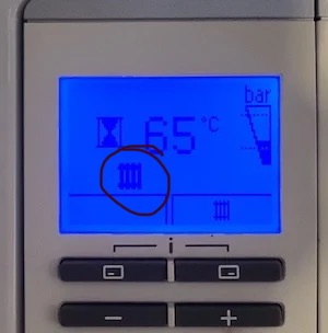

If I look at the Valiant on the top floor, I can see three icons show up:
- flashing fench icon
- tap icon
- circle with black filled triangle
Above the icons it shows 70c and when I press the i button on the panel the display changes and where it displayed the temperature it now shows the numbers 5. 7.

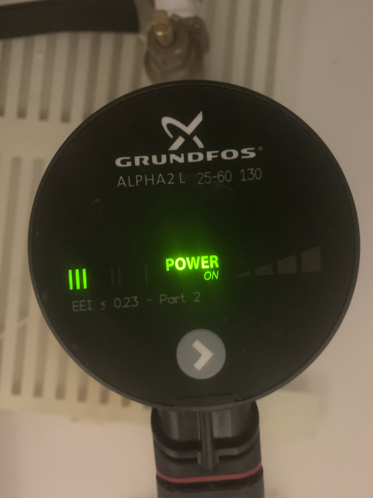

Common problem with these boilers. the pump cant shift enough water through the heat exchanger so the boiler goes into limp mode, what setting is the pump on and what size is it ? you could also try downrating the boiler to 20 kws and see it that helps. (how to is in the install instructions)

And what is a fench icon ?
I think he means 'fence' icon. I get something like that up on mine. I think it's supposed to be a radiator.

Drop the d0 to 20kws, it wont break or damage your boiler, post a pic of the pump and any buttons or dials on it.

Regarding your pump question, I think, you mean, the following apparatus Grundfos Alpha2L next to the Valiant. Am I correct?
