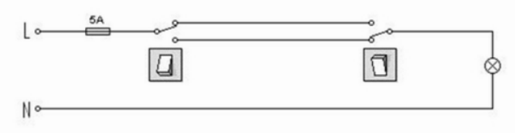

It could be either of these:
or other arrangements.

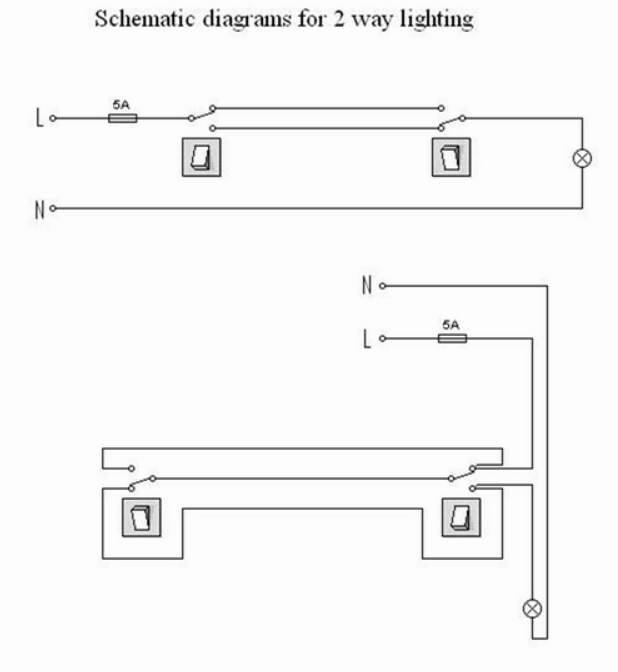

If this is your arrangement, you won't be able to have two dimmers.
If it is, can you work out what to do to even have one dimmer?
All slave and master systems are dependant on where the switch line and supply cable are connected using the Wavy line terminal and the L terminal , these must be connected to the relevant terminals, the slave wire just links switch to switch it must have no other wires connected to it, especially not a Live cable.
A master can be used alone and the Slave terminal unused, or with a Slave by linking the "S " slave terminals, Slave is not the same as a 3rd terminal on a normal 2 way switch.
The Slave system is designed to allow for dimming from 2 positions and not a Dimmer and Switch combo.
You cannot guess this as you will damage the switch.
Without pictures of the ORIGINAL connections its pointless to quess, i still cant decipher what you had Originally, though it sounds like.
You had a 2 gang Switch and a 1 gang Switch and NO dimmers
if One of the switches contains just a 3 core cable then its likely you can adapt to a slave master system.
If so Study EFLI's second schematic drawing and the Varilight website schematic and thats what you need .
