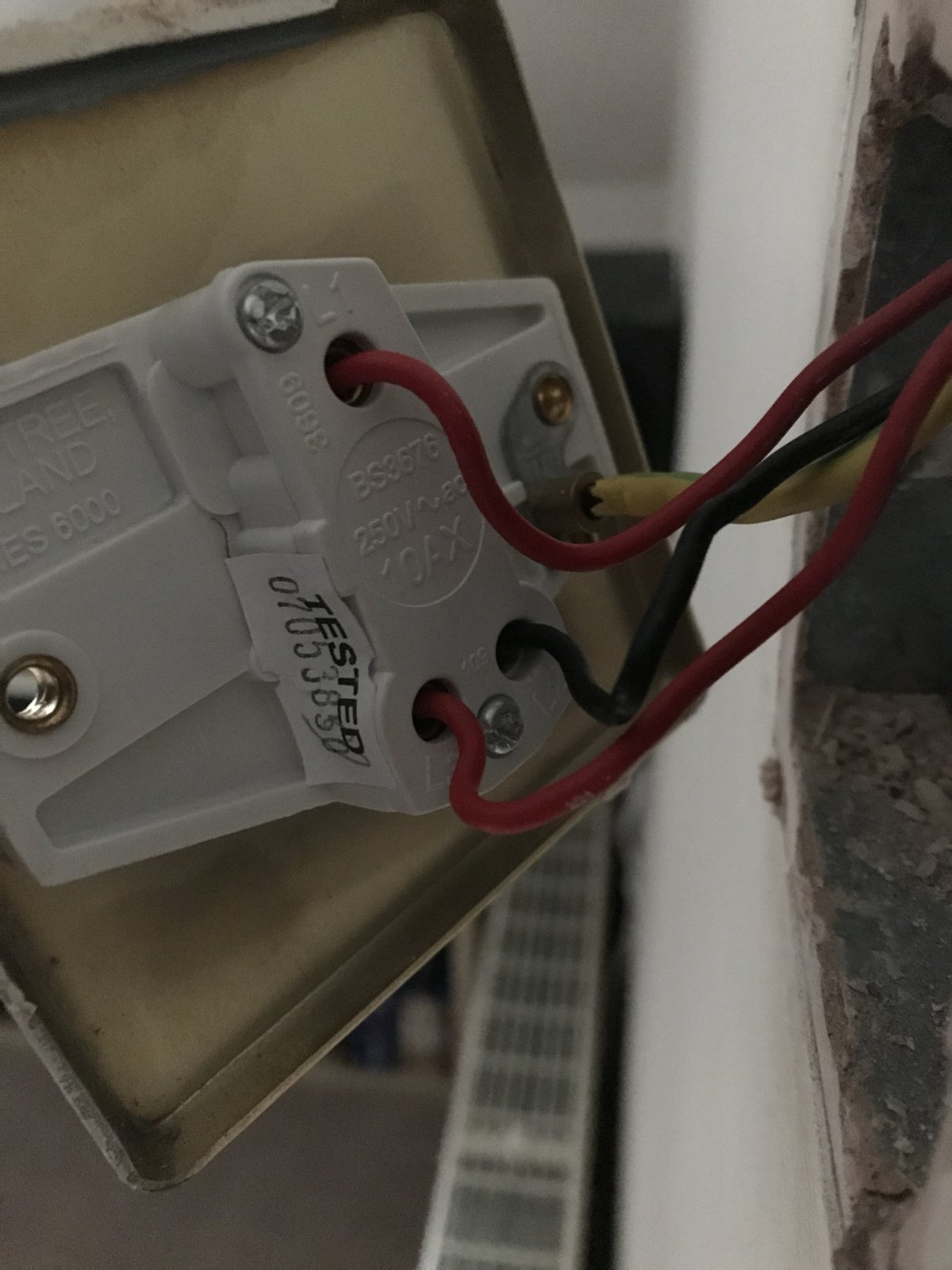

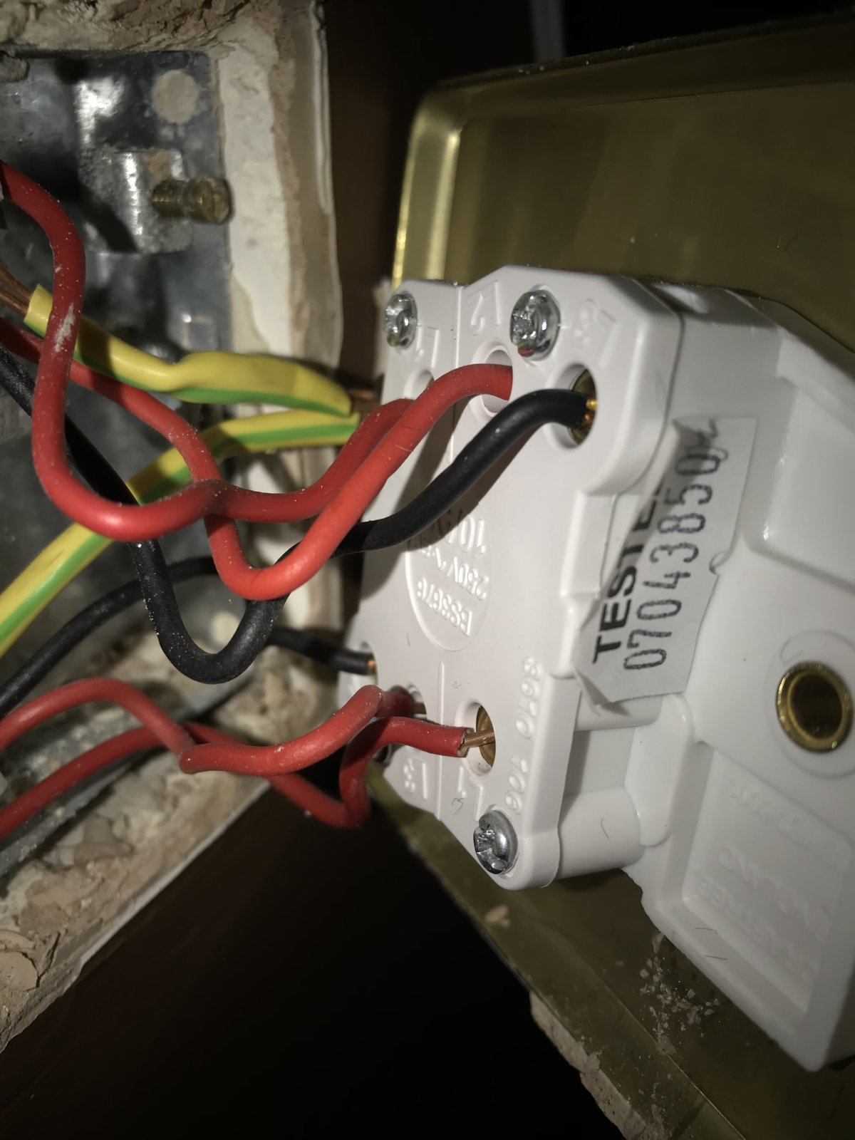

Varilight Setup
Sorry about the quality of the two gang switch. The switches are in a cinema room and the two gang is behind the screen, hence why it isn't needed anymore.
If the Master/Slave scenario won't work I will go back to the drawing board and think of another way to control the lights.

First impressions of that, is theres NO 3 core between switches and as per EFLI's first drawing the switchline is at 1 switch and the Supply at the other, adapting that to slave keeping 2 way is unlikely due to possibly only 2 link cables between switches, a rotary 2 way dimmer may be your best option, though adapting to one way using your IR master is possible, with a bit of thought
Would you recommend getting in a professional?
As Ban says you could learn how to do it, by studying the Websites drawing and the FIRST schematic posted by EFLI earlier.
Draw it out and transpose what you have colour wise on to that, post up for confirmation.
There is a way you could use just your master and just leave the other 2 gang switch behind the screen as it is, unused.
This entails using just the Live and the switch line , Irrespective of what Switch there at, by using one of the strapper wires to get both to the dimmer location
If you dont feel competent then a professional may be the way forward.
Though i would say on a difficulty level of about 5 out of 10 for a diyer

Yes its a shame, but sometimes you need to admit defeat.
Strapper is a term for the 2 or more wires that link between 2way and sometimes intermediate switches to create the switching function.
To be fair 2 way can be a headache for some so called electricians too.

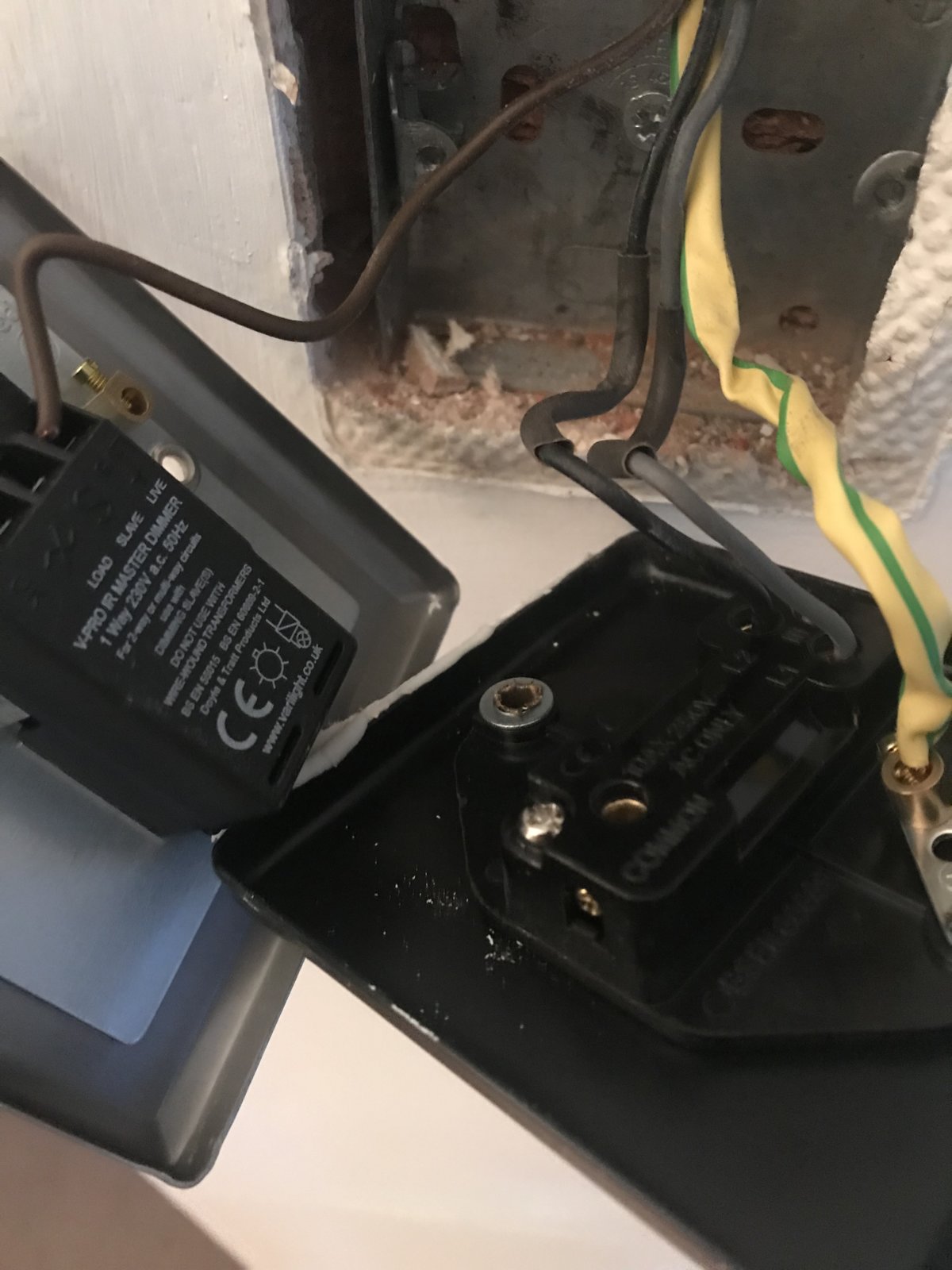

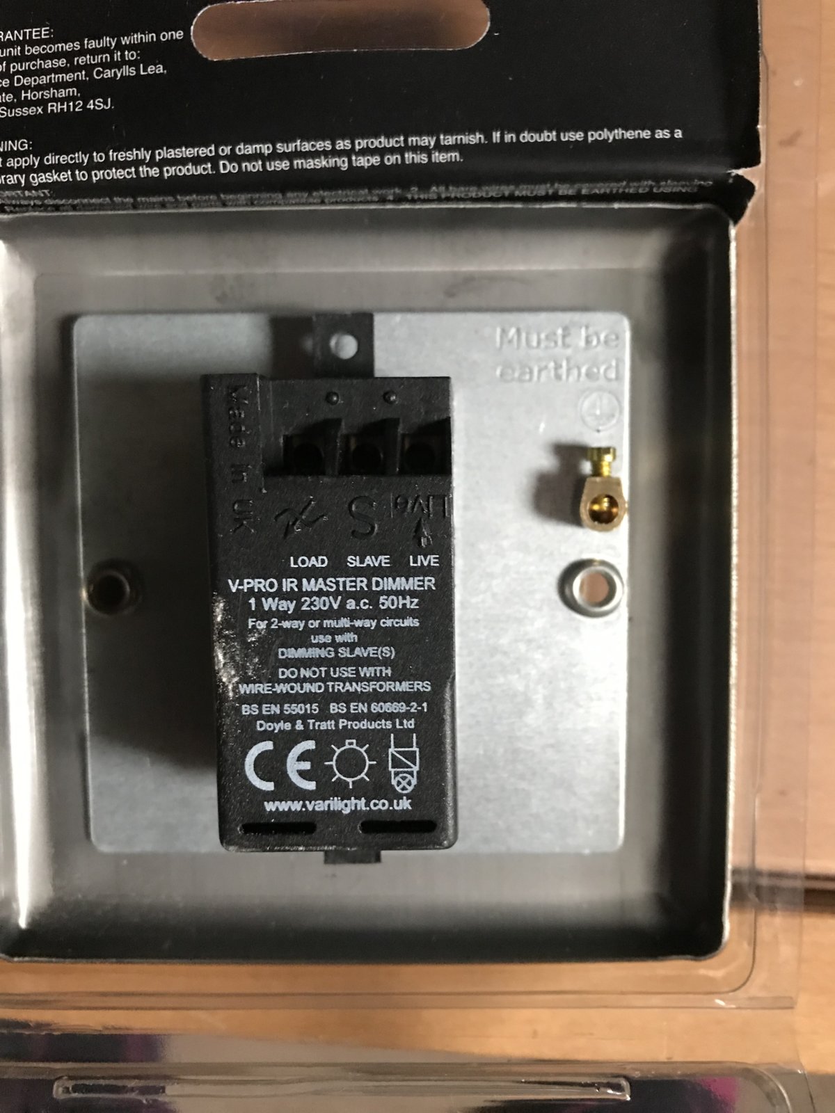

Sorry to resurrect this thread. I decided to buy the slave and try in my Living Room instead.
It has two switches, both one gang, two way. I replaced one switch with the Varilight master, Com to Live, L1 to Load and L2 to slave (picture below).
I then went to the other switch and replaced it with the slave. Again, Com to Live, L1 to Load and L2 to Slave. I turned the power back on and nothing.
What is wrong?
