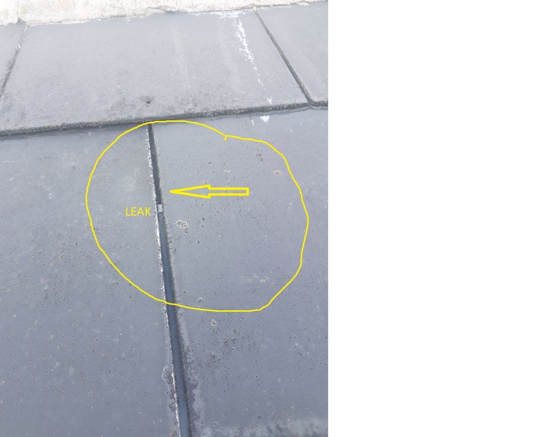

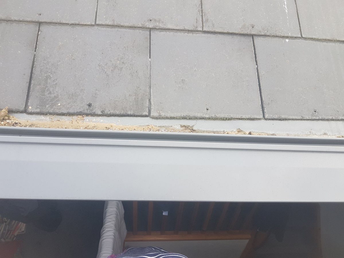

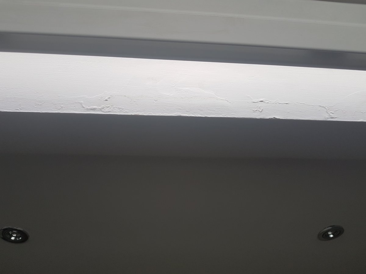

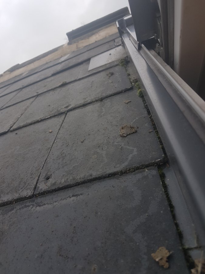

hi we're looking for some advice on the fitting of our velux window, it was actually fitted 2 years ago by our builder while converting our loft.
we have a damp area of painted plaster above the window that has been there, as far as I'm concerned, since the window was fitted.
the actual window doesn't leak and works perfectly, my worry is the slate roof above the window is letting in rain water, our builder has explained that he would have to charge us to look at it as it's been over a year since it was fitted, but I'm convinced it wasn't fitted correctly, please see the attached pictures, any advice would be greatly appreciated.

thanks! for some reason the pictures won't upload, I will try again.

The rear flashing is incorrectly fitted.
Their error, pretty basic stuff.

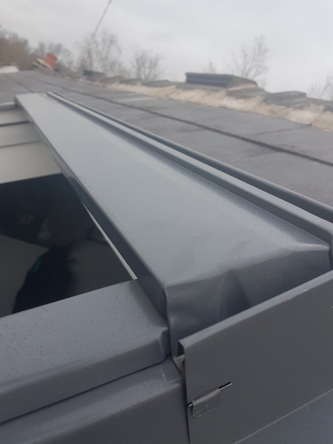

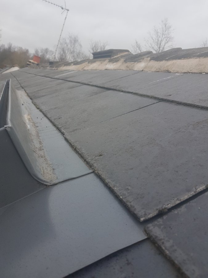

To point you in the right direction, The rear flashing (back Gutter) is under one slate to the rear actually it should be under two. well three really

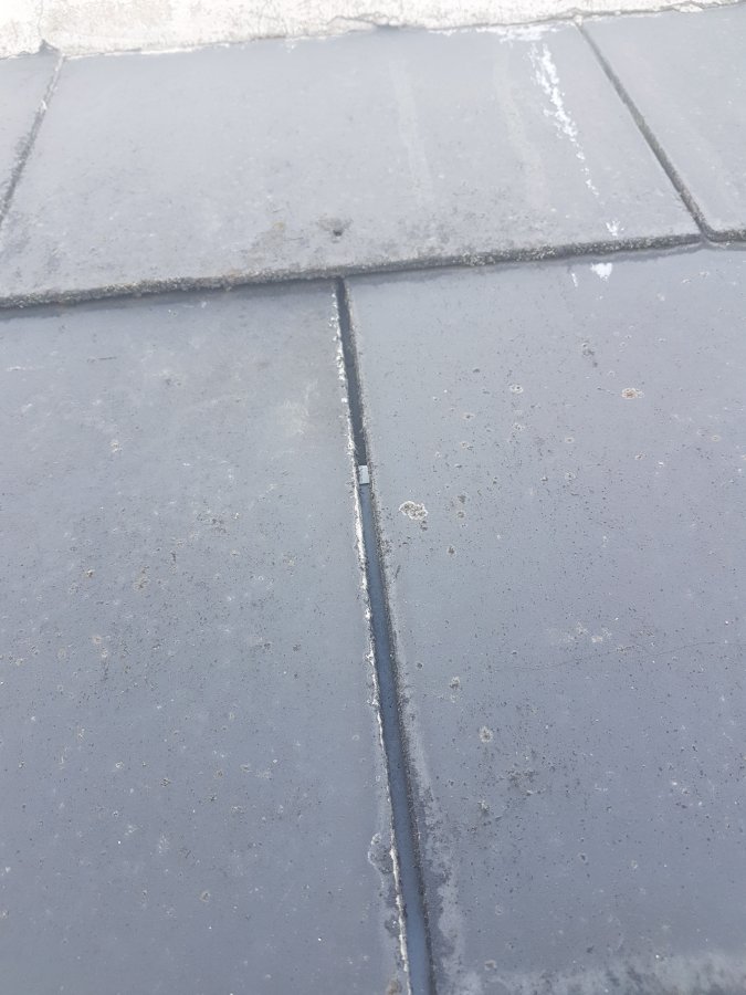

Look carefully between the slates you will see the top of the back gutter highlighted by a light coloured dot. Water will seep under here.
There are rivets missing in the abutting slates (not a leak but wrong)
The back gutter is sitting on a slate which it should be sitting under..
I can assure you the problem is poor fitting... Am sure others will confirm
Yep as above- just had a look at the online fitting pdf for Velux, they're even worse than the cheapie ones I got from B & Q (£80 with a flashing kit- bargain!)
The top and side gutters should be below all the slates (and ideally the roofing felt though that gets tricky)- gravity being your friend, water comes down from the ridge, hits slates and eventually your window flashing. Flashing diverts it round the window and back onto the roof via the front skirt (which is above the slates running below the window). At the moment, water is getting under the flashing and into your roof structure. Definitely wrongly installed, get him back out to do it properly
