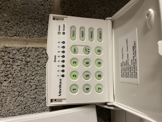

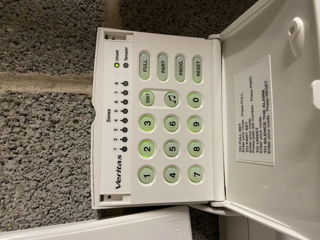

Old keypad is now next to the panel.
Old keypad is completely functional in its new location (addressed as keypad 1).

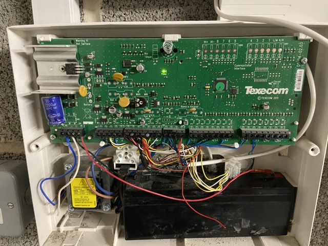

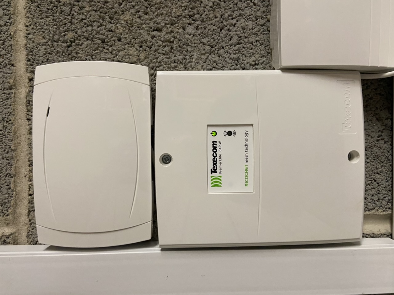

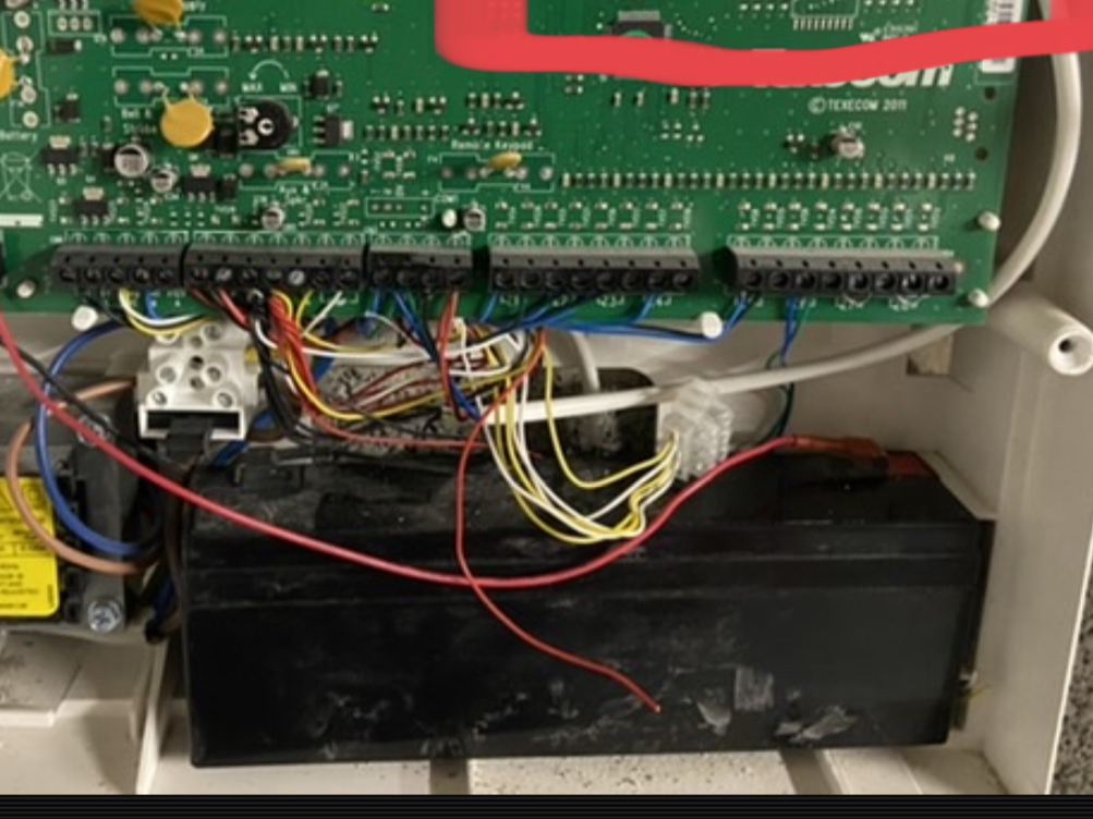

Hi.

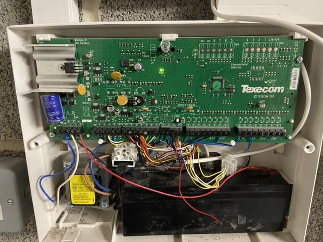

Thanks for the reply. I think so, it has a wireless module (Texecom Ricochet) attached, which provides connectivity to a few PIRs. I believe this will only work on a R8+?
Is there an easy way to confirm?

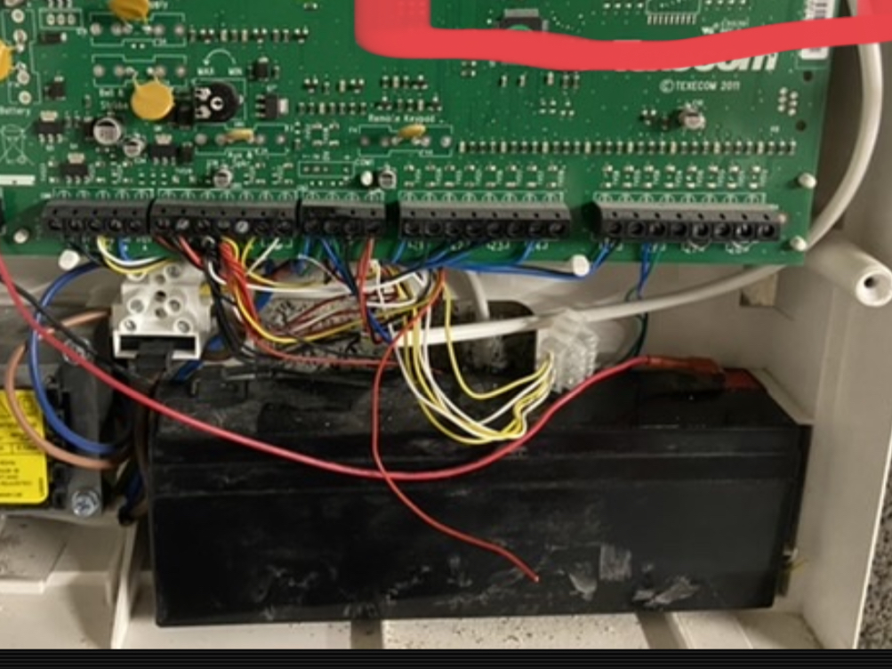

Sure. Pictures attached.
Thanks for your help.

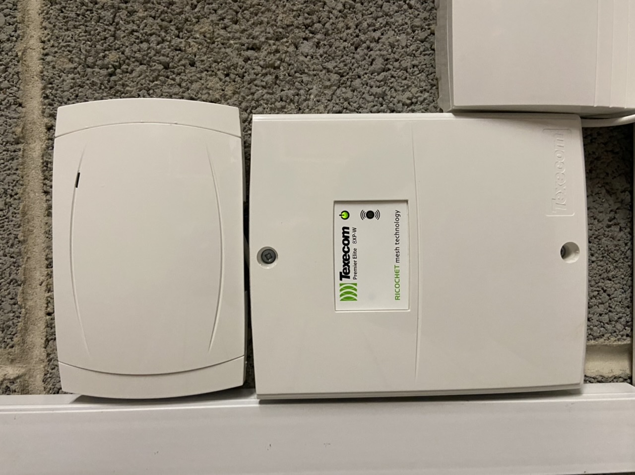

Wireless box picture attached.
Installing electrician assured me it was a plus, so will be mildly irritated if it isn't.
Feels like it's so close to working. Get all the right messages on the RKP screen, just buttons that don't work!

Change control panel for Trxecom elite 24 and you can have lcd keypads,reuse the ricochet wireless expander. This way you can connect smart com and contro system from your smart phone.
Any panel that accepts normally closed devices can use a ricochet expansion pack for the record.
Take photos of existing installation,control panel,pir,bell box
If sure ask question plenty of help on this forum
wont have any resistors with the new elite panel, so that's something to look at if the PIR's don't have them available I am guessing the wont.
label the cables in the veritas, bell , keypad and zones etc makes it easier doing the swap. follow the wiring as in the veritas.
the issue then will be the wiring type depending on what is available in the pir's
