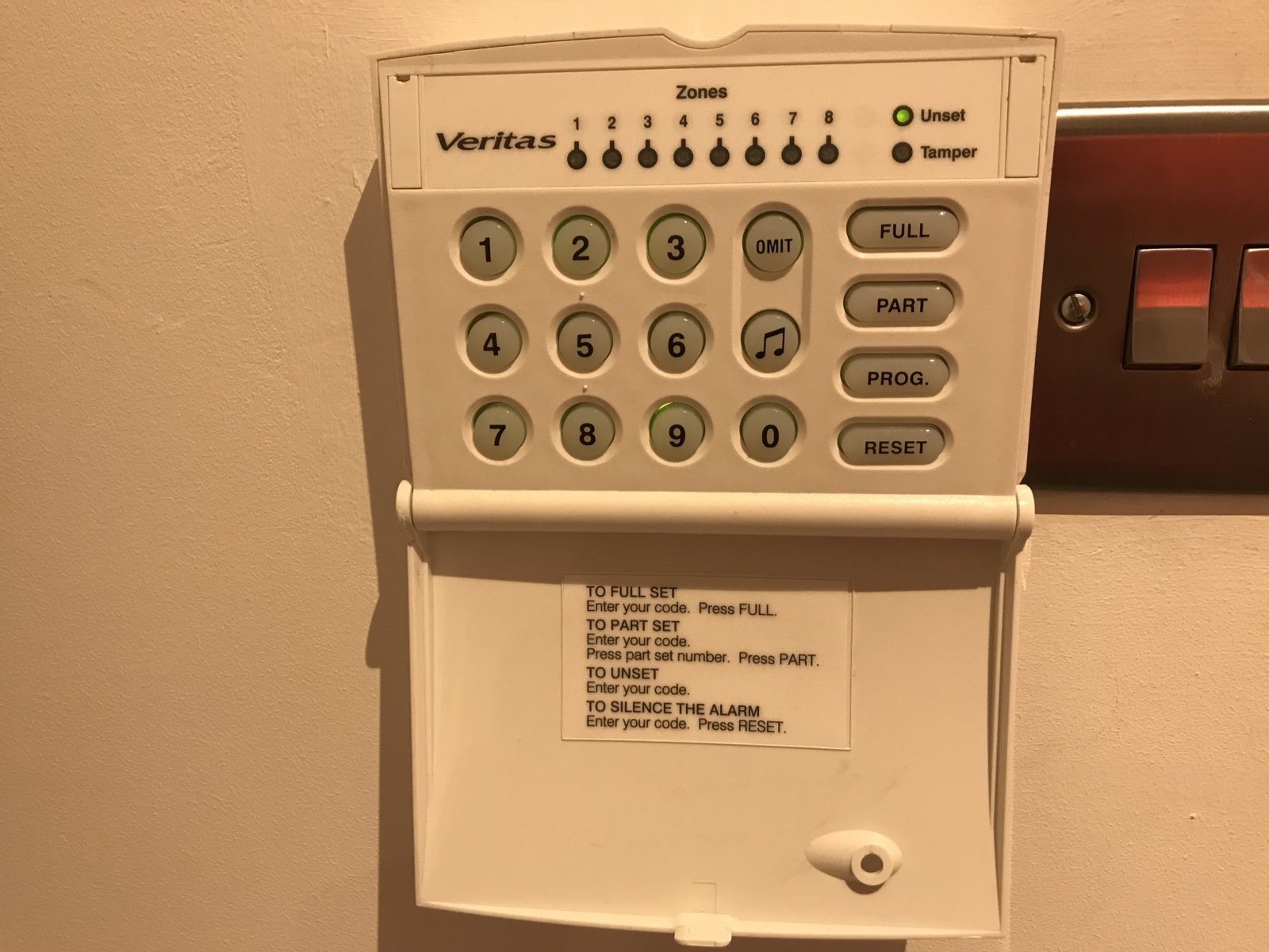

Veritas R8 zone disablement?
Take a picture of the panel/ keypad showing the issue.
Take a picture inside the contact.
You need to establish if we are indeed getting a zone light and a tamper, or just a tamper.
We then need to establish if there are resistors in the contact
Then we can look at the programming to work out what can be done next.
This is a step wise approach to find the problem.
A picture of the keypad/panel will give us confidence on what your reporting as the fault, the lights will tell us what's going on.
The problem is what you are reporting doesn't quite add up.
if a device is activated it should do nothing when unset unless its a 24hr zone type, you have changed this allegedly for the zone in question zone 8, but you are still getting a 24hr zone response.

Cant upload video.
So... open garage door, the bell box strobe flashes and panel makes an audible noise but no zone indicates.
Enter code, panel stops but strobe continues to flash. Zone 8 is illuminated
Hit reset and zone light goes out and strobe stops
Enter Engineers code Prog 18.
What is displayed?
Need to know the number displayed to try and explain the issue.
should be a 3, if not 3 press 3 and press prog.
Decide on what detectors you want to work during part set and how you want them to work.
Post back here and I should be able to advise you on what needs to be done.
Normally I would suggest you have everything on guard when part set, except a PIR that is covering access to the toilet in a normal house this is usually the landing PIR.
The PIR that covers the keypad, usually the hallway on the main entrance route can be programmed to start the entry timer when you come down stairs and the door contact can be placed as guard.
I need the zone numbers and what you want them to do in full set and in part set to advise correctly.

Menu 51 is the part set menu, all devices you want to work must be illuminated at default 567 are off.
menu 21 all zones to be entry exit in part set must be illuminated in here
menu 22 all zones to be walk through in part set must be in here
menu 23 all zones to be guard in part set must be illuminated in here
as I don't know what zones are what numbers and how you want it to work in art set I cant advise beyond this at present.
