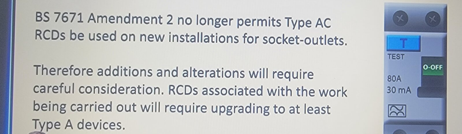

I did. I forgot that was the context of the most recent exchanges Does that mean that if the existing socket was turned into a blank plate, with joints behind it feeding athe socket in a slightly different position,you would not say that an 'RCD upgrade' was required?
However, as I implied, if you feel that adding an additional socket triggers the need for an RCD upgrade, then I would expect you to think that adding a new circuit (with new OPD in CU) triggers the need for a 'CU upgrade'. Is that the case?

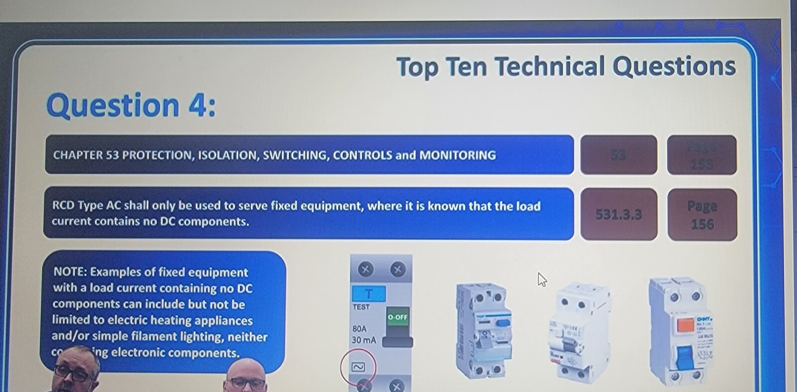

Maybe it is, but BS7671 doesn't make a distinction (between the types of certificate) based on that phrase. do they actually define what they mean by it? In fact, what BS7671 says about MEIWCs is:
... which appears to cover a lot more things than just "like-for-like" replacements, doesn't it?
More interesting, does any of this guidance on their website say that adding a socket to a circuit triggers a requirement to upgrade a Type AC RCD to a Type A one?
It doesn't matter if its a slightly different position or 20ft away....Addition so yes Type A rcd
Where do you think that an addition to existing circuit requires an update? If you extend to a new socket position and blank off the old position then you have merely altered where it is sited. If you add a spur to have a socket at your new site on the wall but still leave the existing in place then yes you have added. But in either position the potential danger by a AC RCD instead of a new fangled type A RCD is purely the same consideration "Do I consider it Satisfactory or not?". If it`s pretty much the same as it has been since the year dot then you will probably feel that leaving the Type AC in place is reasonable. However, if you realise that you have added loads of electronics, even slowly over a long period, you might reasonably decide "Oh better put a type A in place".
It is called, using sound engineering judgement. It is not called "Pedantically & slavishly following what I think the rules might mean I must do"
I could not say, without further information, if in you house it is really a must do or need not. In either event it is worthy of consideration I agree.
