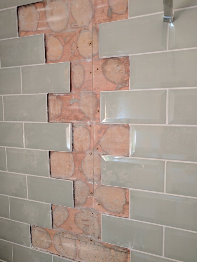

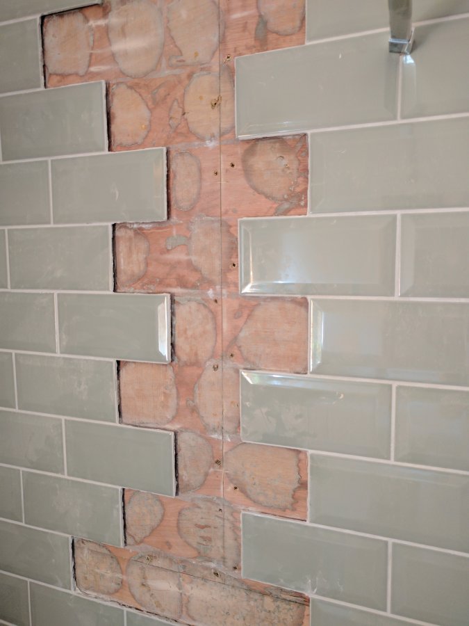

They have also agreed to remove the cracked tiles and replace. They have now removed them and I'm surprised at what I can see. The tiles are directly onto ply of some form and the cracks perfectly follow the joints. Why would this be??

Firstly, that's not tanked. Secondly, the ply has obviously moved at the joint and cracked the tiles.
It certainly isn't tanked. I know waterproof plasterboard was used at points as I saw it go in (after I reminded them). Is it ok to use the ply?
Edit *the guy did say he put extra screws in as it had hardly any in
I am a Diyer, not a pro, so take my opinion as such.
I've used WBP ply in the past and had an issue where tiles cracked across a join that i hadn't supported correctly. I used travertine tiles and it was around a shower. The ply moved slightly and the tiles cracked just as yours did. Because it was honed and filled travertine i was able to open out the crack and fill it with colour matched flexible grout which meant that it was barely visible. It didn't leak but the flex would have remained.
There are not many fixings in the the join so that might be the cause of the flex, but what is supporting the join?
No idea what's supporting the join, but you would *assume* there was some form of batten behind there which is then attached to the blockwork. Either way he has put more screws in to hopefully stop the movement. Makes me wonder what other wee surprises there are waiting.
He might have put more screws into nothing behind ! I have a very similar crack in my bathroom over a plasterboard joint
Perfectly possible. Time will tell I guess. If it happens again I will make more fuss.
Also, the fan has been replaced (incorrectly but I've sorted it). Just waiting on the roof being done now.
As another DIYer take my suggestion for what it may be worth also. Surely when you butt join boards, (whether they be ply, plaster, block etc), you should leave a slight gap to allow for expansion/contraction and cover the joint with some form of scrim tape?
I would suggest it's leaving a gap for expansion / contraction that causes the tiles to crack.
The ply should be primed with SBR Primer (good brand) available at topps tiles : http://www.toppstiles.co.uk/tprod8763/bal-bond-sbr-primer-1ltr.html
before fitting the tiles on top. Tiles should never be stuck straight onto ply, I wouldn't even trust marine grade ply for this purpose.
It's no wonder the crack line appeared where the two ply boards are butted. It would have helped had he left a minor 2-3mm gap between the boards to allow for contraction and expansion (may have got away with it) but the lack of adequate sealing with primer was the icing on the cake and when the boards moved the tiles had no choice but to shear apart.
