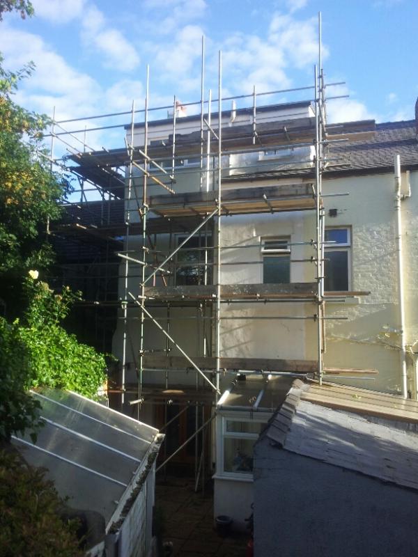

Just a guesstimate, but that house doesn't look to be 200 yrs old.
Perhaps there's been some confusion here - a line of rusted wall ties in a cavity wall will create a definite horizontal crack in the bed of the external skin.
The wall needs measuring, and why not remove a discreet brick or use a scope to see inside the wall.
Why would render have been applied over the historic pebble dash?
Why has the render failed?
Please quote exactly what it said on the (RICS ?) Surveyor's report?
How would you determine its' age from that pic?
Styles, and types.
It's not really my bag, but I know people that do it.
I wouldn't look at that and think it is 200 years old, or I would assume more modern extensions that maybe do have cavity walls.
But like I said, it's not really within my comfort zone to claim I know.

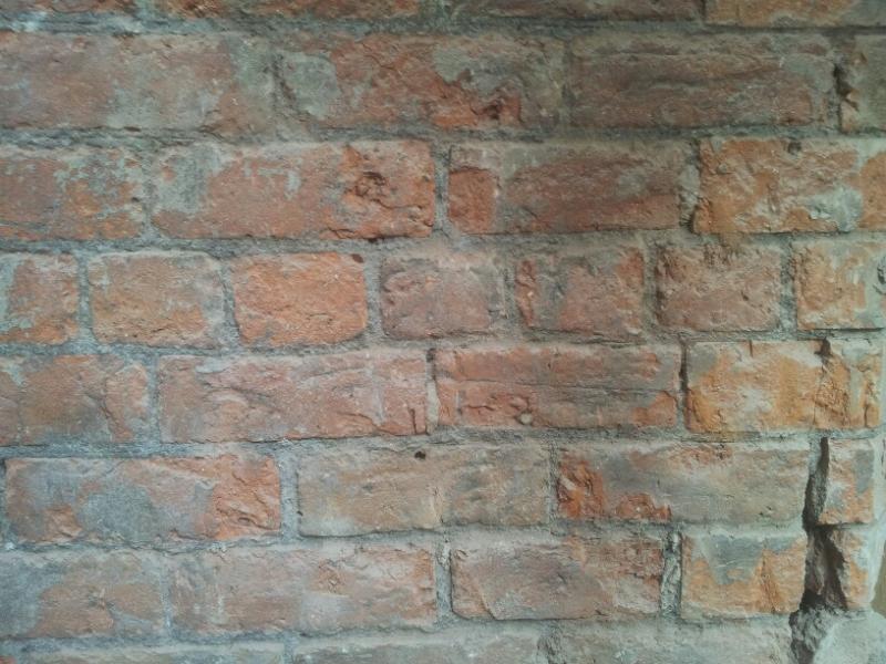

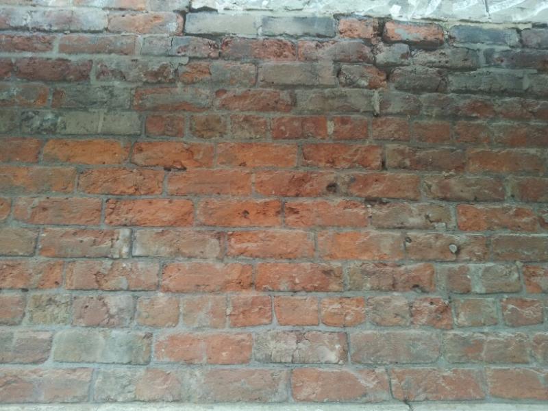

I think I might have figured it out. If you look at the brick pattern i think the walls are tied together with bricks on their end. There seems to be a line of bricks going the other way every 7 ft or something like that. It annoys me that "petre fox" spelt wrong tried to sell me wall ties when they must have seen the bricks when they put the scope in.
What do you lot think?
Typical example of English Garden Wall bond; one course of headers to five courses of stretchers.
The mortar looks to be 'black ash; mortar - common in the north and midlands from the mid=19th c. onwards.
Think you are correct. I know nothing about mortar but it is black in colour and ashy. So do you think I am safe not getting the wall ties done?

perhaps you would post pics of the frontage of your house, and the other house frontages that make up the terrace. Its usually a very good indicator of age.

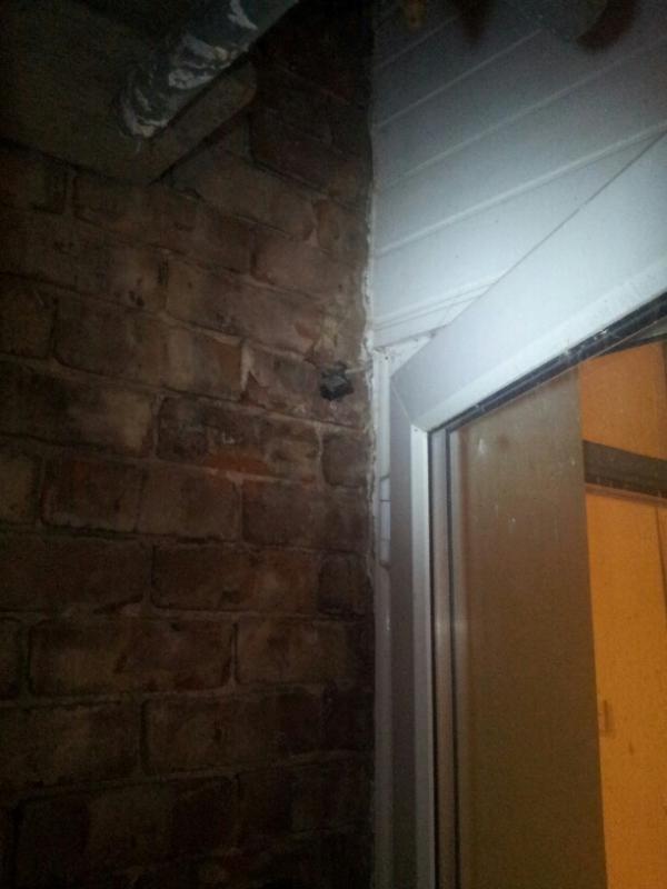

Where were pics 1. 3. & 4. taken?
The property to the left appears to be much lower than yours so its doubtful that it was ever part of one house with your house.
I believe English Garden Wall is 1 in 3/ headers to stretchers whereas 1 in 5 is known as American bond.
English garden wall bond . Three course stretcher, One course header.
Scottish bond Five course stretcher. One course header..
American bond. Depending on area where you are working, three to nine course stretcher one course header.
