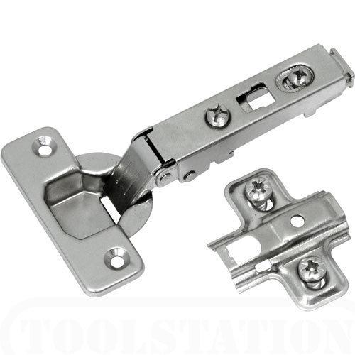

I need help/advice on where to fix these to the cabinet - there are 4 hinges per door - where do I fix them?
Or more correctly - how do I work out from the door where to attach the hinges to the cabinets? so that the door is correctly positioned?
The carcase fitting ends of the hinges, are they flat plates attached via lock screws to the end of the hinges (these would be the points of adjustment)...pinenot :confused:
P.S. here's an image
Measure to hinge centres on doors then tranfer to carcase, they are usually set back 17mm but can vary depending on hinge,there is normally 2-4mm adjustment up/down,in/out on the mounting plate if you are not spot on.
