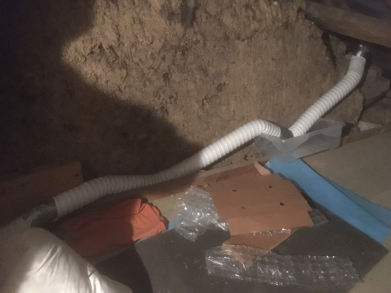

Hi all,
I discovered that water was collecting in the duct piping from the bathroom extractor fan to the roof.
I thought a temporary bodge would be to pierce it a couple of times and bleed the water out. (Hence the duct tape!) and to insulate it with some old duvet covers.
Obviously not a long term solution, and the water is still collecting. (Its been a very cold winter so the water has condensed faster in the pipe.)
Its probably about 5 meters from the extractor fan to where it exits the roof. And the exit about the fan is perhaps not even a metre.
What should I do?
1) fit rigid duct, which is straight so does not sag into loops that hold water. Go straight up from the fan, then run the rest not quite horizontally, but tilting slightly down to the outside so any condensation runs out
2) wrap the duct in loft insulation so it is warmer and not prone to condensation
3) run the fan for longer, starting as soon as you go into the bathroom and before you turn on the shower, and running on until the room is dry. This can usually be accomplished by wiring the fan to the light switch, with a run-on timer

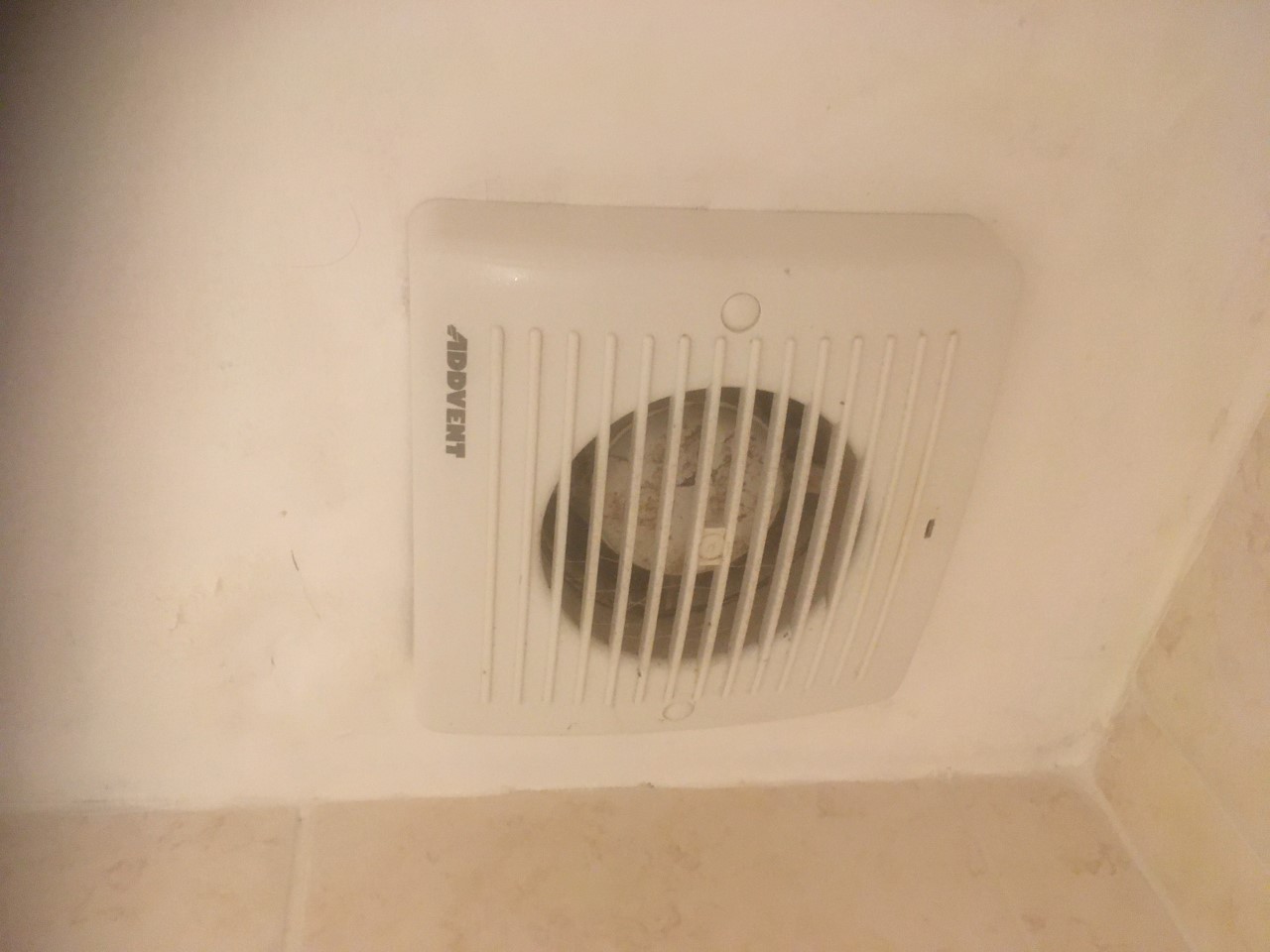

4) you might need a more powerful fan. Show us the one you have.

If the fan is one of the poxy token gestures that are fitted, you will have problems.

If you run pipe vertically from the fan you would need a condensation trap. Good idea to run the fan longer to clear condensation in bathroom and dry out the pipe.
Heres the fan. Hardly looks like something Elon Musk would have in his bathroom! :LOL:

As you have a loft duct you could have a ducted inline fan up there, three or four times the power, preferably a timer model

For a budget solution, do you think leaving the flexi duct as it is, but add the condensor trap and run the overflow pip out of the eaves?
Ive just fixed the issue. It is just a temporary fix (luckily we're going into summer so I wont need to worry about it for a few months). Ultimately I will do a proper job. But for now I just bled the water out (most of the length of the duct was full of water!!); wrapped duct tape around the bits I bled; and raised the duct up a bit.
