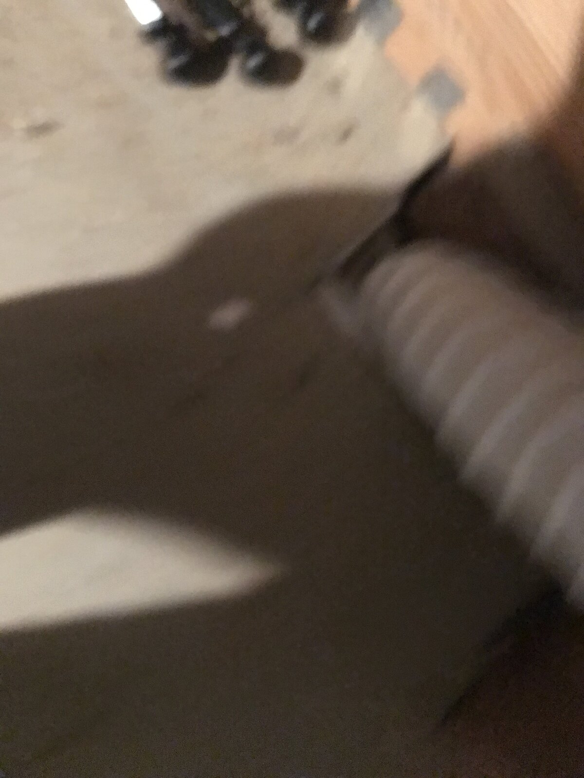

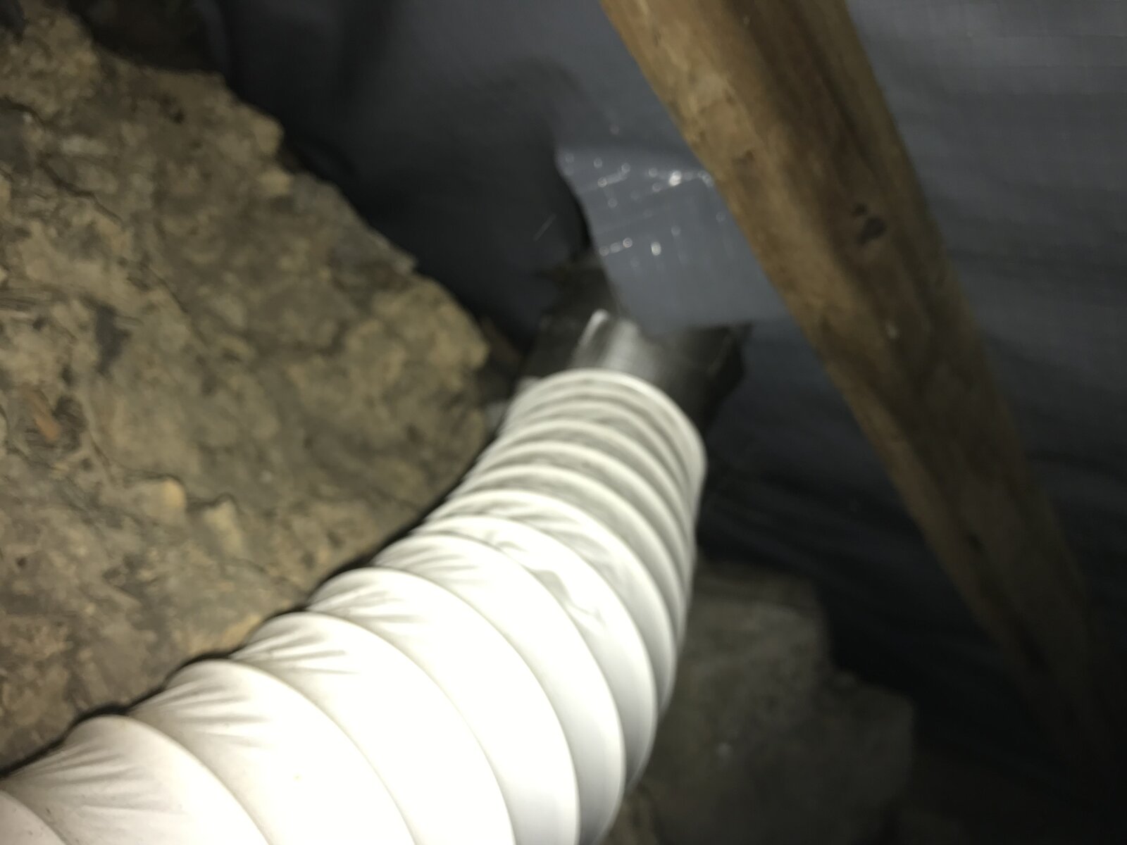

It looks like the original installers gaffer-taped one end to the exit in the roof. (unless they gaffer-taped over a jubilee clip). This in itself is not an issue
... however, the other end goes into the insulation hardboard flooring. So perhaps - to get at where the duct connects to the fan - I need to lift up that section of the flooring. Something which Im inclined not to attempt.
Is it possible to connect some new insulated duct to the existing duct? Probably not. But if it were possible then I could leave the flooring in place. Bloody hell.
The fan will need dropping from below. Remember you've got a ceiling, gap then board - the ducting will be attached directly to the spigot on the fan.
