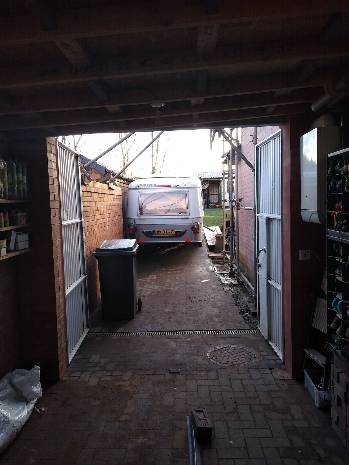

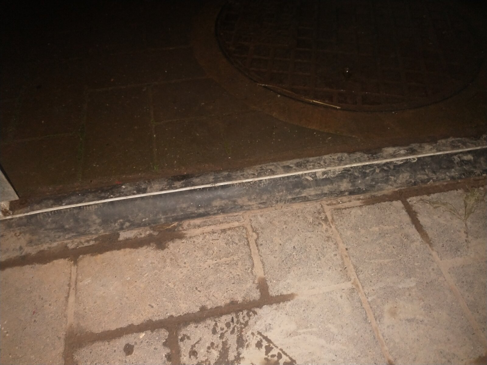

I can recommend the stick on weatherstrips, although a bit messy to fit they work well, my drive slopes down to the garage:
I found it helpful to cut a few inches off the roll to experiment to find the best position before glueing the strip down.

So, you fitted that?
Yes. It's only the small area between acco drain and doors and a slight slope - water used to come in and now it doesn't.
Originally I has a set of uPVC french doors there (back of a through garage) but had to rip it all out to get my caravan through to my back garden.

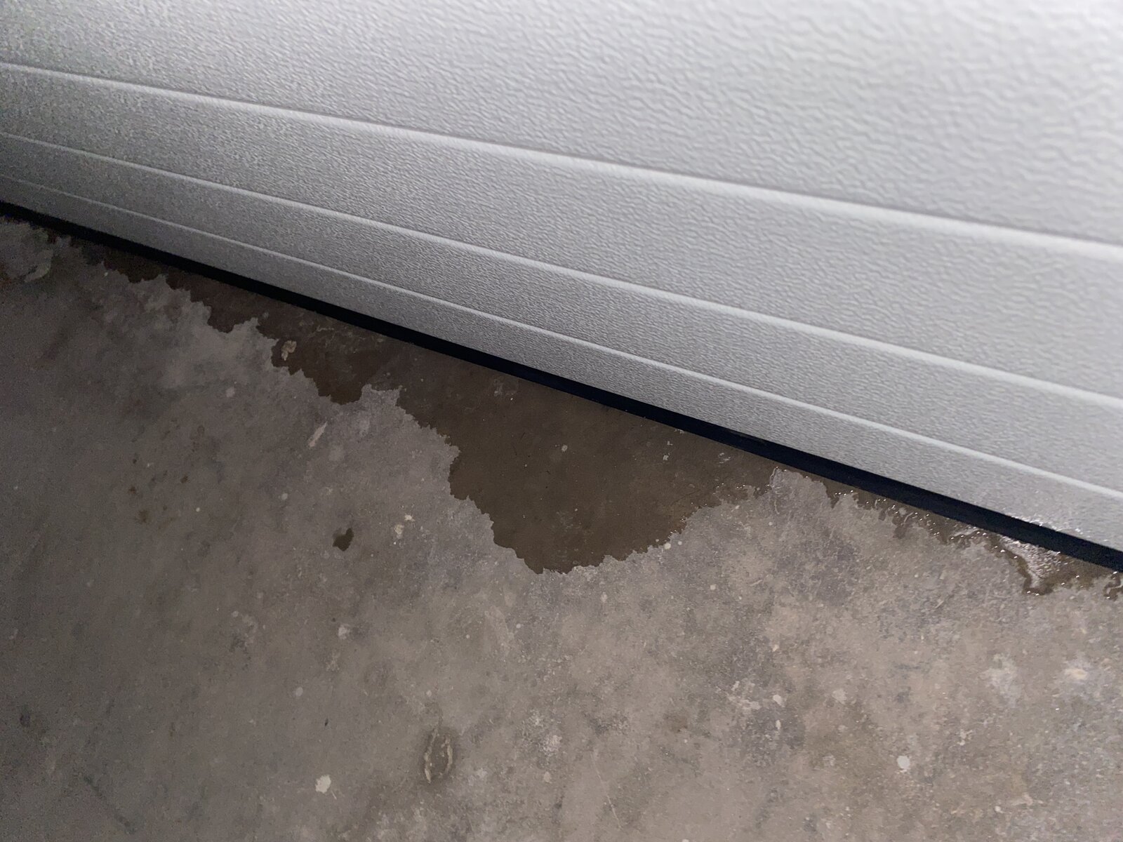

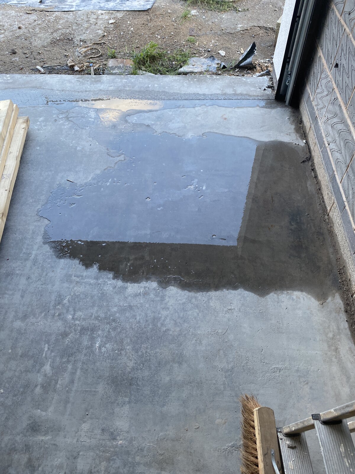

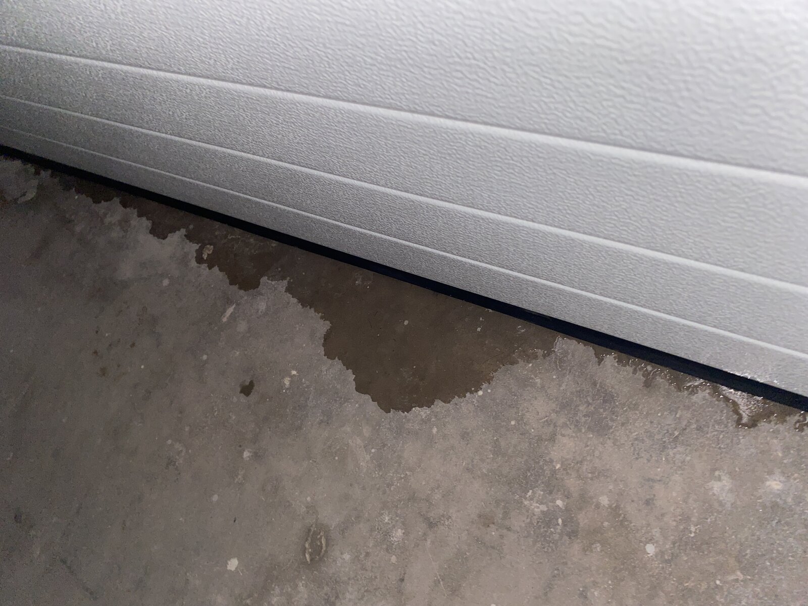

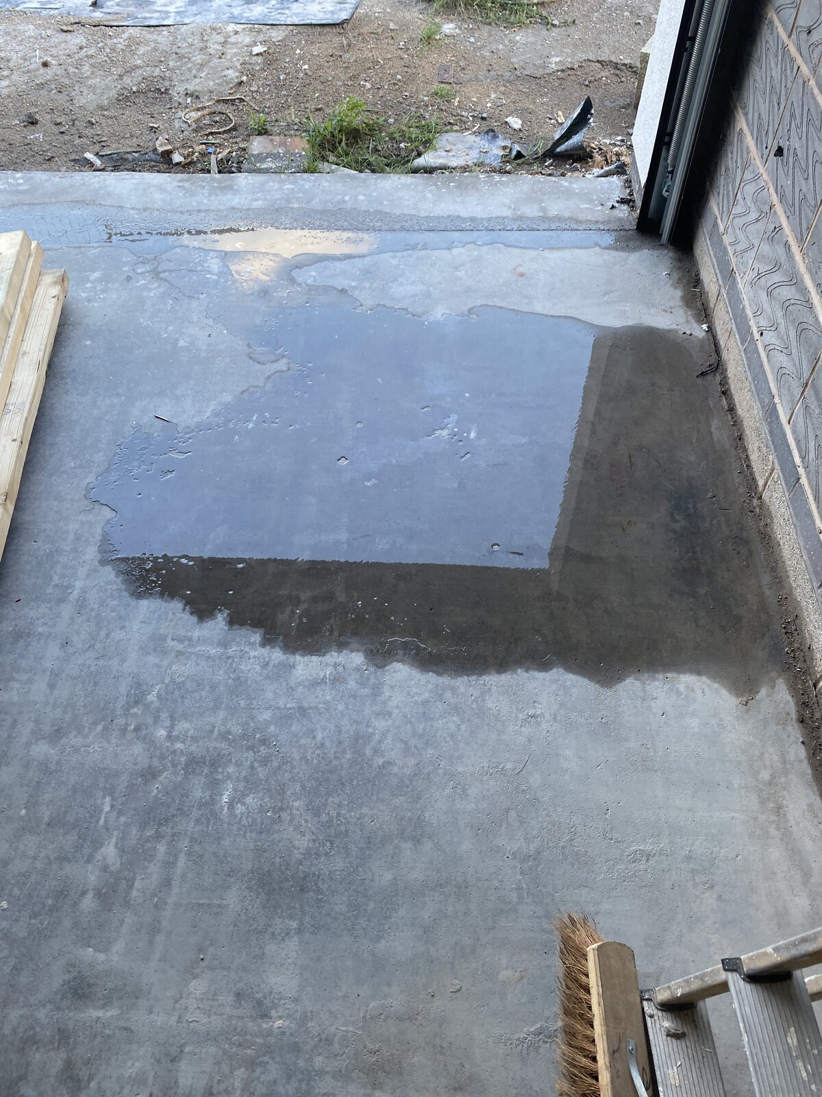

Hey guys,
Do you think this is acceptable? Newly fitted garage door, and the first time it rained I noticed water coming in under the door:
Following morning I was left with this:
Emailed the manufacturer/fitter (same company), to say I didn't think the door was closing properly (pushing the seal into the floor enough) and to ask if was there anything that could be done to adjust it.
Response was as follows:
"Sometimes this can happen with some doors, even though the seal is tight to the floor, there is still the chance of water coming through. This is something that unfortunately cannot be foreseen prior to the installation.
Weather strips are purchasable from us for £120+VAT, alternatively they are available to purchase for self-fitting from companies such as Screwfix."
The door/fitting cost was north of £3k. Is the above a valid response and I just need to suck up the costs, or should I am I being reasonable to expect a weather-proof door?

The rubber seal is designed to keep out dust, leaves etc and help the door shed water. It’s not designed to stop water coming into the garage. If it did, then any pooled water it was keeping out would just run into the garage when you opened the door.
In my opinion, the door supplier should have quoted for and supplied a raised threshold to stop runoff running under the door. You would have paid more for it, but they’d have fitted it at the same time as the door so wouldn’t have cost any more in labour. I’d be going back to the door company and offering to pay for the threshold if they come back and fit it for free.
