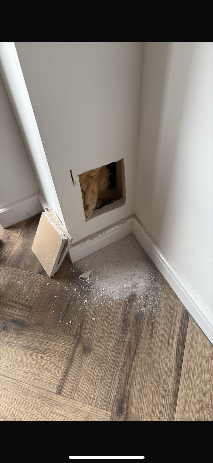

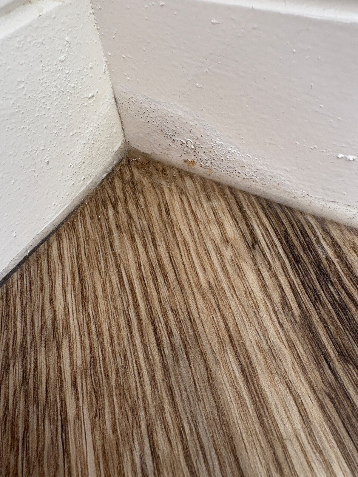

On Friday evening, I noticed some slight discoloration and changes to the skirting board in one corner of the room, which prompted me to investigate further. I purchased a damp meter, and when it arrived, I tested the area. It gave a reading of 37% moisture at the point of concern, with the readings decreasing as I moved along the skirting board.

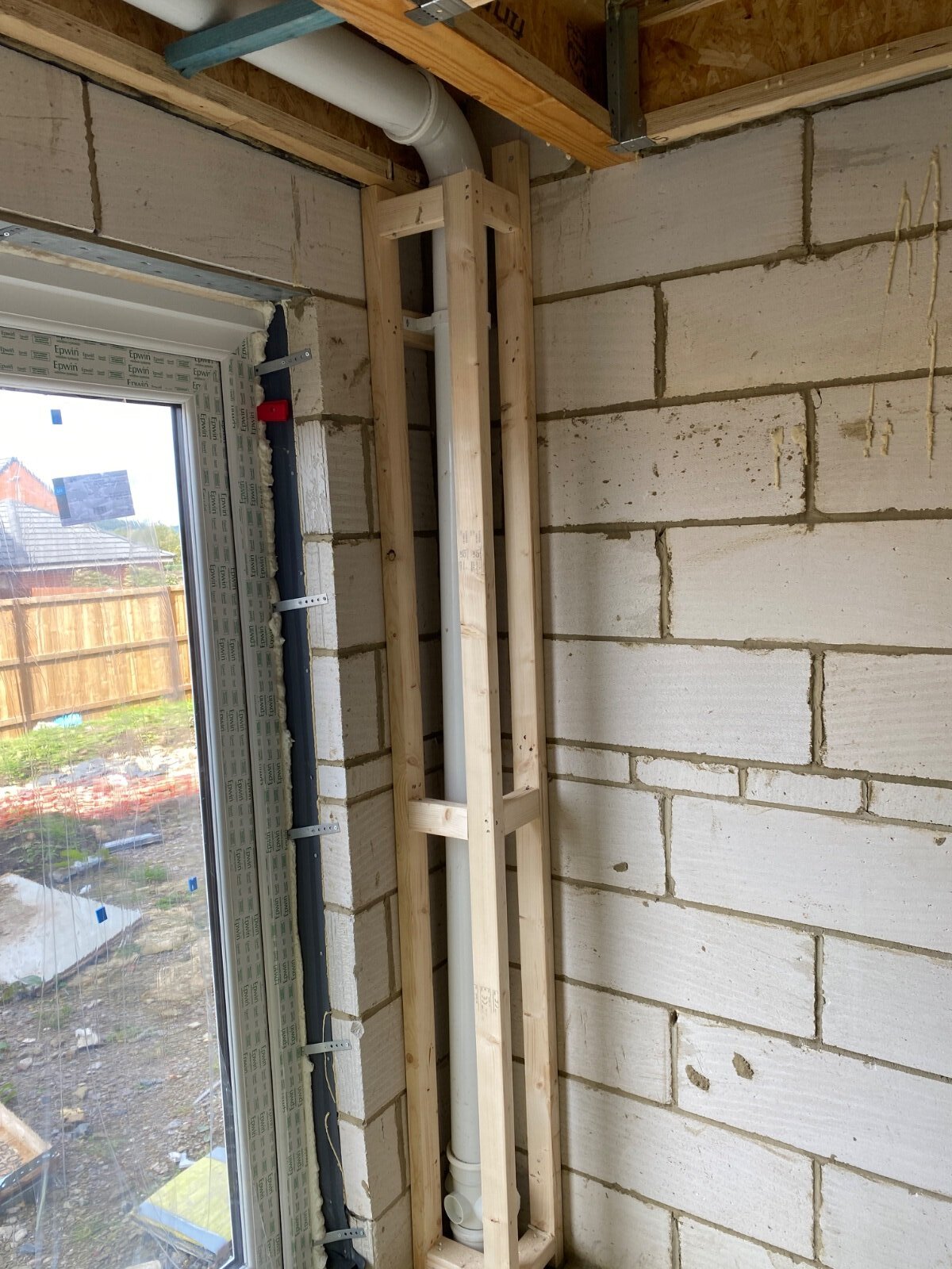

I've been in the bouse 9 months, (new build). I spoke to the site manager, who kindly came to inspect the issue. He suggested it could be a leak from the internal soil pipe, which runs from the main bathroom down the wall in the same corner. He arranged for someone to attend the same day. They cut a hole in the wall but found no visible leaks or signs of damp insulation. However, they did identify and fix a small leak from the bath, which they suggested might be the cause.

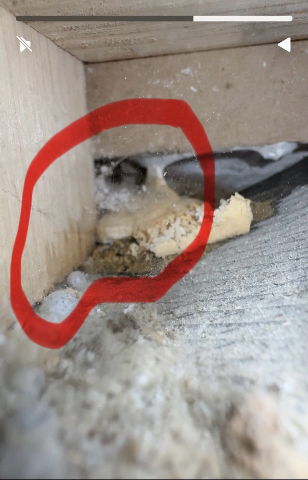

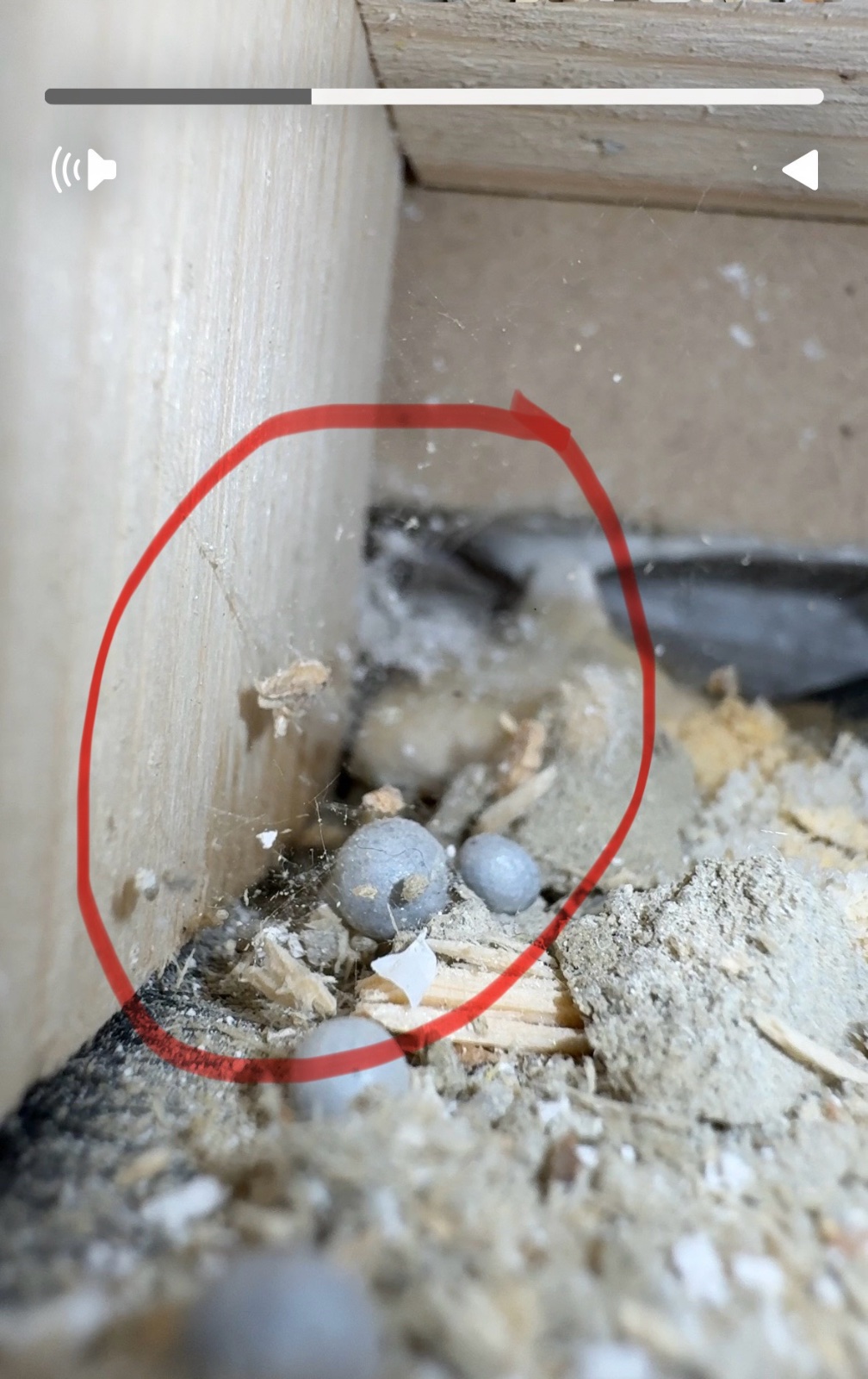

I’m not entirely convinced that a minor bath leak could result in damp spreading approximately 10 meters along the pipe. When I got home, I inspected the hole using my phone camera and torch and may have found signs of water ingress (please see attached image).

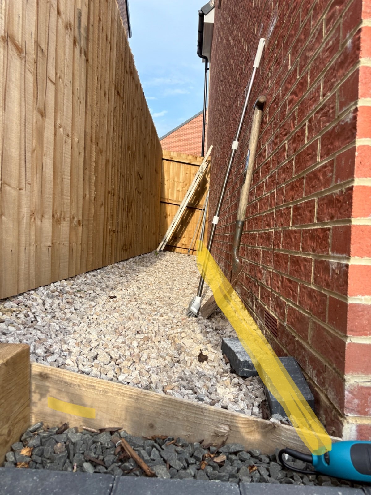

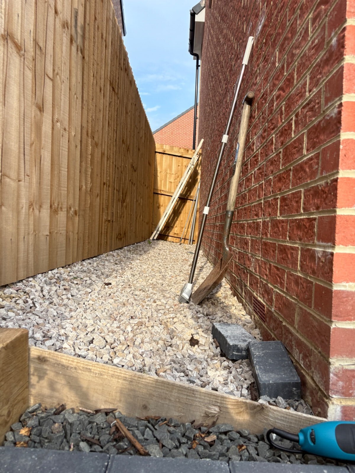

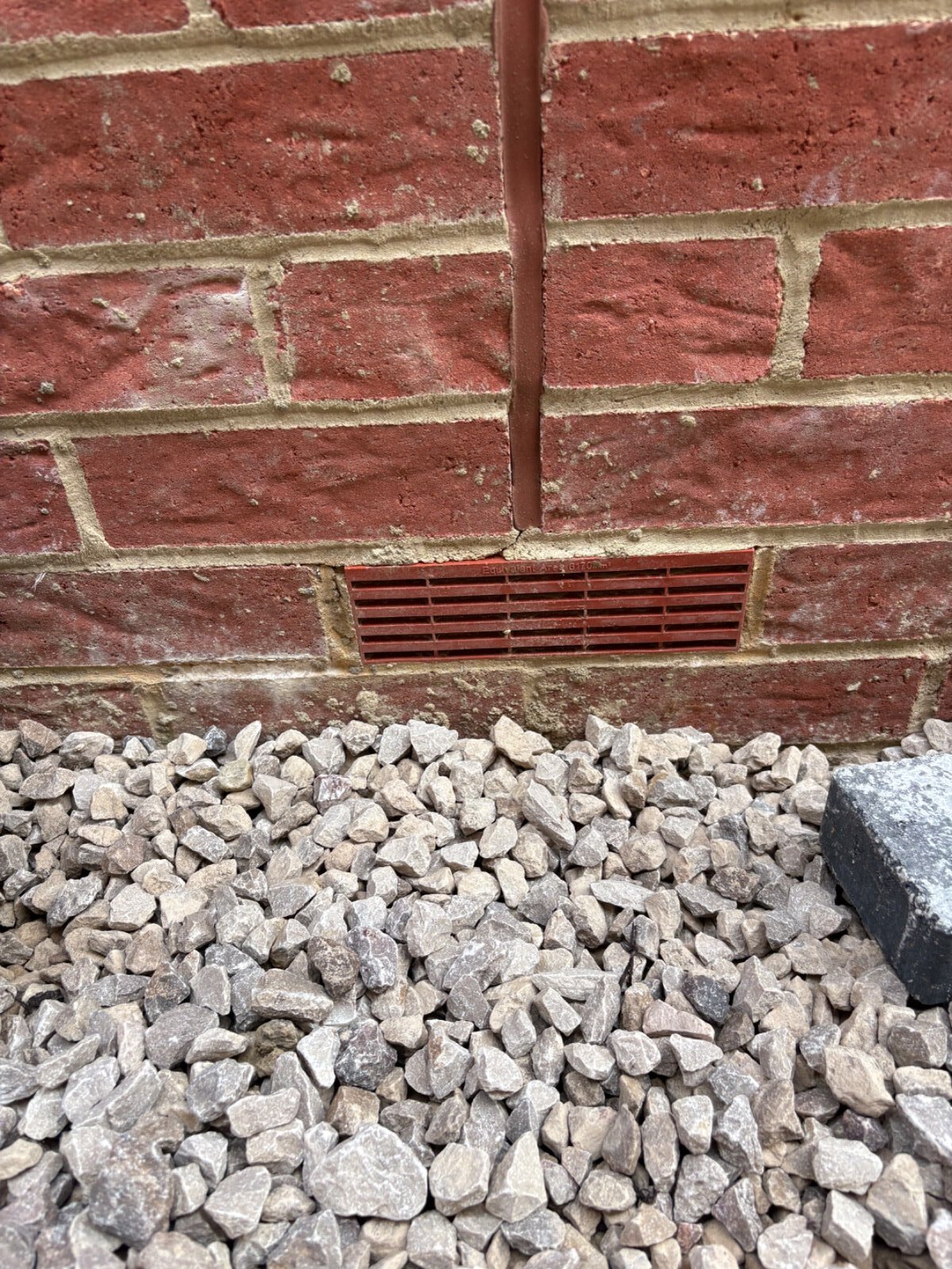

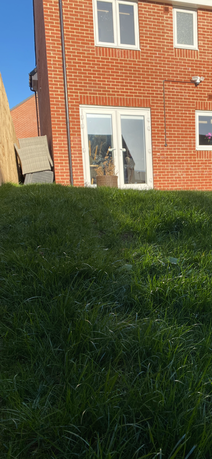

Interestingly, the damp area seems to align with an external airbrick. Could this be the source of the issue? I’m also aware that the ground slopes toward the house, which might contribute to the problem. However, if that were the case, wouldn’t I expect to see damp along the entire wall rather than just in isolated sections?
Should I be asking for the ground to be levelled, or for further inspection around the airbrick area internally?

Keep the area well ventilated so it can dry out so you can get an idea of what’s going on.
Leaking water, how ever little will run to the lowest point before becoming obvious
A french drain would be a good idea along that wall for a start. That would take any water away from the bricks etc. Something like this:

Would it be worthwhile removing the damp skirting board to get a better view and also to help the drying out.
I'd imagine if the MDF skirting board has 37% moisture in it, it's going to take some time to dry out!

Yes, remove the skirting...let it all dry out. Just maybe it was that leak from the bathroom. Keep an eye on the area and def think about putting those drains down the side where the ground slopes to your house...
Where is the water draining to if i install those drains? Do i need to do any further work or is it a case of creating a channel all the way down the side of the house, install the drains at the required level and leave as is?

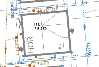

this is also the planning details for my plot from council website.
Does anyone know off this if i have a drain channel already there?

I've been in since December last year and whilst we have had some terrible weather, there has been no signs of pooling water.
When we initially moved in, the garden was a mud bath so all out garden furniture, storage boxes for cushions and so on where stored down the side of the house as pictured. If i remember correctly and now i think about it the garden box was shoved agaisnt the wall, covering that specific air brick from maybe December to end of feb, beginning of March.
Pic attached, can just about see what i mean.
Do you think that could have been a possible cause? or possible peresisnt splashing/water run off entering the air brick?

From the information in this thread, the likelihood of that damp being caused by ground moisture would be less than it being caused by that waste pipe. That's not an absolute but based on probability.
The ground is bone dry. What wet weather have you had in the weeks or days before that photo to have caused that damp?
Compare with what usage of that waste pipe has occured in the same time period.
Unless blatantly obvious, investigation is going to be intrusive and may be imprecise. So it may be best to chemically test that damp moisture to identify if it is waste or ground water. The builder should pay, but the tester should be independent.

I've highlighted in red where the damp appears to be. Would it be highly plausable to say the insulation could have been wet but has since dried out and now the bit which I've seen when using my camera seems to be that section of wood next to the red spot which may be the last bit to dry out?
