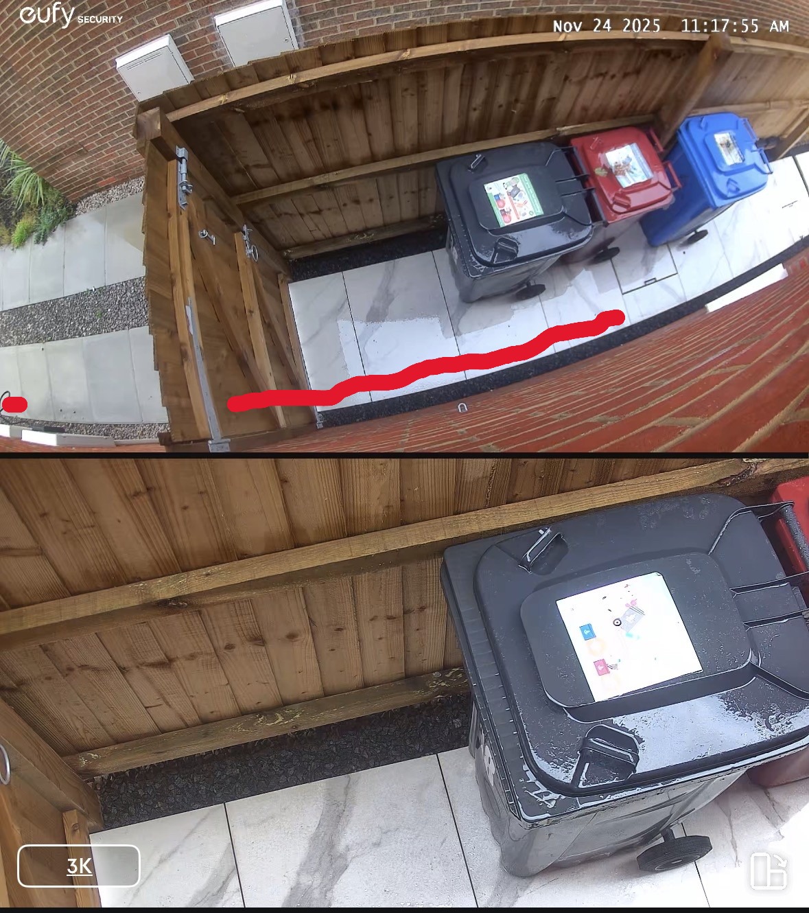

It's the side of our house with approx 100mm of gravel agaisnt the wall, then porclain paving and another 100mm of gravel against the fence.
I did check last night and couldnt see any water pooling or anything like that. It was chucking it down yesterday so could only assume is was the driving wind against the wall but not a clue!

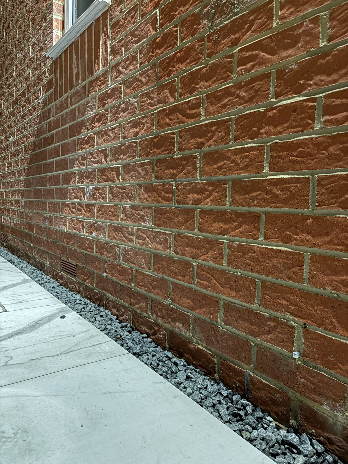

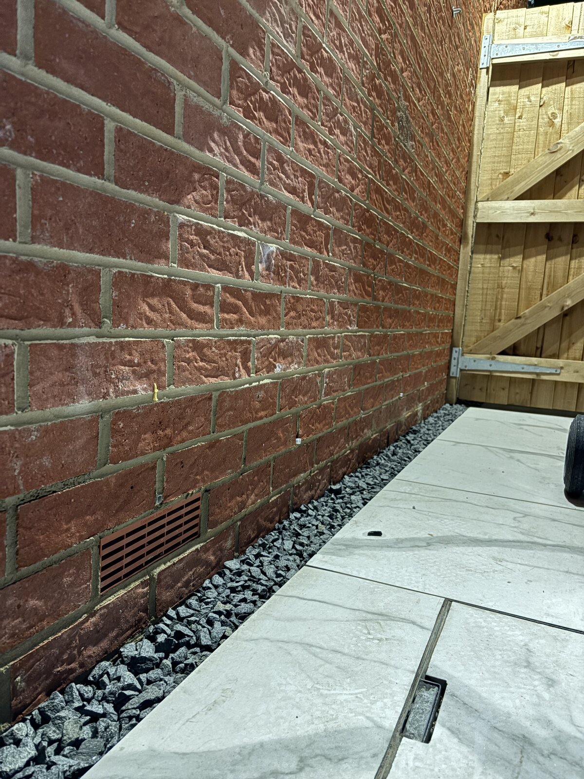

Show us a phot of the gravel, especially where its height is relative to the DPC.
Also check all those slabs with a long-ish spirit level to check that they're tipping away from the house rather than towards or just level.

That’s just now. Not sure if anything stands out…..
I did go out yesterday when it was chucking it down and couldn’t see any water pooling near the house, I even did the stones back a bit to see if it not visible to eye but couldn’t spot anything.

That DPC on the inside - which course is it on the outside?
You'll need to open the garage door and follow the mortar line round the corner.
