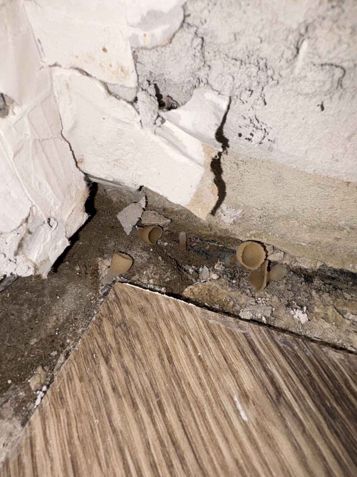

Just back from a week away and checked to see if it had dried out any further. Seems not…… we have some little friends appear.
OP,
On my screen the "little friends" seem to be stalk and cup mushrooms - is there a mushroom smell?
Various mushrooms are involved with decaying timber including Dry Rot conditions.
However afaik, nine months is a short time for Dry Rot to flourish?
If you carefully removed the loose debris from the open flooring "channels" then more could be perhaps seen of the DPM &/or DPC?

9 months would be a short time but those mushrooms were not present a week ago before we went away. I do believe we’ve had plenty of rain days so maybe this accelerated the growth.
I’ll let the house builder know and they can do the investigating rather than myself.

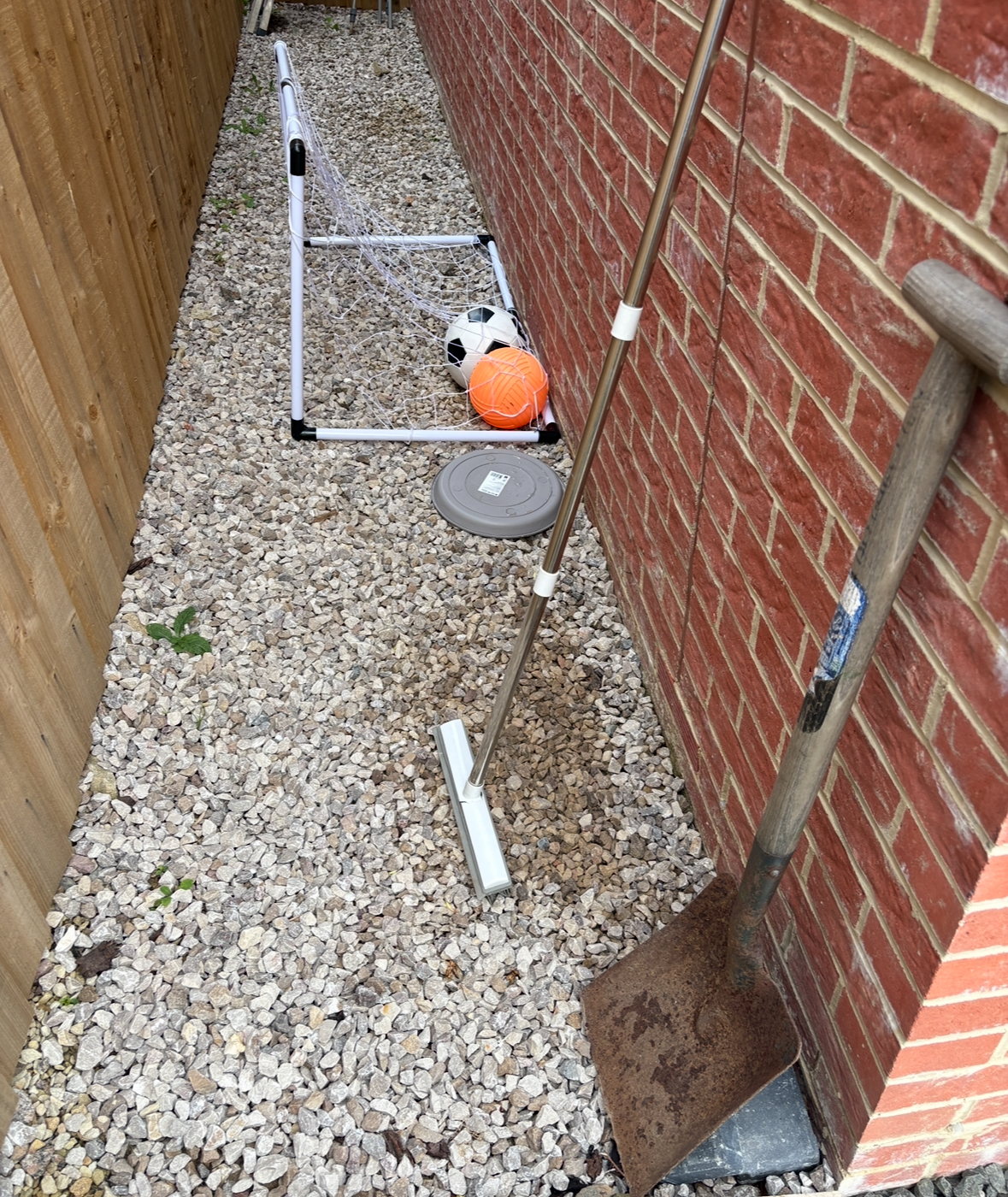

Also just checked outside and it’s either a coincidence or something of nothing but there’s clearly a distinct difference between dry and wet stones here oddly enough.

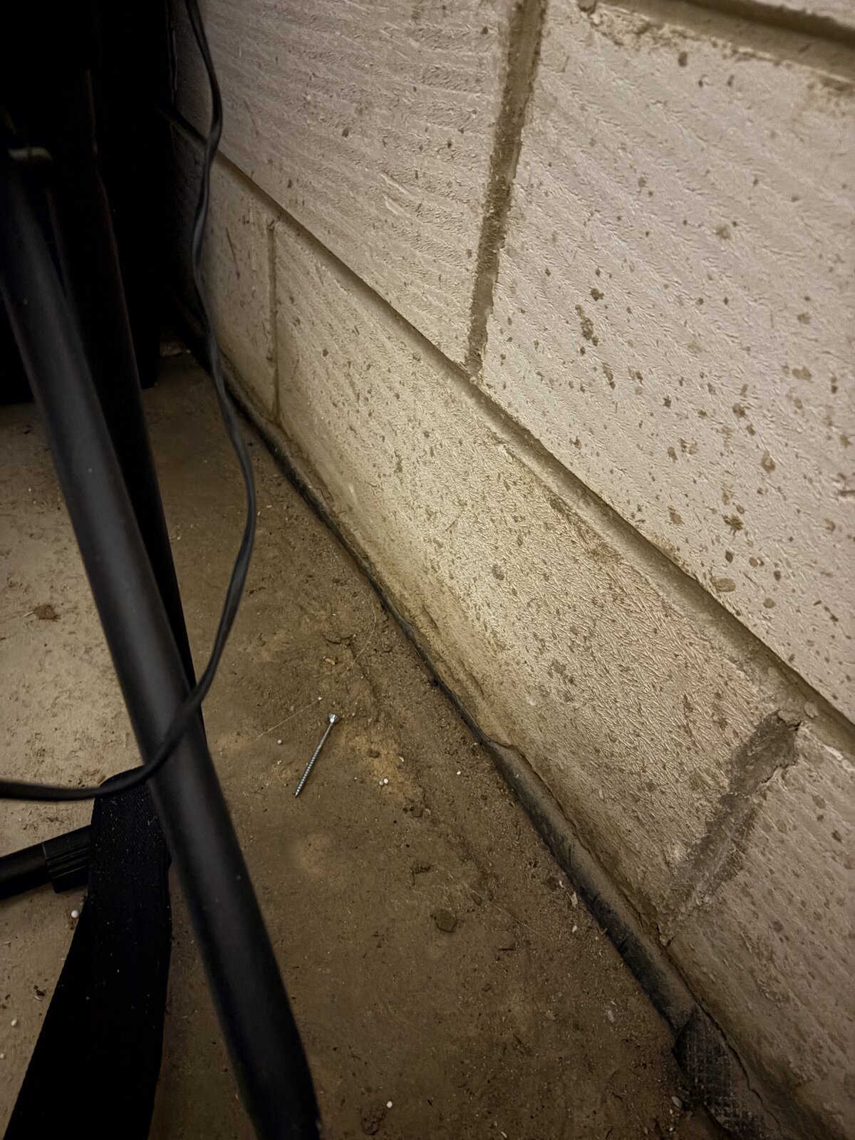

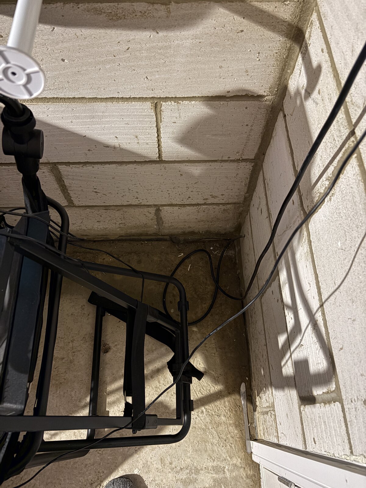

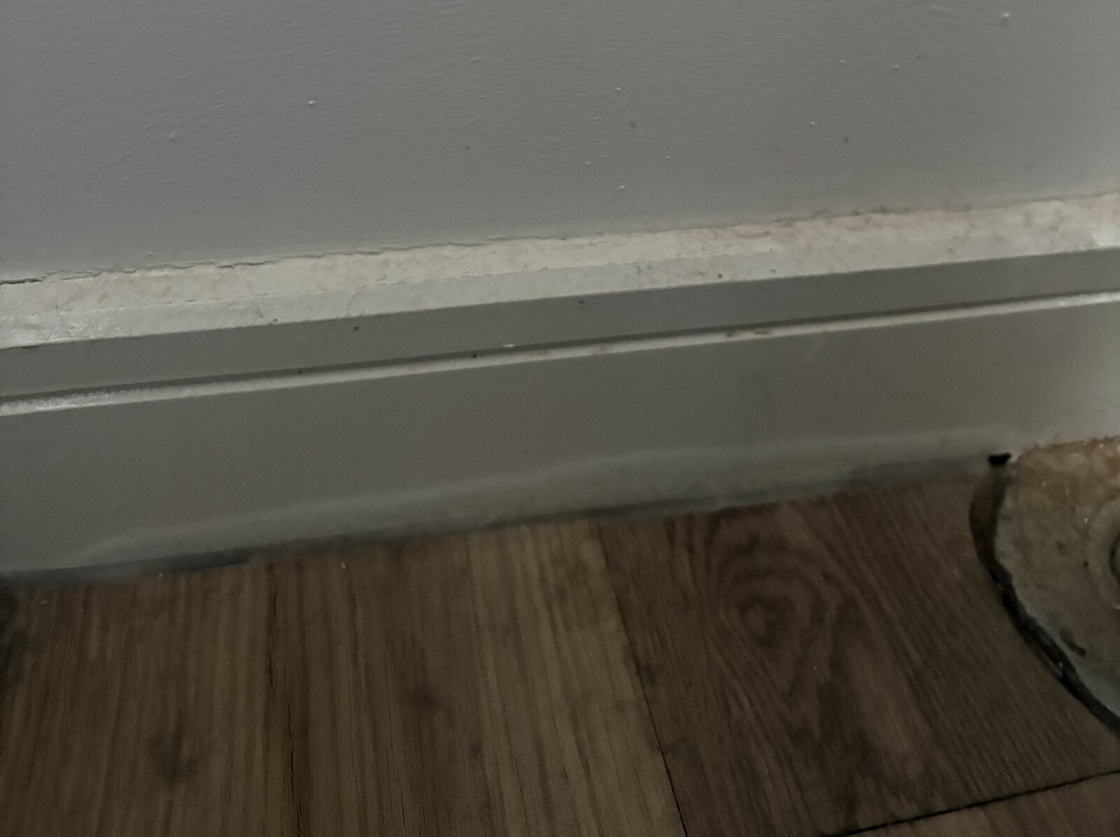

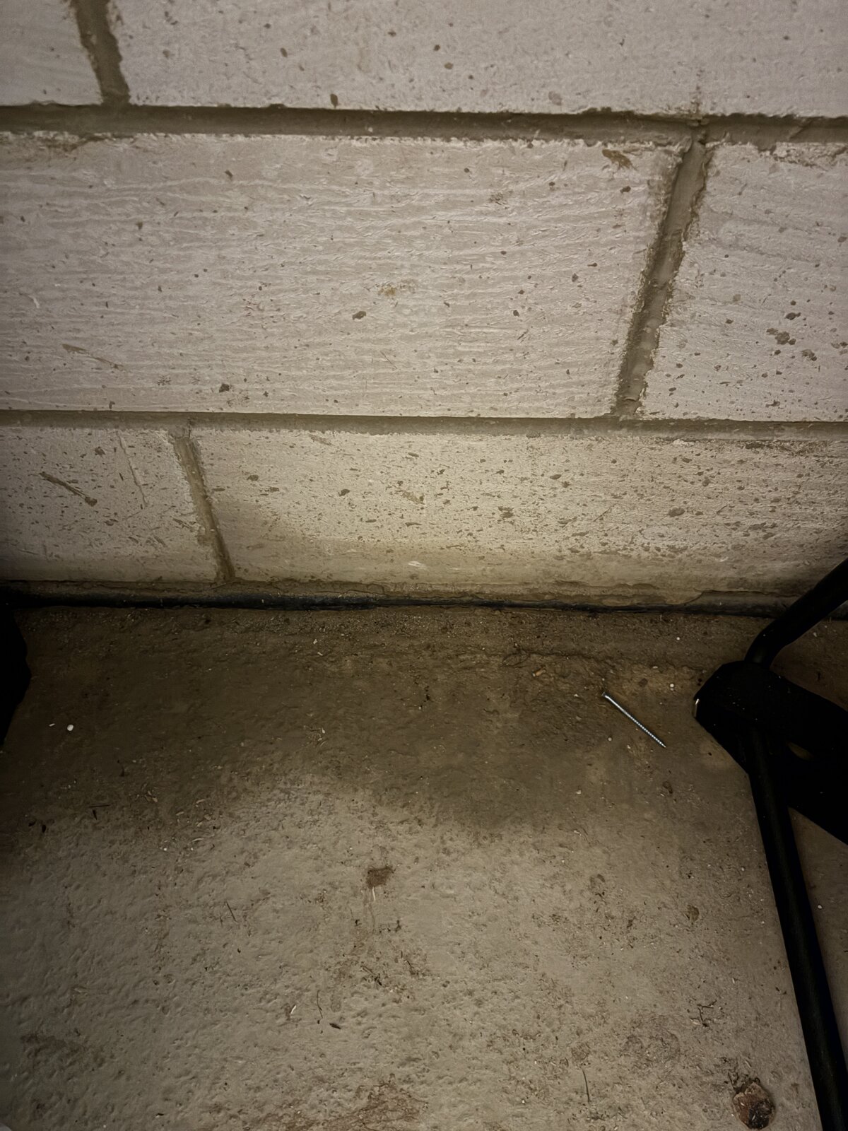

Still waiting for these clowns to sort this out but at the same time, I’ve also noticed the opposite side of the house, particularly in the garage has a damp floor down one side and also some skirting in the downstairs wc.

Damp in a garage is fairly normal, as the floor is lower than the DPC, as it has to be so that potential fuel/oil spills from a car don't trickle into the adjoining house. Sadly this just how it is.
Any reason why it wasnt there last winter and has suddenly started appearing now? Do you think the skirting is showing an issue? It's all along the same wall.
It'll be the water table rising, the accumulation of lots of recent rain. Many rivers are very high at the moment.
Fair enough, makes sense re the garage theory but I’m not convinced the skirting in the bathroom should be like that so will get that checked
Habitable rooms should be bone dry unless the waves are lapping up the walls above the DPC.
Even driving rain saturating the brickwork shouldn't cross the cavity.
