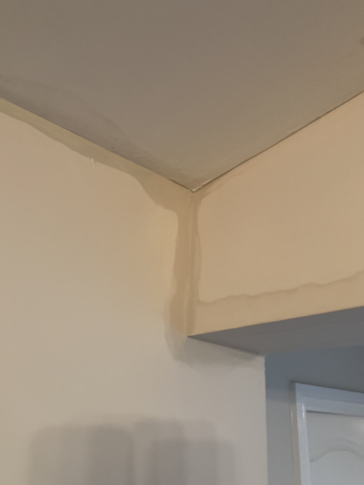

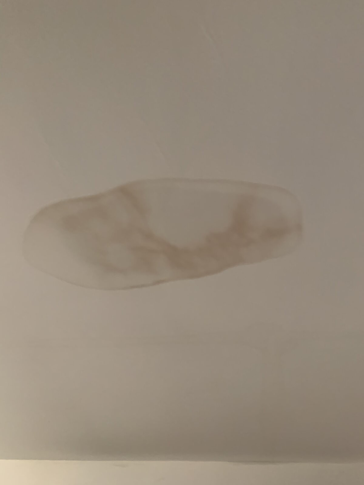

Hi All
I have had a water leak now solved, but the water stains its going to leave are going to need fixing. My father in law used a product before called Stain Stop but it went on quite thick and tbh it looked bad when he put emulsion over it. I have seen a product called Zinsser BIN
can I roller this on lightly ? will it need 1 coat or 2
How long to dry ? , it was the waste from the shower that had come off so water from a shower went down the hole between the floorboards and the plasterboards
tbh I busy until next week will it be dry by then ?
thanks
Zinsser bin is the product to use. A few coats of that, a few hours drying time between coats is needed, and then a few coats of emulsion will sort it
Not a good idea to apply oil-based gloss then emulsion on top. Too shiny.
Oil-based undercoat may do, sometimes you can see patches grinning through the emulsion when completed, but this often disappears in a week or two.
I too would recommend BIN or Blockaide by Smith and Rodgers. Both are pigmented shellac based paints.
I would allow at least 30 minutes between each coat of BIN, a total of two coats, And then and hour or two before applying two coats of emulsion.
You can either use a throw away brush with the BIN or use a decent brush and clean it with household ammonia.
Thanks, I have bought a tin of Zinsser BIN and will use that next week when its fully dry. Will let you know how it turns out.
To assist drying, suggest if you have one or can "borrow" one get a fan to blow air over the damp areas, no need for heat just air movement.
