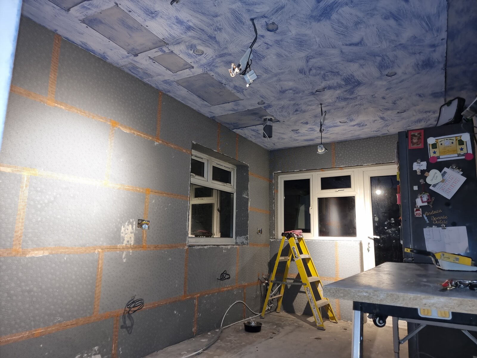

Done just that... in doing my Kitchen I have insulated 2 externals walls in my kitchen and 1 in my living room.
Also in doing my Kitchen I have replaced all the 15mm hot feeds to taps with 10mm feeds and insulated them from a manifold.
Next year I'll insulate the spare room and hopefully fit triple glazing.
