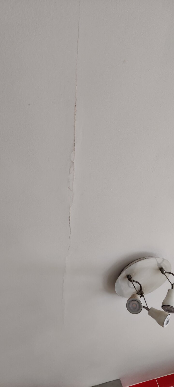

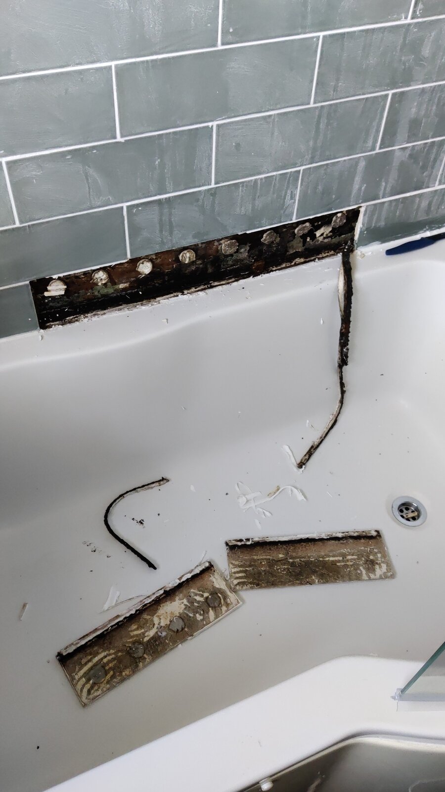

I have taken away what I assumed was a good tiling job to get to the root of the leak only to find the attached photo - incredibly damp and funky. I'm concerned as to how long this leak has been going on and have also attached a photo of the kitchen ceiling. Should I take the panel of the bath off to get in there and see if the actual floor boards joists are rotting? Should I have the kitchen electrics turned off? Should there be a damp course behind my shower tiles? So many questions.... So little knowledge! :'( Do I need a tiler? Plumber? Carpenter?

You need to remove the bath panel, run water and check where the leak is.
Once you know this, you can deal with it.
It might be failed silicone on the bath edge, but as you've discovered how the tiles are attached, you better take at least 2 lines off and reattach them properly.
A tiler will do this in half a day if everything goes well.
You could carefully remove the tiles yourself and clean them so to make their job easier.
For the leak, you'll need a plumber, unless it's from the bath edge, in which case the tiler will sort it.

First I'm a bit puzzled by the photo - it looks like there's evidence of a combed pattern of tile adhesive on the backs of the tiles but at the same time they look like they've been dot and dabbed. Perhaps they were originally fixed with a combed bed of adhesive, but fell off (perhaps wrong adhesive used) then re attached with little dabs?
Whatever the case, with the amount of mould behind there, it's been leaking for a while. Presumably this isn't the first time you've used the shower in 3 weeks? Is it the only shower? Was there any sign of water damage on the kitchen ceiling previously?
Anyway, really they all need pulling off before they fall on you in the shower. The substrate behind needs sorting too before it could be retiled. Is the tiled wall a solid external wall or internal (plasterboard)? Since you've just bought your first house I guess cash is probably tight so perhaps you could effect an economical remedy with some shower panels well sealed to the bath rather than retile.

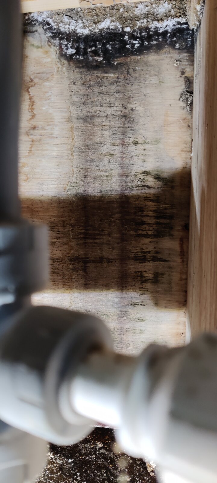

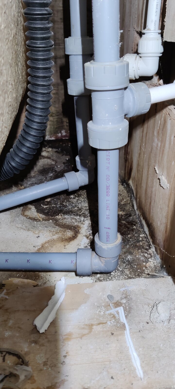

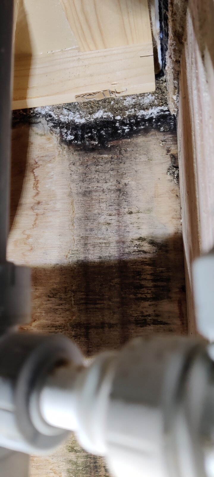

Definitely pull off the bath panel and have a good look under there to trace the leak. Hopefully just some localised floorboard damage and no joist damage (having had similar situation and had to repair it in my own house). This tilework and failed sealant look like the smoking gun for the water leak and would suggest that a plumber is not required although many tilers do a bit of plumbing and vice versa.

Ok so I've removed the bath panel and found the attached photos I can push my finger through the plaster board on the floor, there appears to be a black liner behind one wall which appear dry and we'll... The leaking wall has no black liner and historical leaking. I'm going to remove the bottom two rows of tiles as you've advised. Looks like I'm taking the afternoon off work! I'm just gutted and trying to find a good plumber in Belfast is like hen's teeth!

It's definitely just chipboard behind the tiles as it's an internal wall, like a partition wall between it and the bedroom. The blobs just fell off the chipboard and are bouncy like silicon and not actual cement based adhesive. You would think I knew what I was talking about there for a second but I'm a 30 year old, female computer programmer with zero knowledge of DIY!
