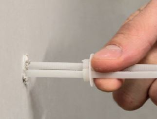

Yes I have used these too and like them but the annoying thing about them is that after fitting it is raised off the plasterboard about the thickness of a washer so if you were fixing a block of wood for example it is only (sort of ) held on the face of the plasterboard at the washer area.
So when I can I use a forstner bit to cut away that washer thickness from the back of the wood so that the whole surface is in contact with the plasterboard.
Or if the fixture is metal then I use the forstner to remove a washer thickness of plaster. I know you shouldn’t break the paper but think the outcome of the whole surface being in contact with the rest of the plasterboard is ultimately stronger.
The section the fingers are touching is the bit I am talking about. It doesn’t look much here but does stick out.

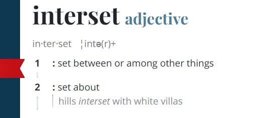

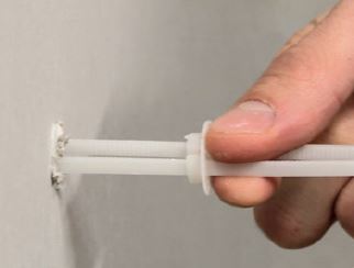

Maybe they might ask what it is and/or how the name originated.
