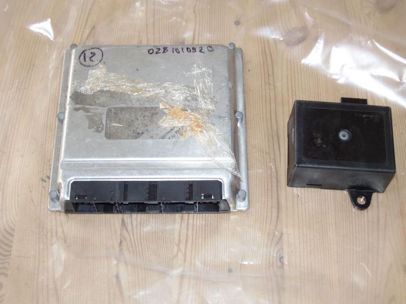

The pin inside the key can be removed and put into a new key that has been cut. They are interchangable on Mercs and lots of other vehicles.
When they stole the van, they will have bypassed the immobiliser first, and then used the key they have.
So either they had an original key in their possesion at some time (garage-dealer-towbar-roofrack fitter) of which they stole the transponder to put in another key or
They bypassed the immobiliser to use a key without a transponder (Is that possible?) If so why do we even have immobilisers?
Or if the Mercedes has a fixed code key rather than a rolling code key they read the code using a device and then programmed a newly cut key with that code.
doesn't the Mercedes have a rolling code set up?
If it does then according to the key cutting websites it needs the vehicle to programme the key.
