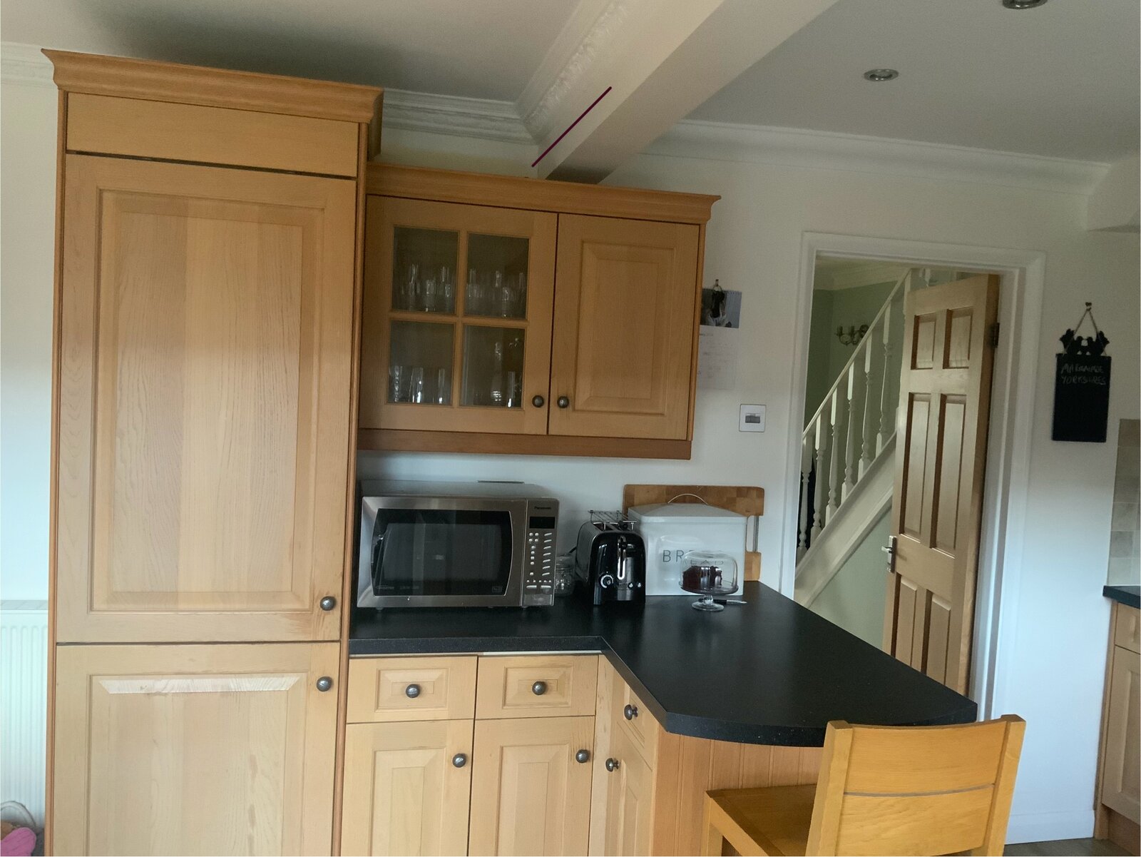

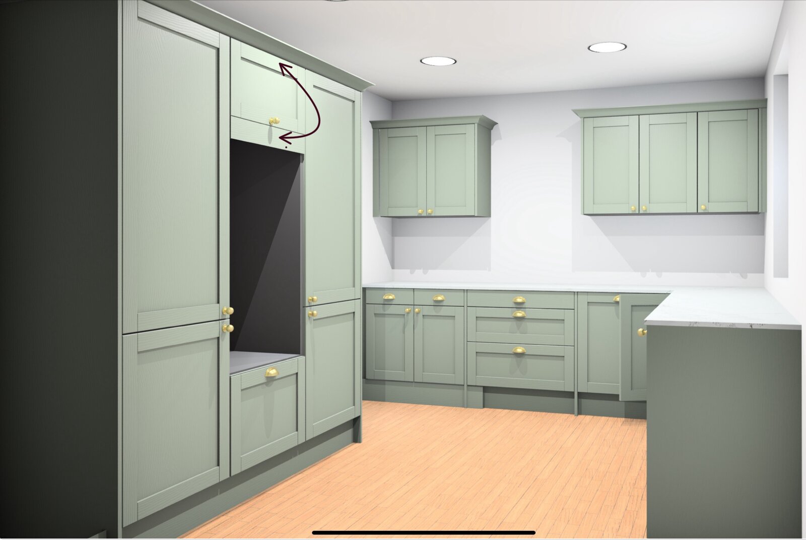

Anyone see a way around this problem? I want to replace the existing with the new but the new units are too tall and will foul on the RSJ. I could swap the door and panel around as per the picture and cut out the panel to go round the RSJ. I’d then have to have the top trim end and start at the RSJ and look as if it’s going through it but honestly, will that look shìt? Any suggestions? The units are 2118mm tall excluding the top trim and I only have 2100 from the floor to the bottom of the joist. Only other suggestion is look at other makes of kitchen to see if they are slightly shorter but Mrs Mottie is set on this Magnet one.

Suggestion to swap door and panel to allow panel to be cut around RSJ)
Units 2118mm including the legs?
Couldn’t you just fit smaller legs or a couple of blocks of wood underneath instead to reduce the units on that side by 20mm?
Just done my kitchen and B and q have two height options - ikea have and wicks and they are all different heights between them
How thick is the floor covering? You've measured from FFL to beam? If the floor covering is thick enough the units will be lower if they're not sat on FFC
Can you add a narrow unit underneath the RSJ -a spice cabinet and cut it down to fit under the rsj

Seconded, reduce the plinth height. Also those large cornices are a little old hat now, small oblong trim looks more contemporary.
