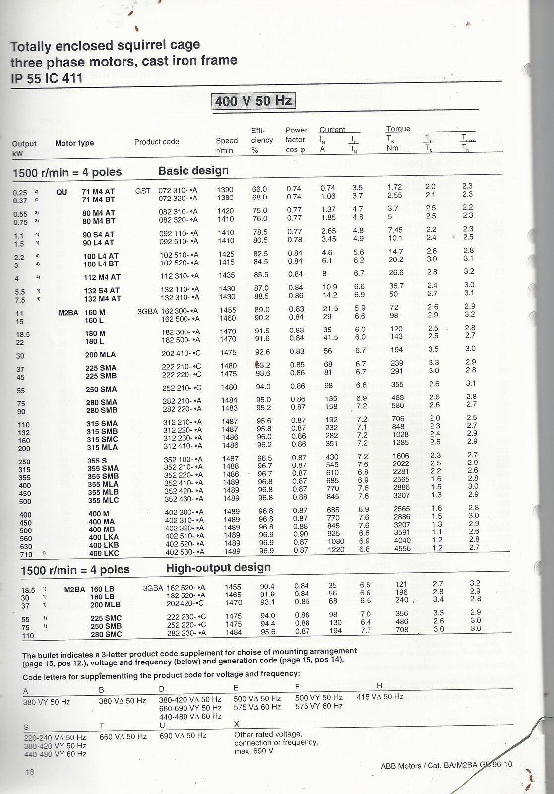

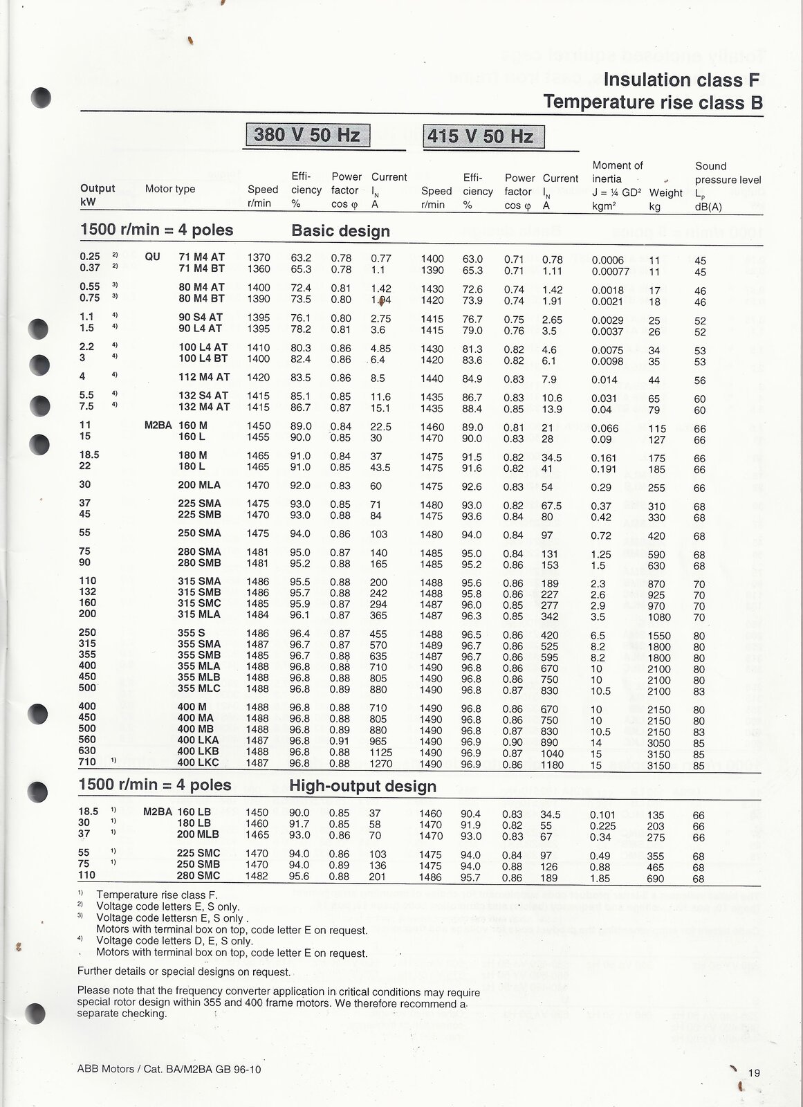

It's not just my idea, it's published in motor catalogues. I'll try to scan a couple of sheets and post them.
Are you really suggesting that the power produced by a motor is independent of the voltage it is supplied with, and that if one increases the voltage of the supply, the current drawn from that supply will fall?
Yes, within the design voltage range, and probably some way outside it in practice. I've tried to explain several times. The motor manufacturer is testing his machine. He supplies it at say 400v and adjusts the load (a dynanometer say) to rated power. He then increases the voltage to 415v. The speed increases (see #27) and so does the load. So he readjusts the load back to the rated power, and hey presto the current is then lower than before, in accordance with I*V = W. That of course is input power whereas rated power is shaft output power, but eff and PF won't change enough to alter things.
Data sheets attached, as photo and pdf. Information might be on the internet these days
