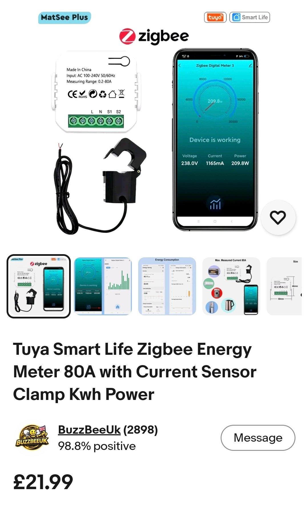

Anything I can use to monitor Viktsge current and frequency using clamps that can record the data for a week or so that is under £100?

Yes, assuming you have a laptop. Buy a cheap USB analogue to digital converter. (AKA “USB Oscilloscope”.) Less than £50 on eBay and probably even less on AliExpress. Connect one channel to a current transformer (with a shunt resistor I guess??), and the other to measure the voltage a suitable normal (voltage) transformer.
Then I guess the challenge is whether the supplied software will record for very long periods.

okay this gives me some ideas I can look into
20 quid?

didnt see frequency on this device, I know spikes and frequency changes can cause PSU's some issues.
