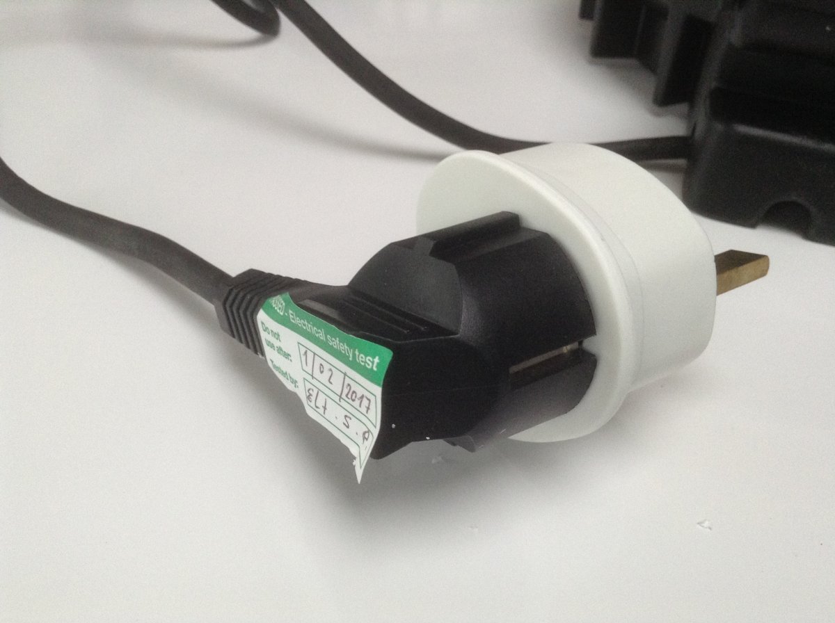

The missis came home from the charity shop today with what appeared to be an unused tortilla maker still in its box. Like all electrics for sale in charity shops it had been safety tested, but what's this? A schuko plug plugged into an adapter with no earth connection to the side contact. Just to rub it in the test label was on the schuko plug.
How the tester manages to pass the earth continuity only he knows.

Presumably the schuko passed the test and the adaptor was put on afterwards.
I've never seen a PAT machine with a schuko socket. Anyway items sold in the UK have to have a BS1363 plug fitted or else a non removable suitable adapter. The only exceptions are shavers, toothbrushes etc which can have a 2 pin plug and are double insulated.

It's possible it's not, but with molded European cordsets if there is no earth required the manufacturers tend to use a 2-conductor cord with 2-pin plug, not the Schuko style.
The standard adaptor
would have been OK and it is possible some one in the shop wanted the adaptor themselves so had swapped it.
Can't really blame the tester is some one alters it after testing.
Also I see nothing in the inspection and testing of in service electrical equipment which covers equipment not in service. If I test a piece of equipment which is going to be connected to a cooker outlet or similar I would not fail it because it has no plug. When testing a PC which you know is used to program PLC's in German made equipment which have Schuko sockets inside the panel there for the PC while programming one would not swap the plug for testing, one would simply use an adaptor which most testers carry around with them to do the testing.

So there is nothing to stop a German item being tested without a British plug. There is however a rule about selling items in retail outlets without a British plug. So the item you show could be tested without the adaptor then some one has added the adaptor to make it legal to sell it.
I will agree the wrong adaptor was used, and as such the shop should be made aware of their error. But there is nothing which is shown in the picture which would show the person doing the testing made an error.

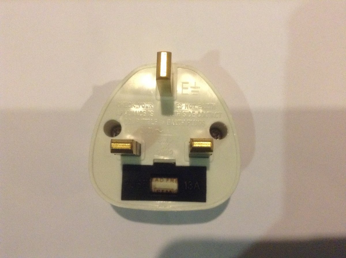

Here is an underside photo of the actual adapter. It has a fuse but also says "Does not earth with side contact earth plugs".
Also I believe the requirement for equipment sold with foreign plugs and an adapter is that the adapter cannot be removable without the use of a tool such as a screwdriver.
