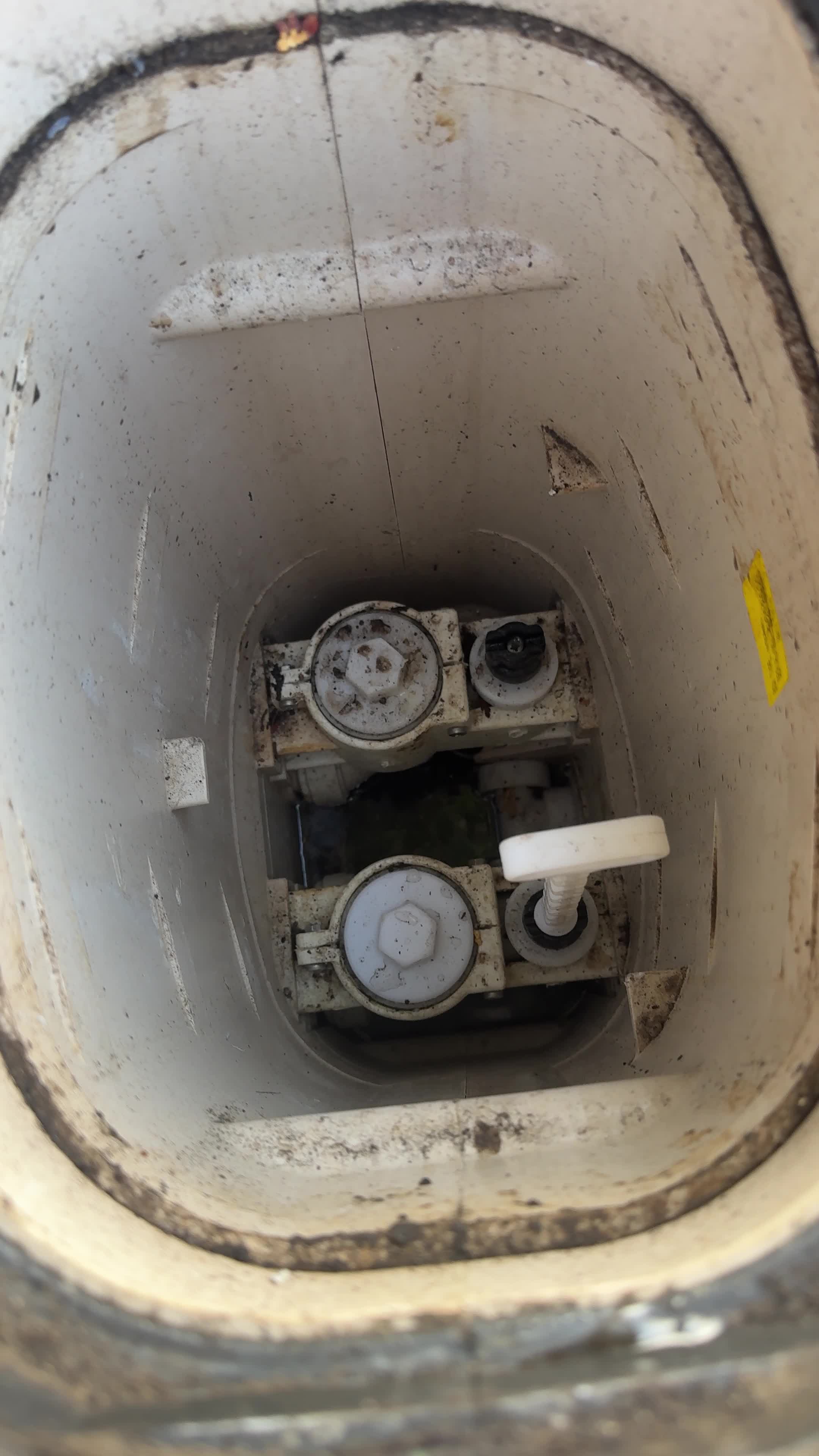

I spoke too early! Flushed the chain this morning and got the noise. I had to go out and check that they hadn’t fitted another faulty meter.Sorted. Well, almost. Engineer came out, tested water pressure (4 bar) and witnessed the noise. He took the meter out, gave it a shake and said they shouldn’t rattle like that. He didn’t have a new meter onboard so he fitted a flow cap so we’ve got free water until another meter can be fitted. He took a photo of the reading and asked me to do the same in case there’s any dispute about usage later on. He said I could fill up my swimming pool and everyone else’s but I mustn’t use a hose.

I can get the noise to start by turning any tap off quickly. I’ve only heard it start in the mornings - perhaps water pressure is higher in the area then as not everyone is up and using water?The noise you describe can be the orifice of a toilet ballvalve.
The older style ball valves.
Can you show what ones you have.
Other than that it could be your main stopcock (Naughty word)
Or ball cock in the loft
Ive found that the a particular tap that starts the noise can just be a trigger.I can get the noise to start by turning any tap off quickly. I’ve only heard it start in the mornings - perhaps water pressure is higher in the area then as not everyone is up and using water?
When I did the kitchen up last year, I fitted a new lever style stopcock however, the kitchen will need partially removing to get at it so I’m hoping is not that. No ball cock in the loft as we had all that removed when we had our hot water converted to unvented.

Before the meter was removed, yesterday I had to literally go outside to check that someone was not using a hammer drill to drill a hole in the side of my house, it was that loud! With the meter removed, it just sounds like Mrs Mottie is using a hoover upstairs. It’s a hundred times worse when you listen to the stop cock in the street though.Ive found that the a particular tap that starts the noise can just be a trigger.
It can be various taps or flushing of chains
Why ?Inside the house
take a picture of your stopcock and toilet ballvalves
