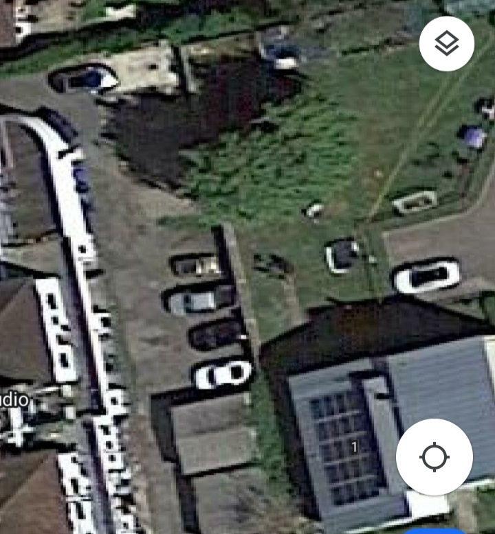

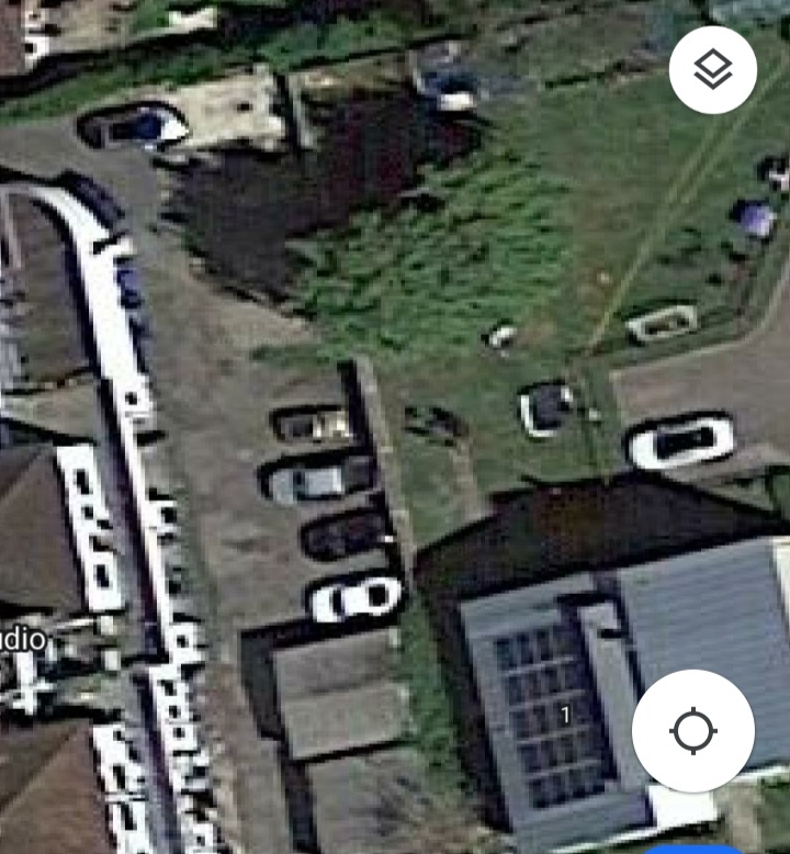

Hi - thanks both for your comments. I will try the BI with the specification again. On the other side of the fence is a large garden, and a large willow close to the fence. The grounds are part of a modern block of flats development; I can't see it ever being developed closer to the fence. See plan attached
The image on Google maps may not be recent, but do you own the rest of the land in the car park?
The boundary rule would equally apply if someone was to build a garage right next to yours...
Interesting image - the dug up bit is where my building is now on the west side of what would be and is the fence. The rest of the car park to the south is not mine.
Separate story but on piling we went through a high pressure hose that Thames Water had said didn't exist. Took a long time to convince them they should still give me a buildover agreement.
No. I do not own the rest of the car park - but thank you for your comment. The site is in a conservation area and I suspect further consents will not be easily obtained.
