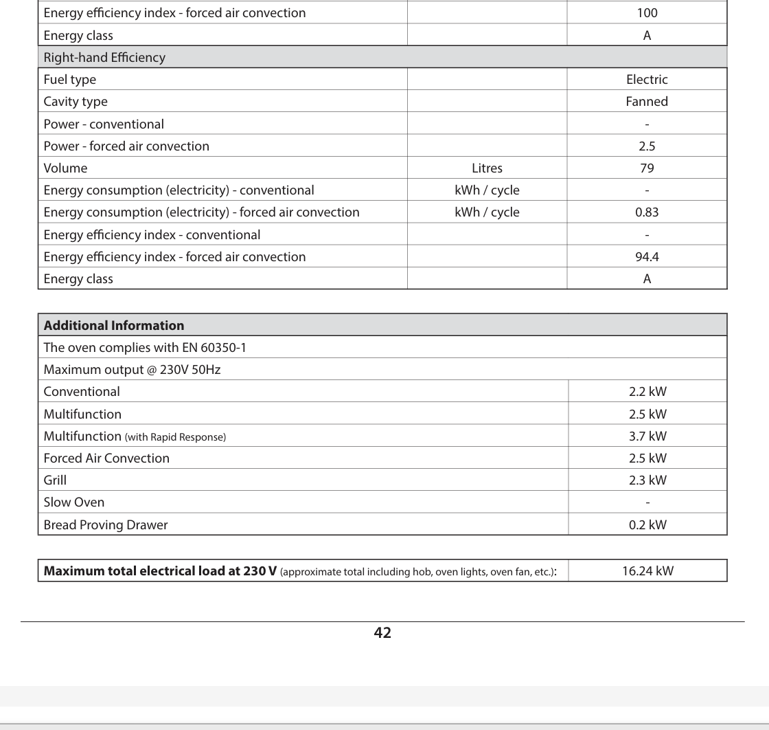

The manual for the cooker
@Macmhuirich is yours dual fuel or all electric ??
The spec for dual fuel says - as below - 7.4kW. You don’t need 10mm for that.
But the spec at the end of that document says 16.24kW!
Yes, not that they will all be on together.
As Rodders worked out in post 25:
Which by my sums would be nearly 71 Amps - but allowing for diversity is 10A + 0.3 x 61 A = 10+18.3 = 28.3 A... so within a B32 MCB rating. Unless the cooker is fed from a switch with a13A socket; in which case the + 5A extra tips it over.
