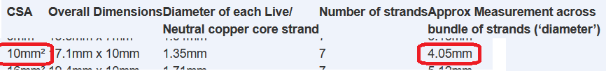

Thanks for all your replies I very much appreciate it . I’m fitting a new range master range cooker which the book states must be wired with 10mm2 cable max . I measured mains wire and it’s like 4mm and on a 32A RCD at consumer unit . I would imagine you can’t use a 10mm cable to a 4mm one and the lad that delivered it says it has to be on a 45A RCD at consumer unit with the 10mm . Thanks again

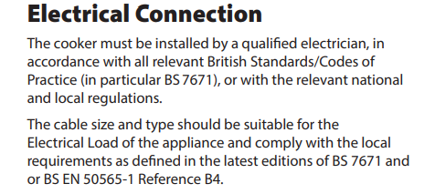

The 10 sq mm is merely the biggest that the terminals accept... removing the link supplied reduces the capacity to 6 sq mm for a 3-phase 400V installation (weirdly the manual says the same earth terminal capacity reduces to 6 sw mm, too!).
From Page 42:
Maximum total electrical load at 230 V (approximate total including hob, oven lights, oven fan, etc.): 16.24 kW
Which by my sums would be nearly 71 Amps - but allowing for diversity is 10A + 0.3 x 61 A = 10+18.3 = 28.3 A... so within a B32 MCB rating. Unless the cooker is fed from a switch with a13A socket; in which case the + 5A extra tips it over.
I'll leave it to the experts to state what cable sq mm is required / desirable (as it will depend on install cable length and method).
The wire from the consumer unit to cooker switch going with the vernier I used is 4mm that’s the actual wire not the covering . Thanks for the replies I very much appreciate it
