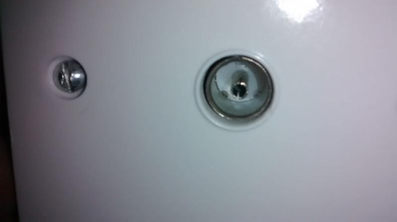

Hi,
I am replacing my sockets in the house and am using MK Logic Plus but I'm a little confused which socket I need. It is just a tv socket (not satellite) although I do have a link system where satellite tv is piped round the house via a box in the loft.
I think it is one of these 3?
MK K3551WHI MK Logic Single TV Socket (Female)
MK K3520WHI MK Logic Single Non Isolated TV - FM Socket (Male)
MK K3521WHI MK Logic Single Isolated TV Socket (Male)
Many thanks.

Many thanks for all the replies and help. Does this mean I can't use a matching MK Logic Plus socket? Although the first reply seemed to suggest the first option would be ok?
It may be - or it can be made to be.
As Eric has said, it depends.
You could use female sockets (as you pictured) if you have male plugs on the cable or
vice versa, it doesn't matter.
So, use whatever socket you want to match and change the cable plug.
Beware though, as I have seen adverts where the description is for what you want but the picture is not.
Just in case anyone is reading this in the future, I have contacted MK and they have advised me I need K3551WHI (which is screened)
