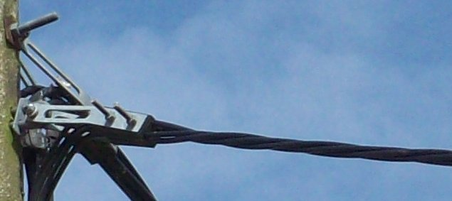

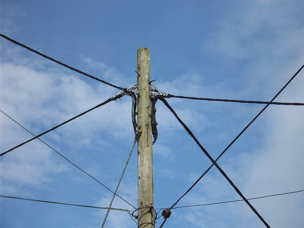

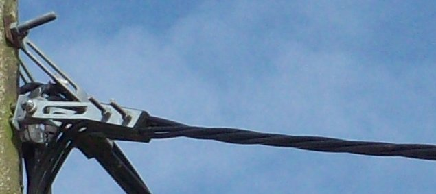

Overhead supplies carry the risk of a conductor snapping in strong winds ( or if a vehicle impacts a pole ) If the Neutral snaps but the Live doesn't then a then PME ( TN-C-S ) "Earth" would not be at Ground potential. Quite hazardous. Hence the reaon why in the past PME "earths" were uncommon when the local supply network was overhead cables
We know that the (very rare) occurrence of a broken/'lost' neutral in a TN-C-S LV supply network can result in certain hazards, and that is equally true whether the supply is underground or overhead.
However, I'm not so sure that that (very rare) occurrence is necessarily more common with overhead supplies than with underground ones, since they often (always? - my experience is limited) do not use 'singles' (i.e. with L and N being separate cables). For example, the overhead supply to my house (and all others in my locality which have overhead supplies) uses 'ABC' ("aerial bundled cable") cable - in which the conductors are twisted (or otherwise joined) together. With such a cable it would be incredibly unlikely that the neutral could be 'snapped' without the same happening to the line/phase conductor(s). These photos are of the final part of the supply to my house (and other houses) - the upper four (thicker) cables being ABC, the lower thinner ones being telephone cables (and one guy wire!) ...
[see next post for the first photo which should be here]
.... and ABC cable in close up ...
Kind Regards, John
The information given to me in 1980 by the then supply company ( DNO ? ) was that failed Neutrals in 4 wire overheads was frequent enough to make PME undesirable in such cases. This was odd as they offered a PME system from the 4 wire in the street.
I recall seeing 4 wire overheads with one conductor iced up while the other three were clear, I assume the Phases were carrying current and thus warmed while the Neutral had little if any current and thus no warming,
Similar information from the DNO in 2011 when arranging the supply to this cottage from the UG cable in the street,
ABC cable ( 4 wires spiraled in a bunch ) is far "safer" thn open 4 wire systems.
