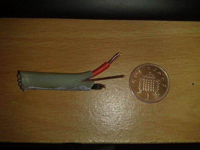

What's wrong with this picture?
No sleeving on CPC?
L+N conductors exposed?
Not connected to anything?
Penny not bonded?
Second hand cable used, or not actually re-wired in 1998 as first thought?
A chocolate medal to that man!!!
When I bought the place I was told it had had a "full" rewire in 1998, so I was a bit surprised to find imperial-sized T&E cable... When did they stop making it? :eek:
The funny thing is, they didn't even bury it - all the drops are just wallpaper-over-cable :LOL:
Hibbo - you'll be pleased to know that I have replaced the penny with a plastic alternative, so no bonding required. ;)
That cable looks like 3/029 to me, however it may be newer, as I think that back in the imperial days, they did not make imperial lighting circuit cables with earths in them, Imperial cable stopped being made around 1970. (Perhaps someone could correct me if I am wrong). :LOL: :LOL: :LOL:

Well, this stuff is about the same size as 1.5mm and each conductor has 3 strands... From looking around on the net it appears to be 3/0.036".
TBH, I can't get too annoyed about it as I'm ripping it all out anyway... not worth getting myself worked up over! :D I've found other areas where they've obviously asked for the cheapest possible job. Not to mention their DIY bodgery... :rolleyes:
