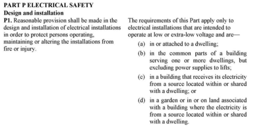

Part P of the Building Regulations -
That's all there is; there is no more.
What you are referring to is probably the notification requirements from Regulation 12.
http://www.legislation.gov.uk/uksi/2012/3119/regulation/6/made
That's all there is in England now; there is no more despite what you may read elsewhere in the innumerable pointless guides people insist on writing. You can read it and make up your mind as well as anyone else.

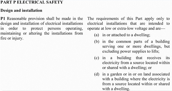

This is Part P:
http://www.legislation.gov.uk/uksi/2010/2214/contents/made
Hard to see what anybody could bicker about.
Outside work (dom) new lights (for a pathway at the side of a house). If the worker employed (or not) completed work to install two outside wall lights and cabling (linking the two, on brick face) and assumed to be competent, what are the requirements for scheme membership/notification/registration/part P-ness/certification etc.
This shows what work is not notifiable in England, so unless the new lights involved a new circuit (and the consensus is that an FCU does not create a new circuit wrt Building Regulations, no matter what BS 7671 says) it wasn't notifiable.
However - it is generally agreed that complying with BS7671 is by far and away the most appropriate way of ensuring compliance with P1, so whoever did the work should have issued a MEWIC.

Well, perhaps ignoring me is not such a good idea.
Plus - Scheldule 4 to which you link was superceded in 2013 by the Regulation 12 amendments linked in my post.
I really don't know what to say except that it does indicate that something has happened and you do not seem to know what you are talking about any more.
This is Part P:
It is.
However, I would suggest that if one is 'ignoring' someone in this forum, then one probably ought to desist from posting anything to a thread in which that person is participating, in order to avoid annoying duplication of material such as in this recent post.
