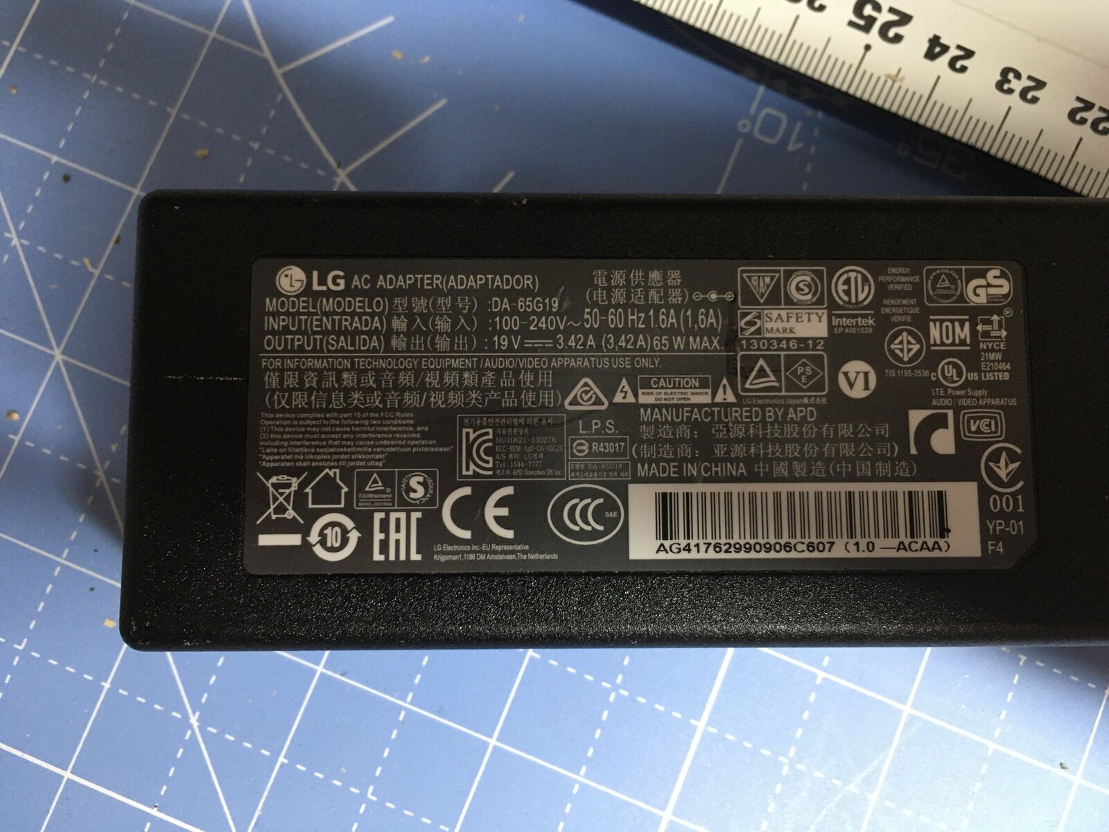

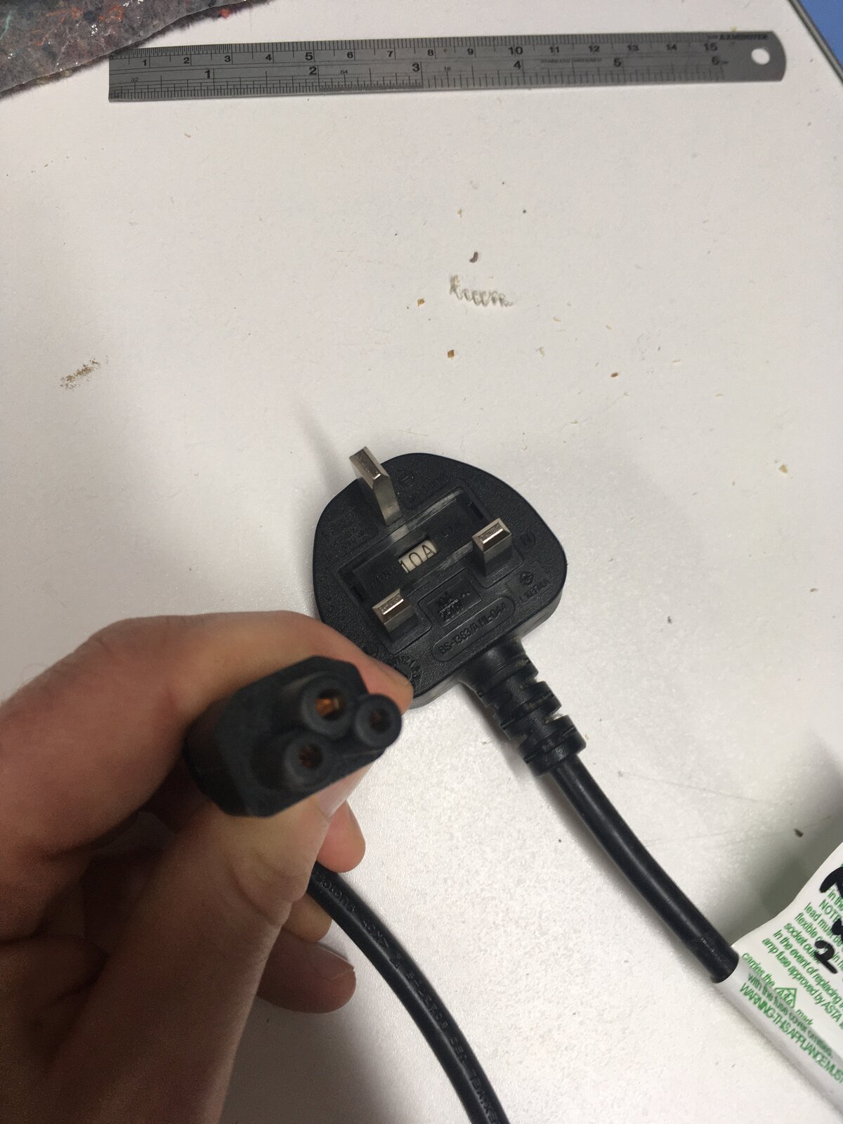

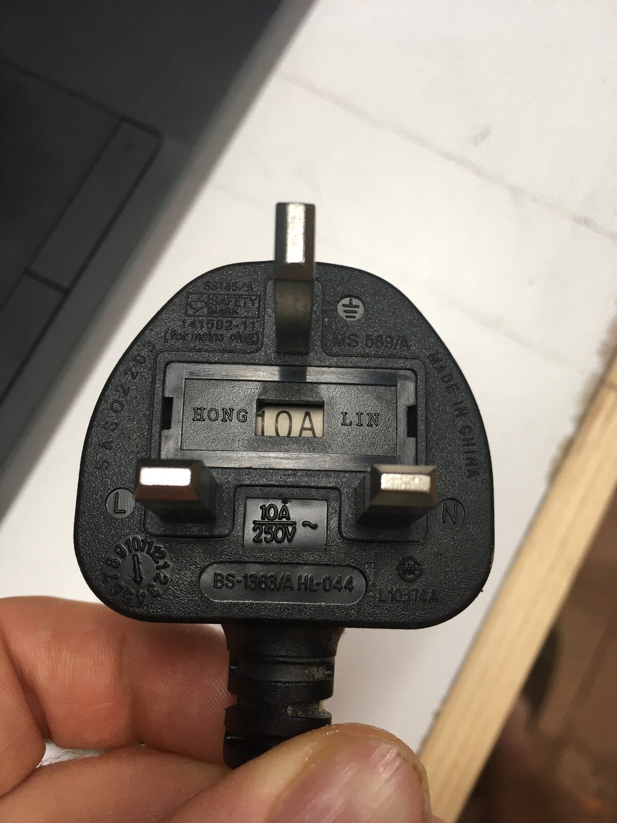

Hello,
My LG widescreen display has a power cable a bit like a laptops. Jack in back of display, to box unit, and then a clover head plug to 10amp 3 pin plug. It's too short for me. I like to buy a 2-3m version of the last bit - clover head plug to 10amp 3 pin plug.
Can anyone send me a link where I can buy one of these online?
Thanks, photos below:

One observation. The Cloverleaf C5 connector is only rated at 2.5A, so I would suggest the fuse in the plug should be no more than 3A irrespective of the size of the cable!
