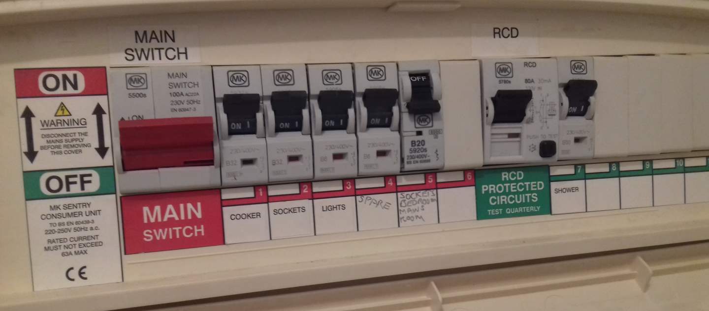

Hello I have a 1 bed rental and there are some issues with the electrics which a new consumer unit will resolve. I would like some advice please as to whether it is necessary to install one with a RCBO as my electrician seems to think - she says that RCD consumer units will trip out everything if there is a problem? The current consumer box has just one RCD and I am not aware of it ever tripping out once. Also is £600 a reasonable quote for the installation of a RCBO consumer unit? Thanks

This are the issues:
Exposed insulation where cable enters ccu
Ring circuit arcking - one of the terminals is rattling
some terminals not properly tight on buzzbar
Earth wire on electric meter not standard
The electrician is saying if the current consumer unit is updated to a RCD there may be more problems than if it was updated to a RCBO.
The attached picture shows the current fusebox.
None of those problems could only be solved by upgrading the consumer unit.
That CU is so modern you could just change those 6 MCBs for a RCBOs if you really wanted to, or with some work, another RCD could be added.
I would get advice from another electrician
Another electrician said they would also replace the CU. I am wondering if that is the least complicated.
What iggifer said - and for less than £600 ;)
It's only 5 MCBs assuming the one marked spare isn't actually connected to anything. Actually, if you were just replacing MCBs with RCBOs then you only need 4 as the shower is already RCD protected.
A lot of electricians probably only have that in their list of solutions. Brings to mind the old saying that if your only tool is a hammer then every problem looks like a nail :rolleyes: Did they both by any chance (incorrectly) tell you that you have to replace it anyway as it's plastic ?
What iggifer said - and for less than £600 ;) It's only 5 MCBs assuming the one marked spare isn't actually connected to anything. Actually, if you were just replacing MCBs with RCBOs then you only need 4 as the shower is already RCD protected.
If I were trying to minimise cost, I think I'd probably shift at least a couple of those MCBs over onto the existing RCD, and then only have one or two RCBOs to buy.
For those concerned with 'separation of circuits' ("so as not to cause inconvenience" etc.), it's really only 'being plunged into darkness' by a fault on some other circuit that is the real issue, and putting the lighting circuit on its own RCBO would largely solve that. Having two separate lighting circuits iin a 1-bed flat seems a bit OTT, but there's plenty of space in that CU to do that, and each could have their own RCBO (or, cheaper, one could go onto the RCD and the other have an RCBO).

20A socket circuit and the cooker over to the RCD and then an RCBO on the lights and the other socket circuit. Job done. About £50’s worth of materials for two RCBOs

Yes, they did. They said otherwise I would not comply with the new regulations.
